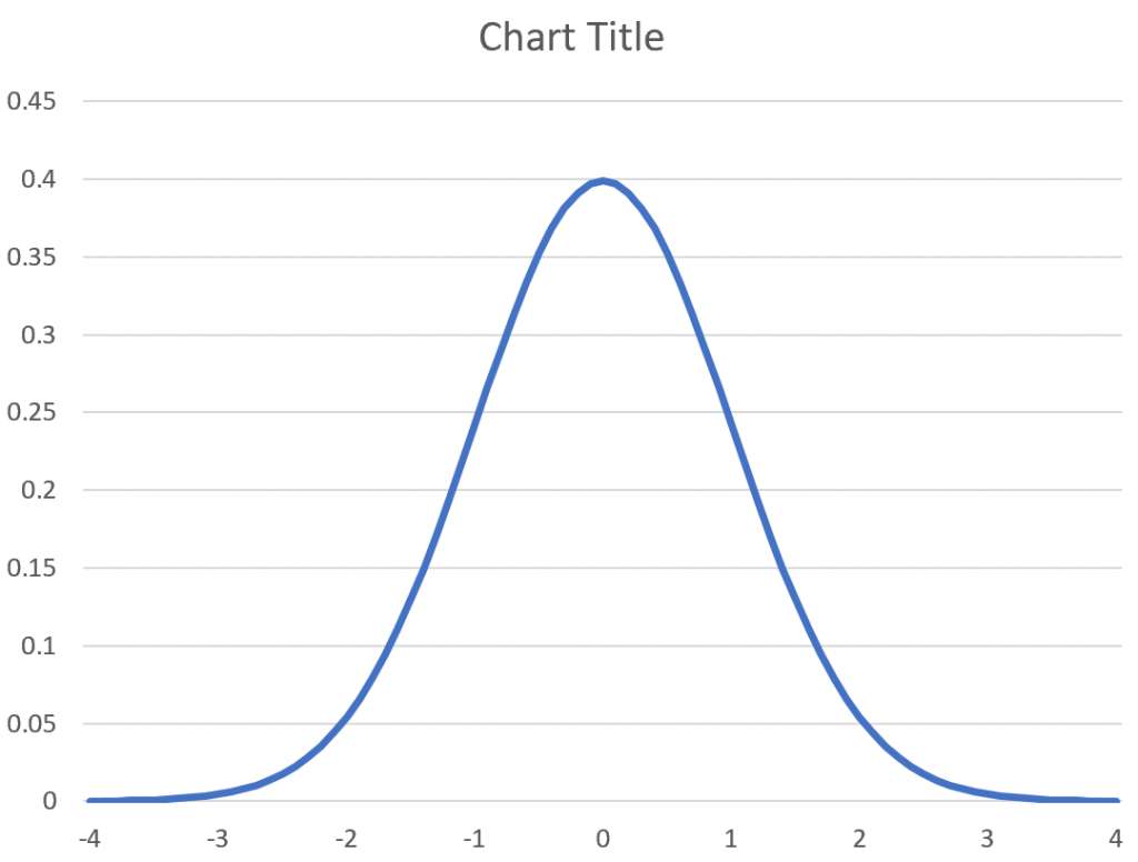

From a raw sensor of any description, one would expect a bell-curve transition. The sensor starts to see the bob at low level some time before the peak, and can still see a diminishing signal for about the same time it took the signal to peak from nothing.
This begs the question, where is the best place on the bell-curve to trigger? Not sensible to trigger when the signal is very low, down in the noise, nor is it easy to detect a peak in real-time. The usual arrangement is to trigger at some fixed point on a rising or falling slope, perhaps 33, 50 or 66% of peak. Higher settings tend to blank out noise, and give the signal time to stabilise.

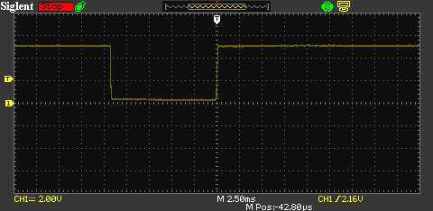

I made a mistake in my clock! Looking to use only off-the-shelf components, I selected the cheap HW201 Arduino module as a short-cut. It contains an IR LED, phototransistor, sensitivity adjust pot and a comparator to clean up the output signal, almost ready to go. However I had a lot a trouble getting it to work reliably, and have only just realised the problem still isn’t fixed because the comparator circuit is too simple. At the very least it needs an extra 10M resistor, see ‘adds hysteresis’ on the diagram:

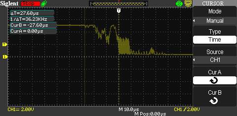

The HW201 circuit is arranged such that the output flips between 0 and 5V whenever the output of the phototransistor rises or falls below the sensitivity voltage controlled by the pot. Not good enough! As the noisy real-world phototransistor output traverses the trigger voltage, rising slowly at bob speed, about 0.1m/s, the much faster comparator flips rapidly between on/off, creating a shower of spikes over a very short period of time, only one of which gets through randomly as the trigger. My electronics are faulty. The cure is to modify the HW201 circuit by adding a 10M ohm feedback resistor between the comparator’s output and it’s + signal input. Then, the first decent spike during transition should be reinforced by the output, causing a clean flip. Oscilloscope traces show the difference, first without 10M feedback at high speed to show the zigzagging.
Next, cleaned up by 10,000,000 ohms worth of hysteresis:
My decision to misuse the HW201 without checking the circuit properly wasn’t smart, because this sort of mistake isn’t made by professional designers! John Haine recommends the Sharp GP1A57 opto-interrupter. The specification suggests this is a good choice, and buying one won’t break the bank, about £5! Typical rise time is quoted at 0.1uS, with a fall time of 0.05uS. The faster fall time suggests it might be advantageous for beam break detectors to trigger on falling edge signals. (True of other detectors: some are faster on rise, others are faster on fall.) The Sharp includes built in voltage regulation, which fixes another significant source of error, and a Schmitt trigger, but no lens. A potential gotcha is a warning in the blurb that the IR detector will lose about 50% of it’s power over 5 years, which is likely to shift the detect point. Nonetheless I spent a couple of hours on the web trying to find a better device without success. I finally bit the bullet and ordered a couple!
Have I finally cracked my clock problems? I doubt it! This is a voyage of discovery, and I think there is a lot more to say on the subject. As it’s entirely possible my summary above of detect methods is mistaken, grateful for any comments!
…this sort of mistake isn’t made by professional designers!
