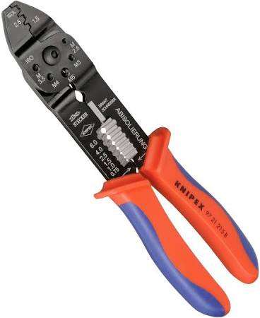

                    I use these crimping pliers which can shear a selection of small metric threads. They will shear off 6BA studding easily enough, then clean up the sheared face with a file in the lathe.

                          On Speedy Builder5 Said:
                          I use these crimping pliers which can shear a selection of small metric threads. They will shear off 6BA studding easily enough […]
                          sounds a bit risky ^^^ aren’t the shearing locations tapped for specific thread sizes ?
                          … a vintage model would hopefully include 6BA

                              I have used the crimping/cutting pliers shown by speedy on small screws in electrical work, they worked  BUT I felt a better pair could be made from silver steel or gauge plate – never got round to it ! Noel.

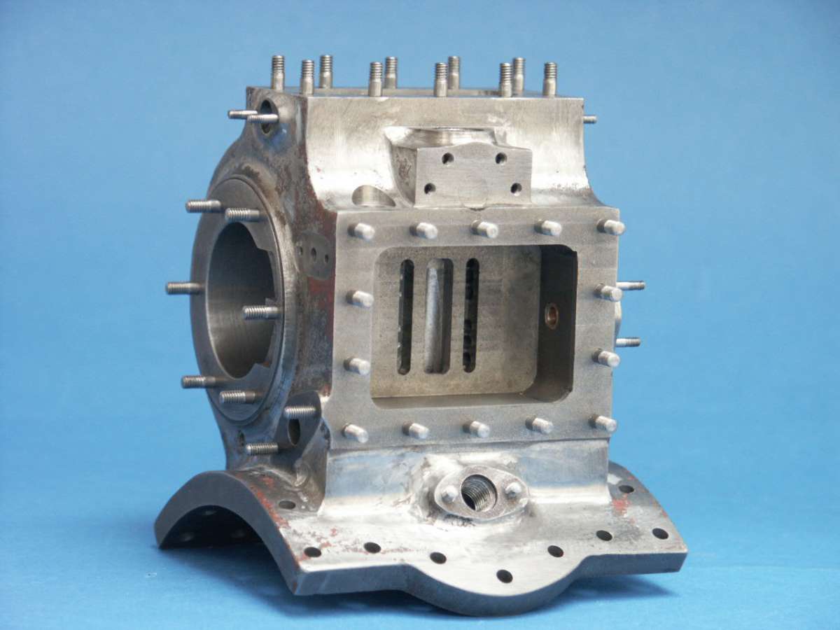

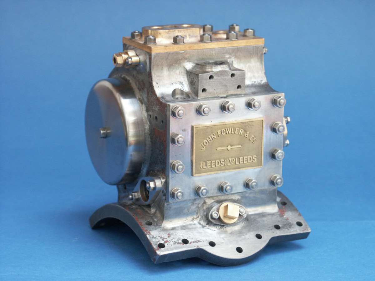

                                        As I said earlier I would usually thread my own but as the OP was intending to use studs or cut the heads off screws that is what I went with😊
                                        Well actually on such small studs that are often holding things that are no thicker than 1 x their diameter it is hardly worth leaving an unthreaded section in the middle that may only be 2mm or less long, at least that is what I tend to do. If it were say a stud for a valve chest and cover then not worth the time threading the whole length.
                                        But just for Andrew 😍
                                        PICT0055
