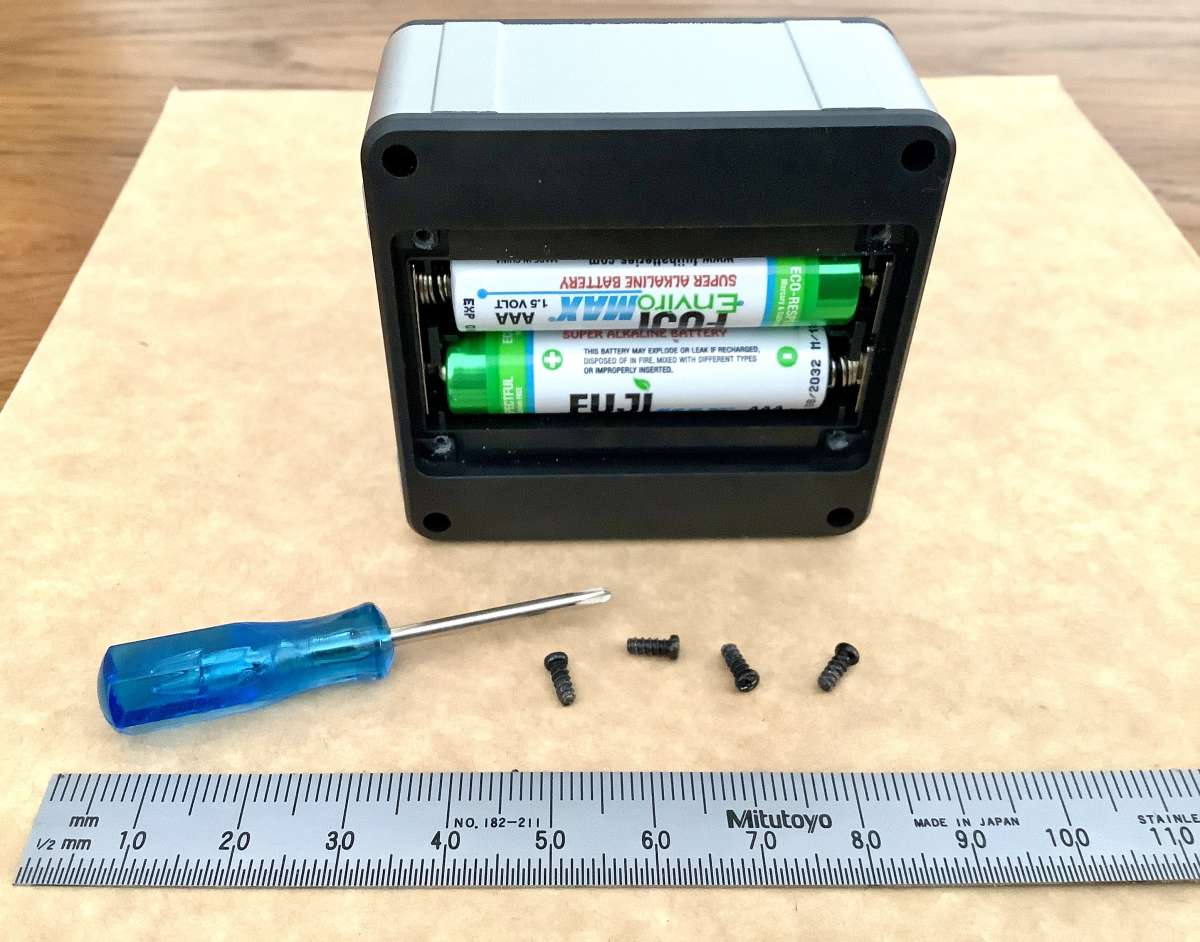

      I’ve bought a Digital Inclinometer for use in the shed. I like to remove batteries from things like this when I’m not using them due to the risk of damage from leaking batteries. I always use good makes but there’s still a risk. The problem as you can see is the screw on back with very tiny screws. It did come supplied with a diminutive screwdriver. I don’t particularly want to leave the back off permanently. Anyone got any ideas for a suitable alternative? It’s only a matter of time before a screw gets lost or the plastic thread gets too badly worn to be effective.

        Perhaps replace the screws with studs and make some knurled nuts to suit or does this side need to sit flat ?
        #732566
        Vic
          @vic
          That’s not a bad idea, thanks! No, it doesn’t need to sit flat.

            My crude solution would be an elastic band, but I have used AStroud’s solution on several occasions. Trouble is finding out what the thread is. I have some M3 brass inserts which can be fitted to plastic cases with the aid of a big soldering iron to melt their way in, provided of course that there is enough plastic

                    This does not help with easily removing the batteries, but might help slightly:
                    Could you engineer a conventional switch onto the battery cover ?
                    If projection from the battery cover is not an issue, you could mount a slide on/off mechanical switch in a small housing fixed to the battery cover and wire it into the battery circuit – assuming that you can get at the wires from the battery terminals.
                    If the battery terminals are soldered directly into the PCB, you will have to get more inventive…….
                    For example; A plastic pin or blade inserted through a hole or slot drilled in the battery cover in just the right place could be used to push one of the batteries away from its positive terminal in the battery holder against the spring on its negative end, breaking the electrical circuit. Attach the plastic pin to the unit with a small lanyard so as not to lose it. When you next want to switch the unit on, you just pull out the pin and the battery will contact the terminal again.
                    The thing about remembering to regularly check if the batteries are dead or remove them after use every time, is that being human, we will almost certainly forget !
                    If you still want to physically remove the batteries, the stud and wing-nut idea sounds best.

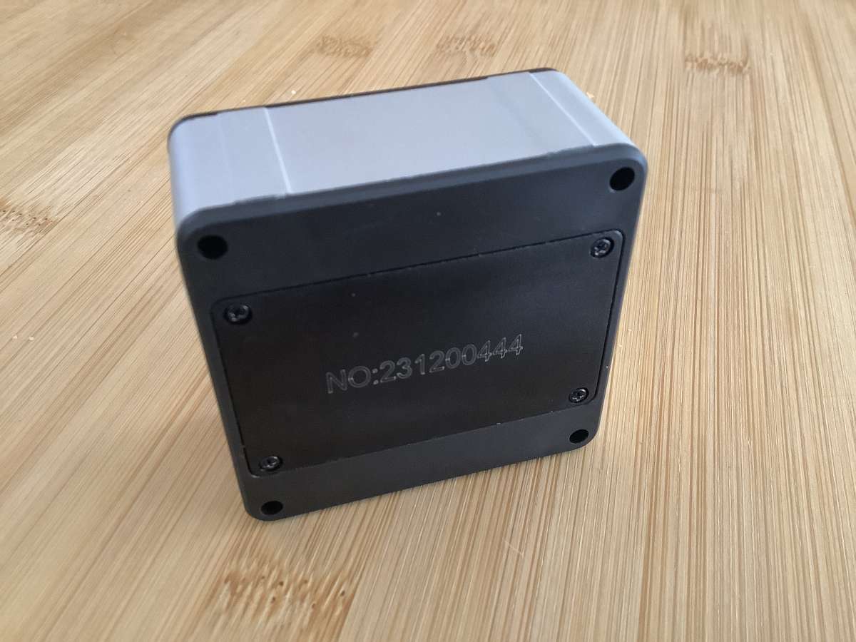

                      Vic’s picture clearly shows four deep holes near the corners of the unit: it may be possible to put plugs into these [same idea as those used for detachable grilles on some loudspeakers] and then incorporate the battery cover into a more robust plate.
                      #732707
                      Vic
                        @vic
                        Here’s another picture of the back. I will need to remove the back at some point to see if I can drill it out to fit some 2mm socket screws for studs. I’ve found some nice M2 knurled nuts on eBay.
