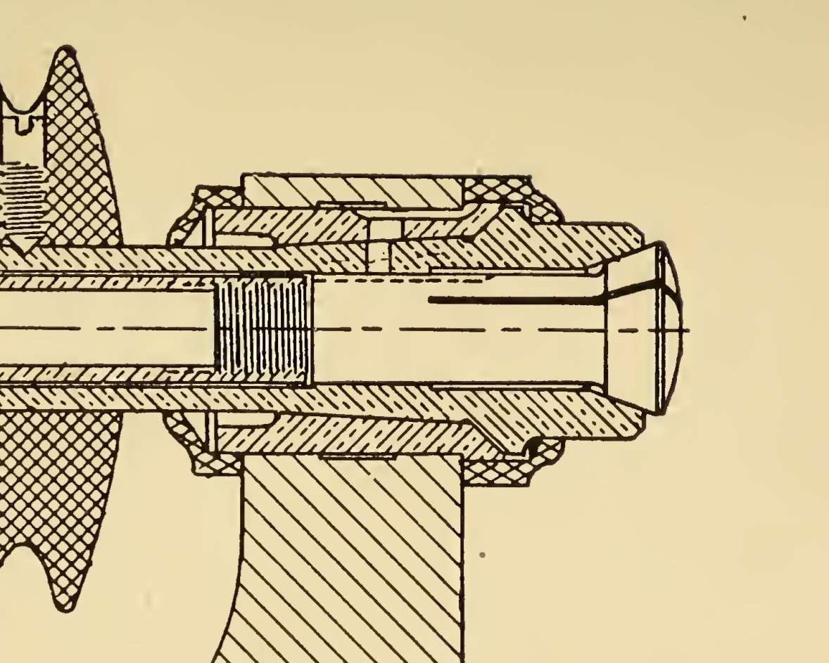

                                Dave [S.O.D.] has already mentioned plain bearings, and I would like to stir that pot a little.
                                In my opinion, the best approximation to a perfect bearing arrangement is the ‘double taper’ that was devised for Watchmakers’ lathes.
                                I have posted this image before … but I think it merits proper ‘Zen contemplation’
                                All the relevant surfaces are hard and there are two tapers … one appropriate for thrust and one for running … The full headstock obviously has an opposed pair of these and they are carefully adjusted to have no preload, but no shake !
                                Is there any better, or more elegant, solution ?
                                IMG_9533
