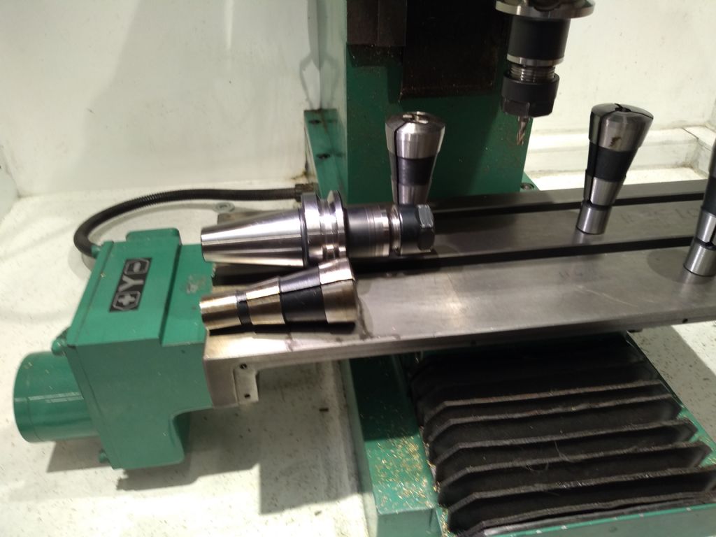

      Thanks to a helpful hint – maybe on here? – I found a Chinese supplier of finger collets that directly fit into a BT30 / Int30 taper as used on my Novamill:
      Quite reasonable price and as you can see compared with a typical BT30 / ER16 collet chuck it saves about 50 mm of tool projection, so gives me that much extra workpiece height to play with – well worthwhile. Not only that but I can now hold a 12mm cutter which would otherwise have needed a larger ER chuck with even more projection. I have 4, 6, 8, 10, 12 mm sizes.

          With only 190mm(?) available, saving about 50mm is like an increase of useable headspace of something like 30-40% in practice?

            Spindle to table is quoted as 180 mm in the machine spec so the usual holders eat up about 30%. Over on the Denford forum someone described making a 70mm raising block for their Novamill, this is much easier though you get rather less increase.

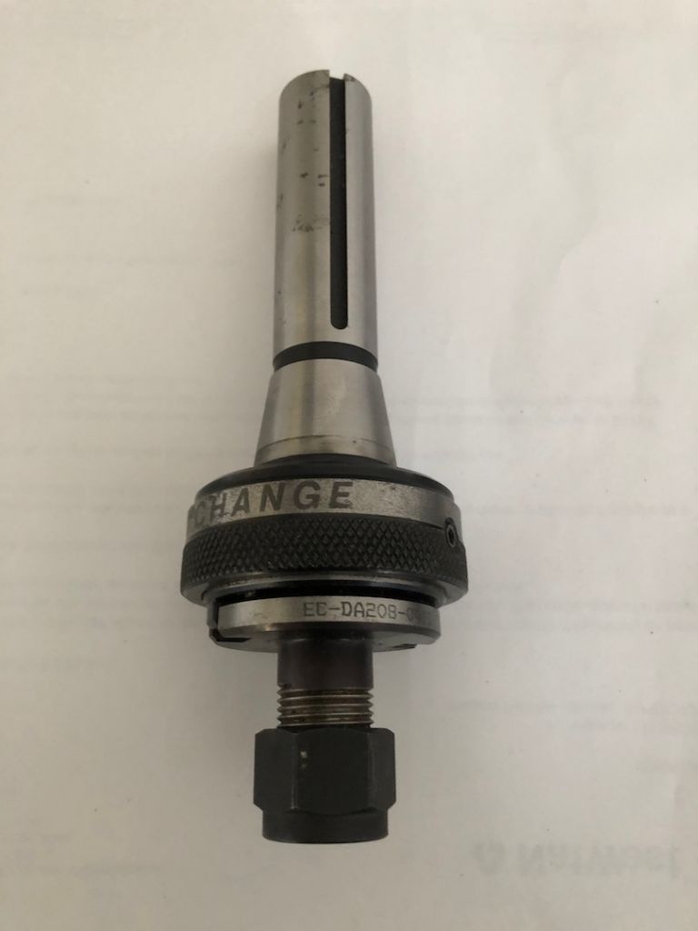

                                    Chris Shelton
                                      @chrisshelton11794
                                      Hi John, after you said the Novamill was never available with an R8 Spindle, I had to go and check to make sure I was not having a senior moment, the mill is not being used at the moment, but yes it is an R8 spindle.
                                      Photo included of the Coventry Easy Change/ R8 adaptor.img_0619.jpg

                                        Chris, interesting! I did say "as far as I know" but what do I know?! I also got an Easychange with two ER16 chucks when I bought mine, but got a couple of Int30 to ER16 chucks which I mainly use as they do give a bit of extra height.

                                                I just picked up my set of these from the post office… Ordered on October 25th from AliExpress so they took almost exactly a month to arrive.
                                                Cost me £39.04, plus £8 VAT and £8 post office 'handling fee'…
                                                Mike – I put the sizes I wanted (20, 16, 12, 10 & 8mm) in the "message to seller" box and the right ones turned up!
                                                Finish on them is ok, but nothing more. The important bits appear to be nicely ground, but the rest is very average.
                                                Had to run a tap down the drawbar threads, otherwise I couldn't get my drawbar to seat them properly.
                                                They don't spin in the taper either on tightening or loosening, which was one of my fears – them not having drive dog slots. The collets self-lock, requiring a tap on the drawbar to release, which is good – the cutter doesn't fall out on the table / work…
                                                Very quick measurement – my spindle taper on its own has a runout of ~0.5thou. My ER collet chuck taper has a runout of ~1.2thou. A 10mm collet + cutter appears to have a runout of ~1.4thou.
                                                The direct collets have the following runouts:
                                                20mm – 1.5 thou
                                                16mm – 1.6 thou
                                                12mm – 2.6 thou
                                                10mm – 2 thou
                                                8mm – 0.8 thou
                                                And a proper 2" daylight increase – probably a shade more if you were to remove the drive dogs.
                                                I haven't done any work with them yet so I can't comment on their holding power…
                                                Satisfied so far…
                                                Thanks for the pointer to them!
