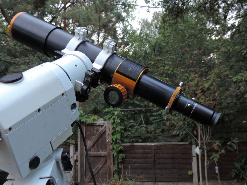

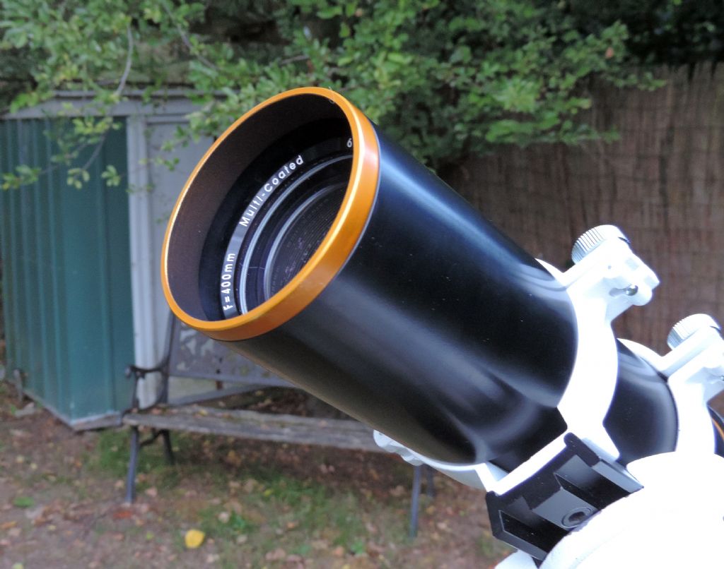

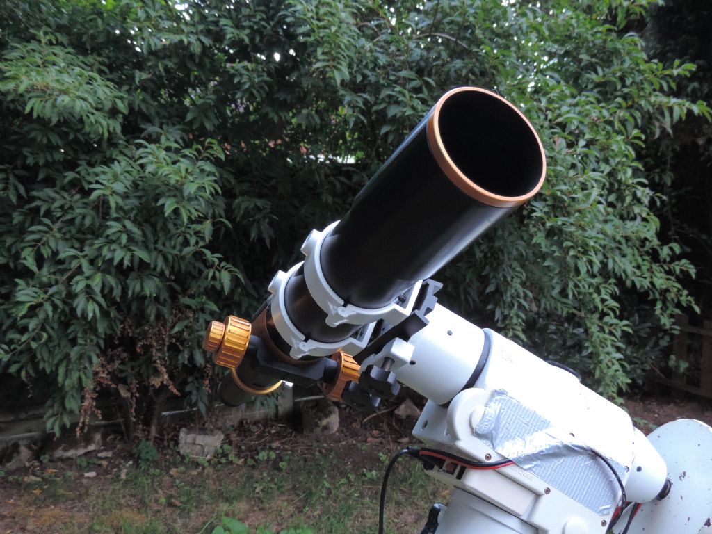

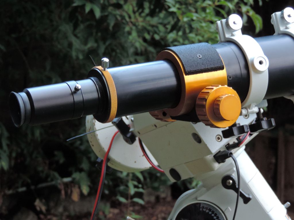

      Telescope built around a Skywatcher 66 ED lens cell.

                    Excellent work – will we be seeing the output on the Astro images? smile

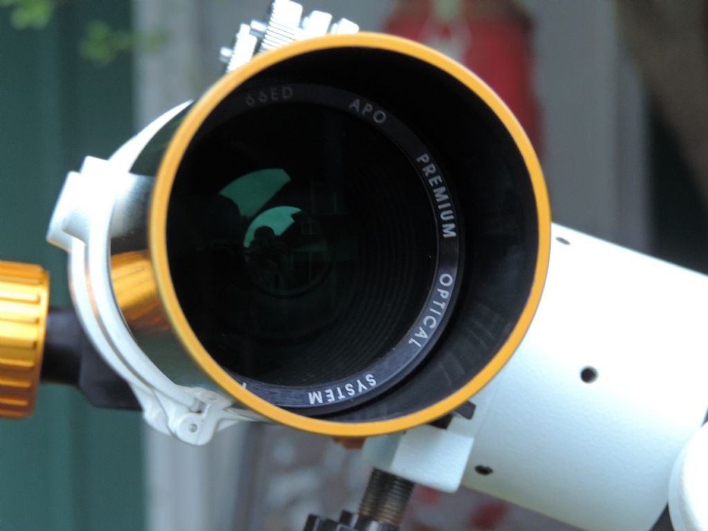

                      Very nice job Neil.
                      Serious question, if I may.
                      Does all the bright white lettering in front of the lens make a measurable difference to image contrast/quality?

                          Nice work Neil,
                          Is, or are the lens' APO as the ring suggests?

                            Posted by charadam on 07/09/2018 23:07:24:
                            Very nice job Neil.
                            I'm sure some contrast-obsessives go over them in black sharpie. I would guess they are low down enough for virtually all the light to be reflected off the front of the lens and any left would hit the internal baffle.
                            More noticeable are the letters reflecting in the dew shield. This means a coat of heatproof black paint is needed over the anodising.
                            #370914
                              Posted by Ed Duffner on 08/09/2018 00:17:43:
                              Nice work Neil,
                              Ed.
                              Not strictly, it's an ED doublet and no doublet can be truly apochromatic, but its performance is closer to a true Apo than an ordinary achromat – Skywatcher are bit cheeky, most scope builders call them 'semi achromatic'.
                                That's the plan all along!
                                I have a telephoto lens the same focal length that frames things well, but has too much chromatic aberration. This scope should be great for larger objects

                                                  A nice professionall job. How do you drive the axis motors?
                                                  David
                                                  #377646
                                                    Posted by David George 1 on 25/10/2018 17:38:13:
                                                    David
                                                    That mount has steppers built in (HEQ5). There is a handset, but i sue it under computer control 9 times out of 10.
                                                    I retro fitted home made steppers and gearboxes to my smaller NEQ3-2.
