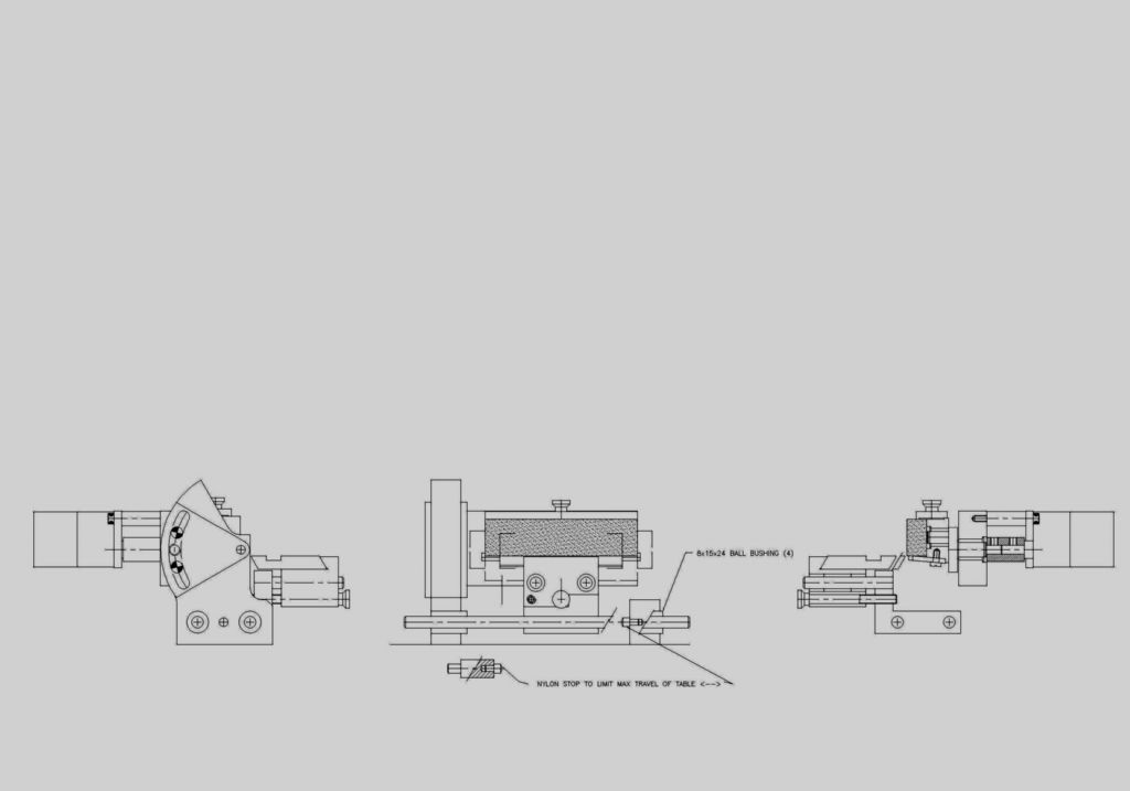

      I have just started the manufacture of a Project which has been 8 years in the design stage. Certain features which I wanted to include in the machine were proving difficult to fit into the space available, but I think I have done it now, thanks to help from John Slater.
      There have been many times I have needed to put a very fine radius on a tool, and while I have managed to do this free hand it would have been so much easier with a dedicated piece of tooling. Which presented the tool to the Hone in a repeatable manner. The recent post on Boring Bars brought out a piece of information from the Sandvik web site concerning the tip radius on a boring tool, with regards to the depth of cut taken. Sandvik recommend that this radius should never be larger than the depth of cut. This has spurred me into getting this machine up and running if only to prove the above works in practice.
      I hope over the coming months to keep you informed of my progress.
            Thanks Michael, but I do not always get things right, no one ever gets to see my scrap box.
            The break through, if I can call it that, came when I thought about having separate dedicated tables for each function. The radius attachment needs a setting fixture and this too took some simplifying, the last thing I wanted was a very complex tool. To set a radius accurately merely requires the use of the appropriate sized feeler blade, but more on that again.
            Regards
            Gray,

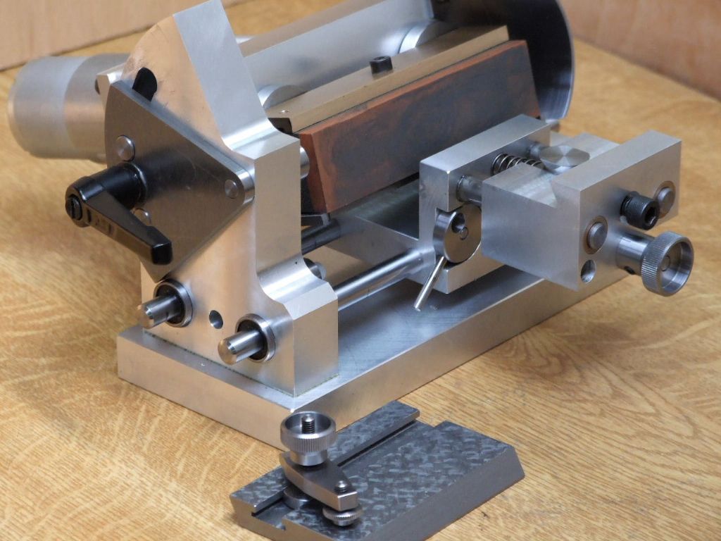

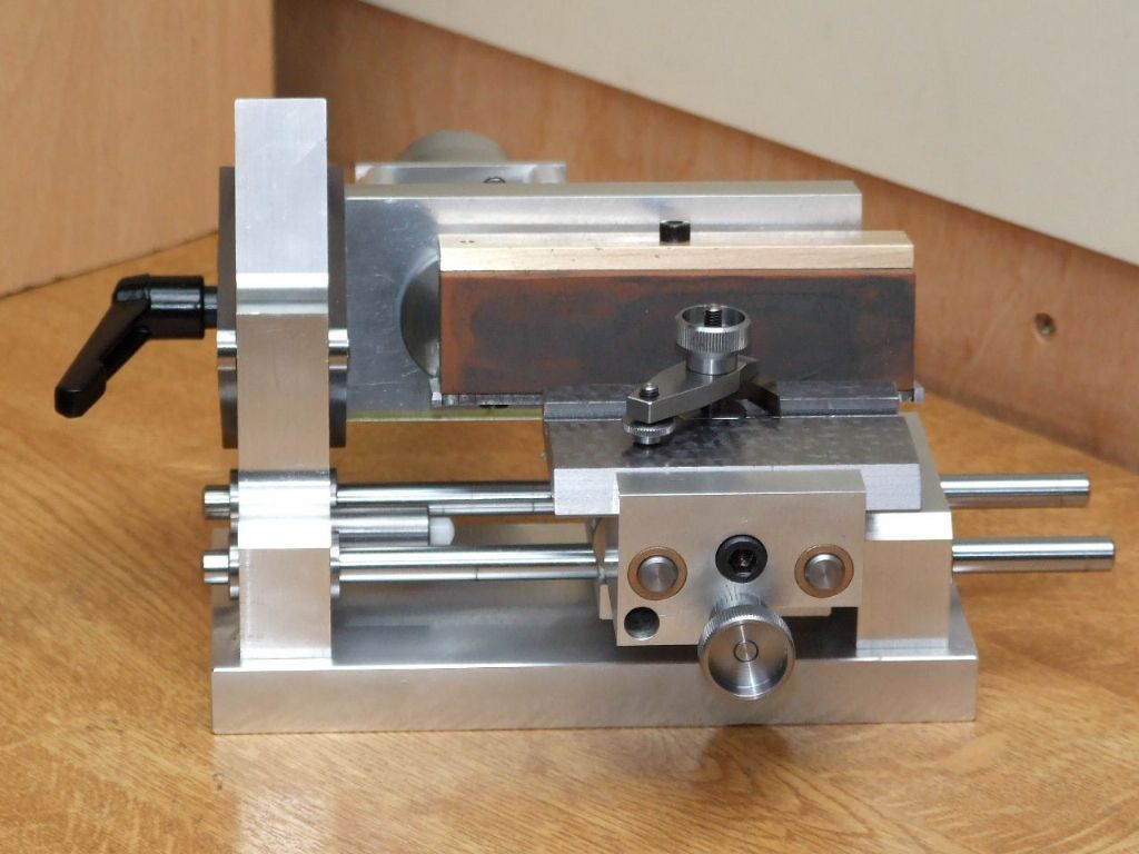

                              I had hoped to take a few more photograph today of the Honing Machine, unfortunately the camera batteries decided they needed recharging, so what I was hoping to show today will have to wait.
                              Here is the Basic machine assembled. The graduated knob on the carriage is for an adjustable stop. The machine has a fixed stop for use when the Radius Attachment is fitted. The adjustable stop allows the extra 0.025 mm or 0.001" to be taken off if desired. As the graduations are 1 mm apart subdividing a division to take less off is easily achievable.
                              The size of tool bit covered by this machine is 0 to 8 mm, larger tools will be outside the sweep of the stone at the lowest point.
                              As can be seen the machine has been in use and has met the requirements of the design. It has also proved to be more versatile than was expected at the design stage. Some more photographs and a more detailed account to follow.
                              Regards
                              Gray,

                                As promised a few days back here are some more shots of the Lathe Tool Honing Machine,
                                This view differs from the previous one in that a Guard has been added to the Rt hand side. With the stone rotating clockwise there was a distinct pinch hazard.
                                This second view shows several things,
                                First is the Spring loading that automatically retracts the table and also automatically locates the interchangeable tables in position for locking. The nature of the clamping mechanism means the complete table with the tool still set up can be removed for closer inspection with no loss of positional settings.
                                Secondly is the two position Deadstop. The primary use of the deadstop is when doing radii with the additional table, (more on that later). It also stops any collision between the edge of the table and the Slip stone.
                                This view shows the Deadstop in position 2, the hole in the stop allows the table to be advanced by a measured amount past the datum position by using the adjustable stop. The graduations on the collar of the adjustable stop can be seen in the first photograph. This collar is only graduated with 10 of the full compliment of 40 divisions as each division is 0.025 mm or 0.001". I could not foresee a need for removing 1 mm with a hone.

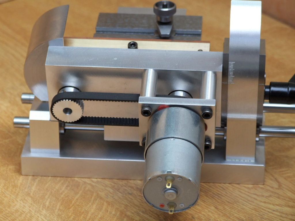

                                A Rear view of the machine showing the drive to the two cranks. The belt is kept in check by a cutout in one of the Motor support pillars so no washers are needed on the pulleys. The graduations on the degree scale can be seen in this view.

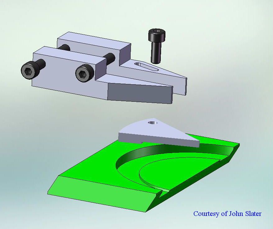

                                        By way of introducing the next phase of the build.radius table (john slater).jpg
                                        This is the separate table that is used to form the Radii on the tools. The centre for the table and sector radius is the face of the slip stone, or hone.
                                        This shows the Fixture parts for setting the radius. I will leave the setting of this fixture until I have finished the fixture. A picture will save me a thousand words describing how the fixture is used. Suffice to say this fixture automatically sets the tool at the correct radius and centralises it in one go.
                                        Regards
                                        Gray,
