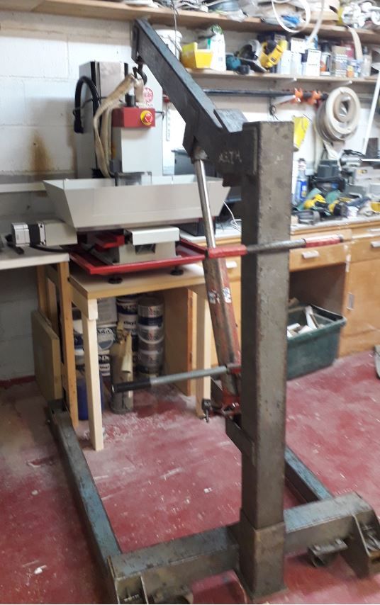

                                    mechman48
                                      @mechman48
                                      I bought one from Machine Mart to lift my WM250V-F & WM16 on to their respective stands with the help of SWMBO. I still have it folded away in a corner for future use, I loaded mine into the back of 3 door Mitsubishi, with the rear seats folded down so you shouldn't have any great problems with your Mondeo. Usual disclaimer applies.
                                      Installing mill onto stand…
                                      George.

                                      Clive Foster
                                        @clivefoster55965
                                        I got one similar to the one in the Georges picture from Machine Mart more years ago that I care to admit. Collected in either a Capri Mk 2 or Lancia HPE.
                                        Good value and effective but, in hindsight, I should have paid bit more and go the version with parallel rather than splayed legs. Especially as mine is the earlier type with straight legs folding very close to the upright and much less space, perhaps 12" – 15" or so, between the rear castors. Not as stable as the wider legged versions and front legs really aren't far enough apart to get properly around most things so you end up working with the jib well extended most of the time. Which doesn't help stability.
                                        Essentially same thing was sold under many brand names. Don't think that any of this older type are still on the market but something to bear in mind if looking at a used one. Although mine does a decent job of lifting I'd not advise getting one just like it. However good the bargain. The style George has is significant improvement.

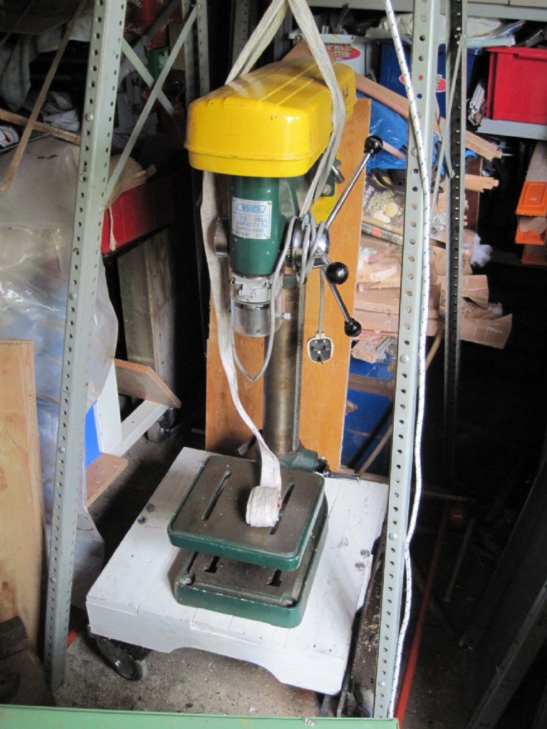

                                        IanT
                                          @iant
                                          I used a friends engine crane (he helped) to lift my Victoria HO Mill on and off the trailer I hired for the job but the actual shifting was done on three steel rollers – 3ft lengths of mild steel about 2" diameter. I'm pretty sure that we couldn't have moved the mill suspended from the crane. This method is only suitable where you have a machine with a suitable base plate of course and when shifting over a hard surface.
                                          All my other, smaller machines were/are moved by lifting them onto a dolly made for the purpose, from some heavy 2×4 timber sections with boarding on top. To lift them I normally use an A-frame made from doubled-up Dexion section and a simple winch. I made some supports that slide underneath as I lift the machine – so a variation on the "pig-sty" method mentioned and if anything moves whilst winching, its simple to ease off onto the supports. If possible, once lifted, the bench/table is placed under the machine instead of the supports – otherwise the machine has to be slid off the supports. The A-frame can be assembled straddling a bench and then disassembled afterwards though. I can do this work single handed, just need to work carefully and take it steady. The two A-frame sections unbolt from the top (cross) section and are normally just propped against a wall – they don't take up much space and cost me nothing.

                                          #415744
                                          IanT
                                            @iant
                                            I guess I've mentioned this set-up before as I already had a photo in my 'album' of my 12-speed drill being lifted off the dolly (to eventually enable it to be placed onto its cabinet). Each leg of the A-frame is actually made of two pieces of Dexion bolted together. I've no idea of what load this set-up is capable of but it has lifted an Atlas MF mill without any apparent problems and as mentioned, I generally do it in small stages with a support placed underneath. So whilst not suitable for very heavy loads (like the Victoria) an A-frame is quite a stable setup and much better/safer than just trying to physically lift things I'm sure.
                                            Edited By IanT on 23/06/2019 16:32:47
