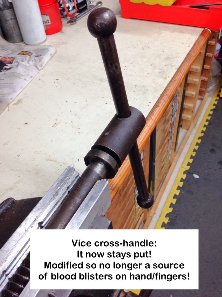

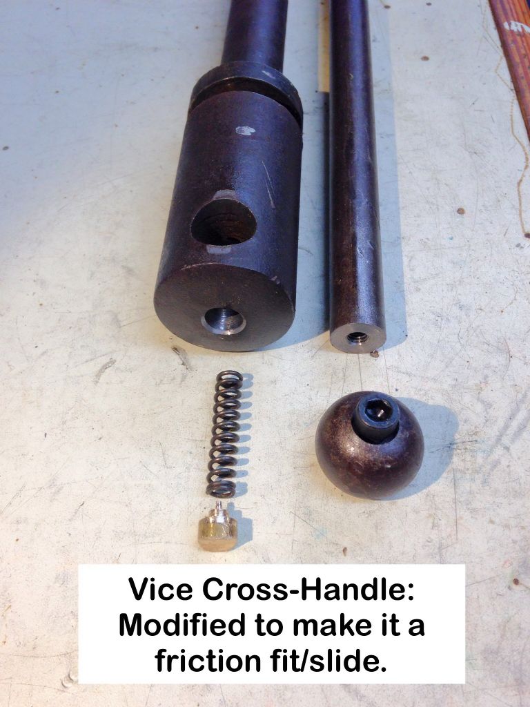

                                                  OuBallie
                                                    @ouballie
                                                    Make the handle sticky as I've done to all of my vices.
                                                    Vice Cross-handle.
                                                    Vice Cross-handle.
                                                    Just don't leave the handle pointing upwards than walk past with a partly unzipped jumper

                                                      Posted by OuBallie on 09/10/2017 13:27:20:
                                                      Vice Cross-handle.
                                                      That's a great Idea !
