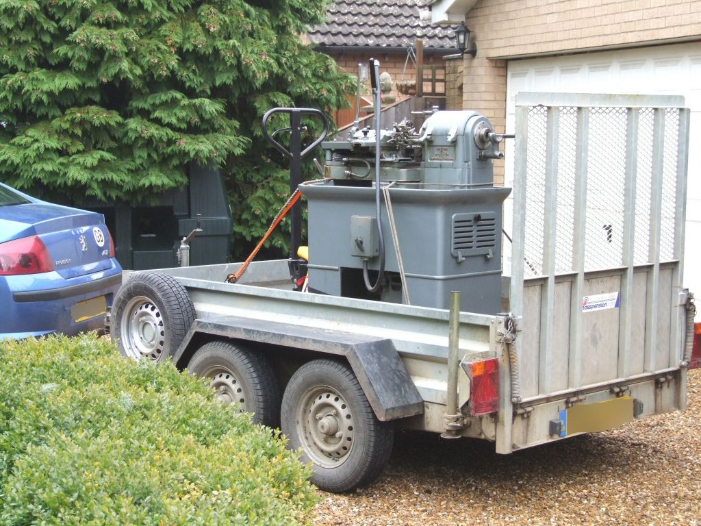

              If by a car trailer you mean one designed for moving a car forget it. You need a two, or ideally four, wheel trailer with a solid floor and ideally a rear ramp. Once the machine is loaded and the balance is right, ~50lbs downforce on the hitch, then block the base of the machine in all directions. And I mean blocks, don't rely on straps. Perfection would be to mount the machine on large cross baulks of timber before loading as that will also help to stop it tipping during loading anf unloading. Once on the trailer and blocked then add straps at angles to prevent any fore and aft or side to side movement. While you may not expect to do an emergency stop, you don't want the machine sitting alongside you in the car if you have to.
              This is how I moved a cylindrical grinder over 100 miles. I was cautious and limited myself to around 50mph on the M25:
              Grinder
              The straps have been removed along with the tie for the counter-balance weight. A better trailer was this one, moving a repetition lathe, only 15 miles but it's still securely fixed. For ease of loading the lathe is actually sitting on a pallet truck, but everything is still blocked and tied:
              Note the stands at the rear of the trailer, very useful when loading/unloading. Make sure you tow with a sensible car, ideally at least 1.5 tonnes kerb weight. It's no fun when the trailer takes charge of the car. sad

                The trailer I am offered is a four-wheel job with low bed and ramps. The access from the old site to the road involves a 180 degree turn, and until we try the trailer empty I'm not sure it will manage.
                The difficulties I anticipate are:
                1. The capability of the engine crane – and this is why I ask about dismantling so the bits weight less.
                2. the headroom above the current lathe position which will not allow access for anything much chunkier than an engine crane.
                At the other end the problem is that the garage where it is to go has a sloping drive – with a Subaru on the trailer and a competent driver we should be OK, swerve across onto the level forecourt, and do the unloading there.
                Thanks for the comments so far – I have a collection of wood chunks, and rope, straps etc. Short lengths of scaffolding should arrive next week.
                Cheers, Tim
