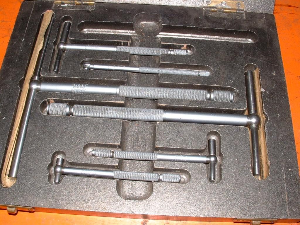

                My choice would be a telescopic gauge set in the bore and when removed from the bore measured across the tips with a micrometer. As has already been stated a certain 'feel' is required when using this method.
                To confirm bore is parallel use a dial caliper as below, you could also use this method to measure the bore by setting mic to desired setting and compare with caliper reading when in the bore.calipers 0.5 to 1.75.jpg

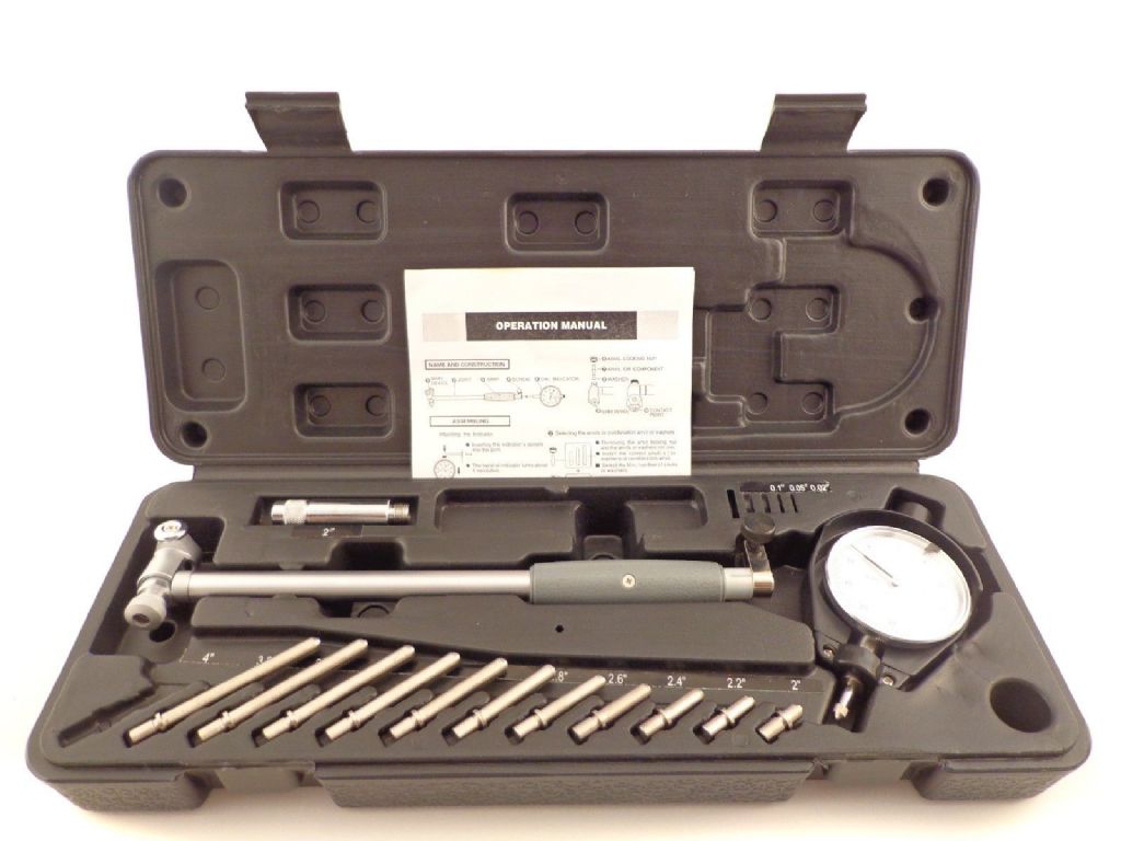

                            Another option to telescopic gauges is a dial bore gauge. Available in different ranges and comes with a dial indicator.
