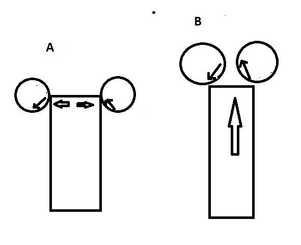

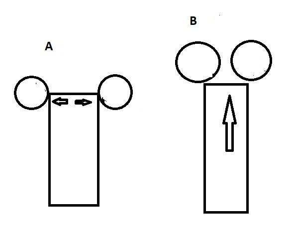

      Hi Guys,
      From my previous post I was helped to understand climb milling is feeding in the same direction as the end mill force. However you experienced guys see more than I am presently capable. with reference to the drawings attached which if any and more importantly why is climb milling. To me they all seem conventional, the idea is to mill a radius on the end half the diameter of the end mill.
      Regards

          All should become clear if you put the direction of cutter rotation on those sketches, Chris

              Assuming we're looking down in plan view, the climbing mill is in the left-hand one in A and the right-hand in B.
              If the tooth or flute entering engagement is able to draw in the workpiece in the same direction as feed because the backlash in the approach has been taken up in the opposite direction, the tooth will have to cut the depth of the backlash plus its normal feed depth. Potential bang, if the backlash is significant.

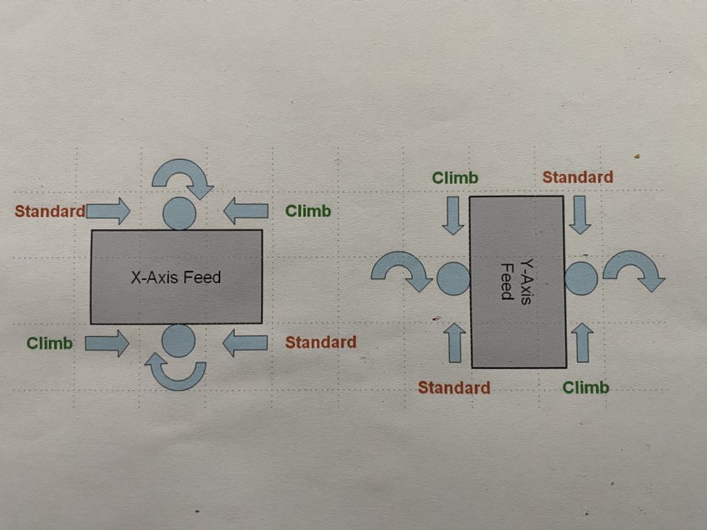

                    Posted by Michael Gilligan on 02/10/2020 15:38:21:
                    Thanks Michael my error was putting the arrows in but not where they make contact. With the arrows in where they make contact all is easily understood. Thanks guys.
                    #499134
                      When the direction of the cutter in contact is the same as the direction of the work they combine and become climb milling.

                            SOD has the best diagram of the two types, it shows clearly the difference and why, if your bed has lots of backlash, why climb milling can grab the work and pull the lot suddenly with unfortunate results. I normally take smaller cuts/feed rates climb milling than with conventional milling.
