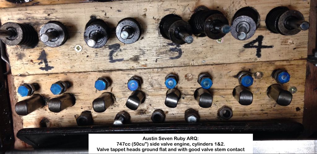

      Photo says it all.
      Tappet head
      I do have a small high speed drilling machine, Dermel equivalent and angle grinders.
      Suggestions please, as all eight need doing.

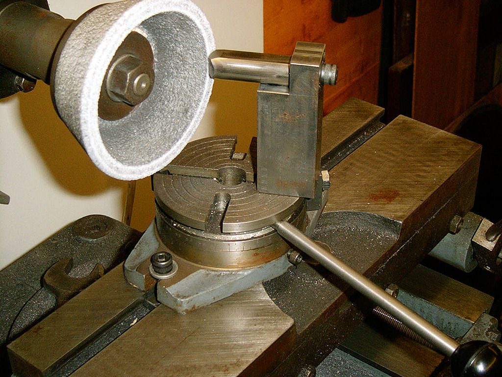

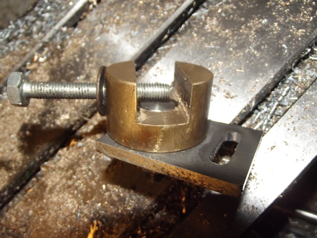

              The tappet screws can be done with a tipped tool, for the cam followers I made this, goes in place of the rest.dscf4926.jpg

                  Thanks for the responses.
                  Cam followers appear fine, BUT will check for uneven contact with trial assembly.
                  Thanks for the offer Chris, and I will take you up on it if my grinding proves less than satisfactory, after I put the camshaft, block and valve gear back together and rotate the cam to check followers/lobe contact.

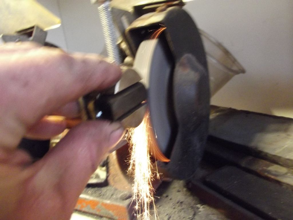

                  Grinding done, using the high speed drilling machine as per photo, and in a typical Heath Robinson fashion by sliding the vice around the table.
                  A quick lick on X-fine diamond card and result as seen.
                  Easier than I expected.
