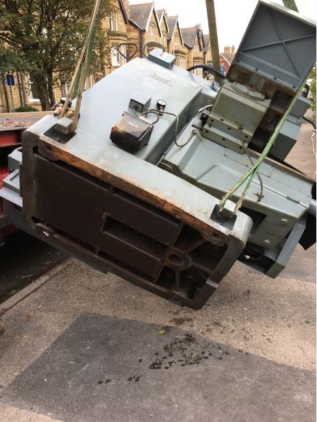

          These so-called "2 tonne" engine cranes are having a laugh. At anything near 1 tonne load, they turn into rubber and wobble about alarmingly. Be very careful…
          I will reiterate my own experience with webbing straps – make sure they attach to lifting points that are ABOVE the centre of gravity or failing that, use several separate straps. Using long straps from one foot, through the lifting eye and down to another foot leads to this. Luckily nobody was hurt, underwear remained unsoiled, no puppies were had and the machine was undamaged.
          Oops
          The manuals for these machines show you how to lift them and where to attach the straps. Do you have them? If not, somebody here can probably upload the relevant pages.

                Apart from that, the hardest part was balancing the lathe before starting the lift. As muzzer's photo shows, it's important to manage the centre of gravity – a heavy machine tipping over unexpectedly could ruin your day! It may be necessary to control the balance with extra ropes.

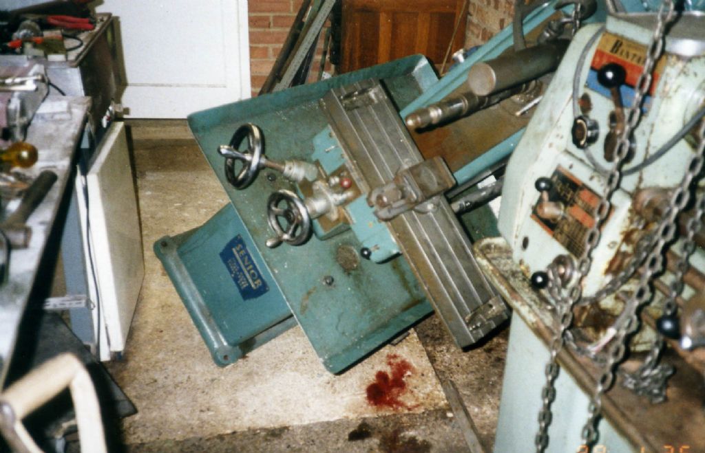

                                The biggest problem is getting the machines off the pallets, both will be top heavy. The Stevenson method using angles is OK, or use a suitable engine hoist just to lift the machine enough to slide the pallet out, and lower it onto rollers without attempting to move it. The picture shows what happens when you lower the machine (a Tom Senior by the way) onto pallet blocks under each corner. The pool of blood is mine, the machine toppled off the blocks trapping me underneath, I was lucky in that my father lived nearby and was alerted to my plight by a neighbour, and he used the block and tackle shown in the picture to raise the miller enough to let me out from under. Rule number 1 is never get under the machine or in a position it can fall on you if things go wrong. killer miller feb 88-0002.jpg
                                Chris Gunn
                                #333303
                                  Posted by Chris Gunn on 21/12/2017 20:06:41:
                                  … The pool of blood is mine, the machine toppled off the blocks trapping me underneath, …
                                  Chris Gunn
                                  Yikes Chris! Glad you're OK
                                  #333307
                                  Chris Gunn
                                    @chrisgunn36534
                                    Dave that was in 1988, and lucky I had a camera handy. I used up one of my 9 lives that day. I had to get the miller up a sloping floor in my garage, and then over a step into the workshop. It was the step that caused the problem really. NEVER BALANCE A MACHINE ON PALLET BLOCKS.
                                    Chris Gunn

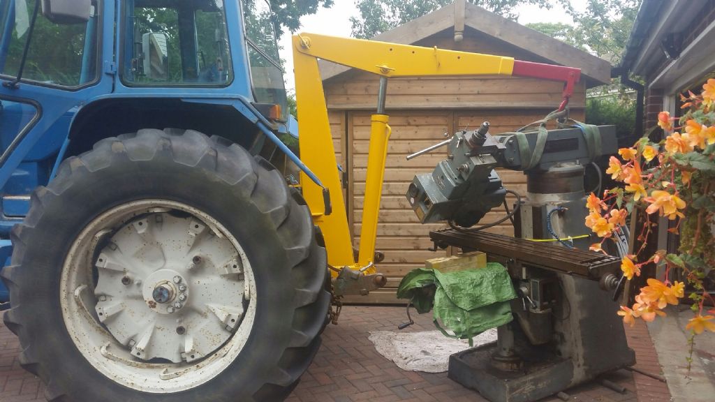

                                        Sometimes, you just need the help of a mate with a little tractor…….😂 The crane used to be my old mobile engine crane, it was rated at 2.7 tonnes or 700kg extended, and was huge, came out of a commercial garage and probably weighed 150/200kg, How they rate those flimsy chinese jobbies at 2 tonne is laughable.
                                        Edited By Alan Waddington 2 on 21/12/2017 21:32:33
