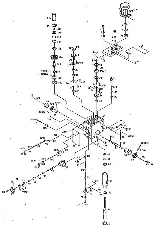

      You may have seen a post re my electrical problems with motor on Chester Super Lux Mill. The combined might of this site has determined that the problem is most likely the centrifugal switch. Unfortunately this is not located in the rear of the motor casing so I need to remove the motor to check the front casing.
      I have removed the 4 cap head bolts holding motor to the head/gear casing. The motor and base plate will spin round but I do not have the strength to lift it up or there is something else holding it. The flange is completely flat against the head and cannot get a screwdriver in to ease it up and out.
      Any ideas, I do not want to break a lug of the flange.

              I would make a plate that fixes on the top end of the motor and fix it to the motor using the three threaded holes that retained the top end plate. Make sure that you get a good length of thread in the threaded holes. I think some reasonable thickness plywood would be strong enough for the plate. Also drill a number of holes (3 or 4) on a PCD a bit larger than the mounting flange. Make some spacer blocks from wood that have about 20mm clearance under the plate. Insert a bolt with a nut on from underneath the plate an put one of the blocks under it. Do the same with all the holes. Use the bolts and nuts to jack the plate up to lift the motor. From the link John has posted it looks like the motor shaft fits into another shaft with a keyway.

                                  I did not realise that the screws were so small. I dont think I would risk them for lifting the motor. You might be able to use two pieces of wood to lever it up on the bottom end of the cooling fins. It would be a good idea to get someone to help by steadying the motor as you are levering it up. Another possibility would be to clamp two pieces of wood (Say about 4" x 1" cross section with one or two lengths of threaded rod each side of the motor. Yoh could then screw blocks of wood to the pieces clamping the motor and use jacking bolts to lift against the blocks..
                                  This is the picture from the document in John's link showing the gearbox. It does not show the coupling to the motor very well. I think the end of the motor shaft fits into the end of the shaft item 31 on the drawing.

                                        Looking at the similarity of one of our work mills, it may be that you have to remove the whole top plate as the gearbox input shaft is pinned to the motor shaft and the whole lot comes out as an assembly.

                                          It took two of us, plus three large H/D flat blade screwdrivers, two of the old fashioned wedge type taper breakers and a couple of copper headed hammers and half hour of hammering and levering before it came free. It was absolutely solid in the spindle in the head.
                                          So its out, now to dismantle. To see the problem look at the other thread re failed Chester Motor.
