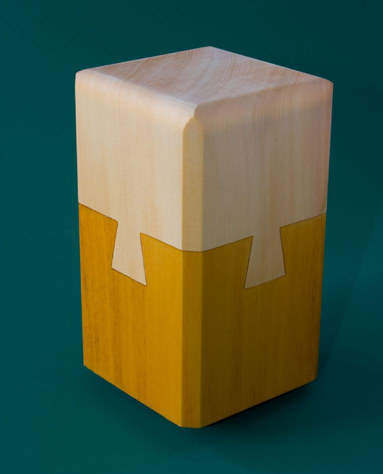

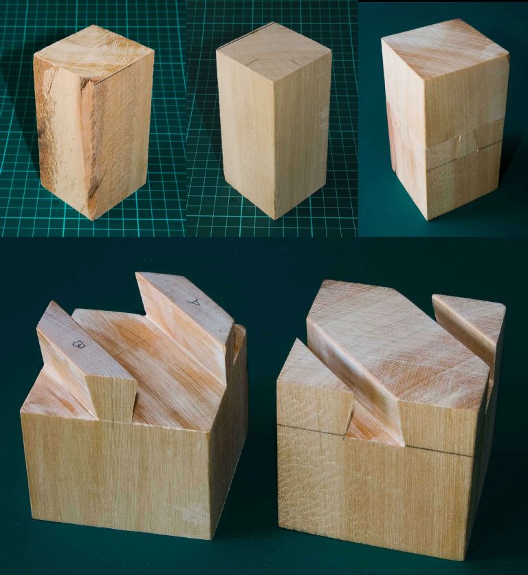

                                A bit like this. Cut by hand from huon pine. I only had a saw, a chisel, and a couple of files. Very laborious!

                                      Ya know if a ball dedent was positioned to make the parts snap together and offer a little resistance to disassambly, and possibly make it harder to figure out..
                                      #223547
                                      Sam Stones
                                        @samstones42903
                                        What it looks like now, but no spring-loaded detent.

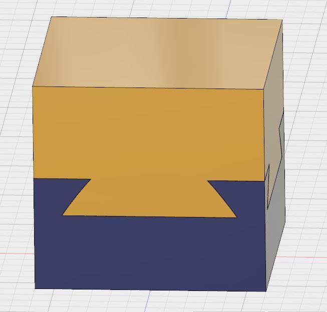

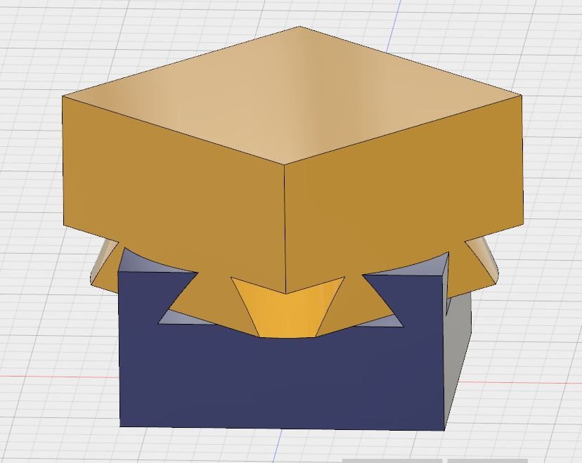

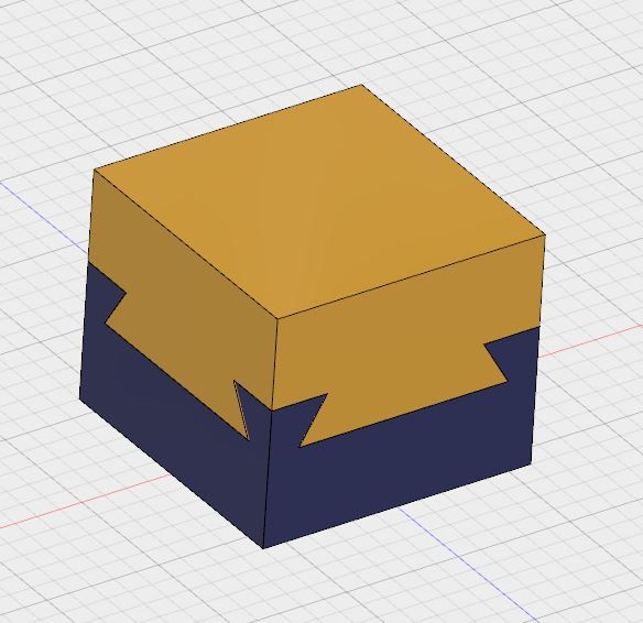

                                          Indeed. And tonight's Fusion 360 challenge turned(!) out to be relatively straightforward.
                                          The woodworkers like the sliding version which is easier for them. But if you avoid the Brown Stuff, you can make stuff like this:
                                          Open
                                          Closed
                                          Murray

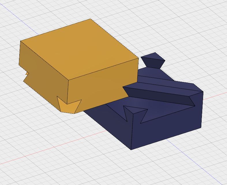

                                            Fusion challenge part 2 – sliding version.
                                            Murray
