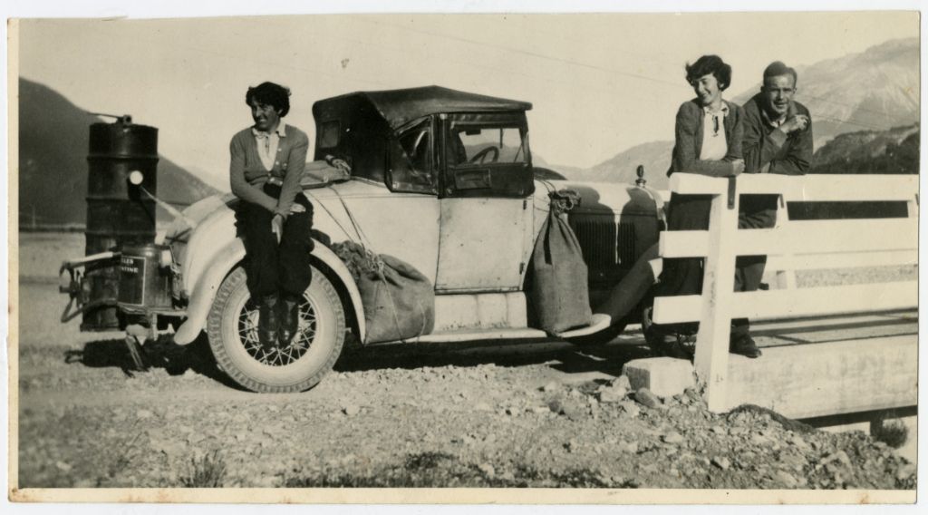

                      Paul Lousick
                        @paullousick59116
                        During the war petrol was rationed and they where also fitted to cars. Shown here on a 1930 Ford Model A.
                        The coke burner on the back made gas to run the car. Note bags of coke on running board.

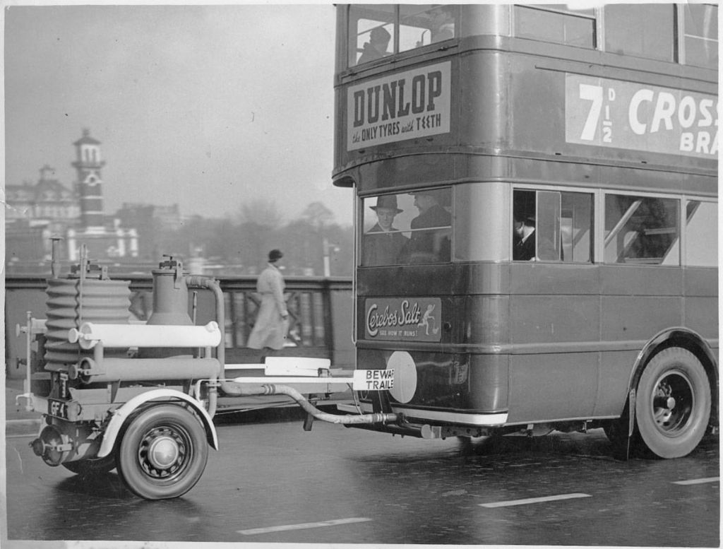

                                    john fletcher 1
                                      @johnfletcher1
                                      I lived in South Lincolnshire during WW11, Boston area, and we had gas powered buses, single decker's, they towed a trailer/gas unit and I remember seeing one with an inflatable bag on the roof. I also remember seeing fire/flames at the back of the unit when the driver put in some coke where a small door was. No one was in a hurry those days, just pleased to get a ride, better than walking, or got on your bike. For us youngster a penny each way, into town, adults three pence return. john

                                          During WW2, petrol for road vehicles was in very short supply, (You ad to be in a special,occupation ,such a special constable, or farmer ) to have a permit to obtain it., My father was a specvial constable and worked for the Ministry of War Transport, so he qualified for a small quantity!
                                          Public transport resorted to towing trailers making producer gas for their petrol engines. the gas was of low calorific value, and so reduced the power of the low compression engines then available.
