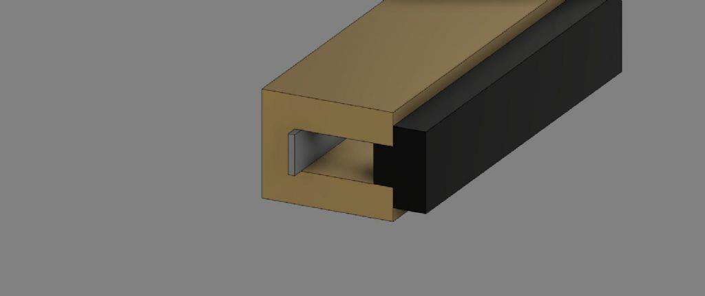

                  After looking at your sketches and tolerances, I suggest that you're concentrating on the wrong edge!
                  I would cut the 32mm lengths slightly overlong – no more than 34mm – from accurately prepared 6mm wide strip.
                  They would be fitted into this slotted brass coloured block, which is 30mm long, and made from however is easiest; milled from solid, bolted/welded/soldered/glued/pinned together from 3 parts.
                  The black clamp is a simple T-shape, deep enough to compress say 10 parts together when it's clamped in a vice.
                  The shiny component is one of the parts.
                  Clamp the whole thing in an accurately trammed vice, mill one end then step over to the other end and mill to size. No grinding needed, just a little deburring.

                    All very well Nicholas but how does he accurately prepare the 6mm strips and as he does not have a mill upto doing 6mm sidecuts then what to do about machining the ends or making the tee section?

                            Posted by JasonB on 27/10/2021 16:45:41:
                            Edited By JasonB on 27/10/2021 16:54:54
                            That's more proof that he's not ready to produce the gadget yet. Which has been mentioned several times, in different ways but apparently isn't a useful lesson.
