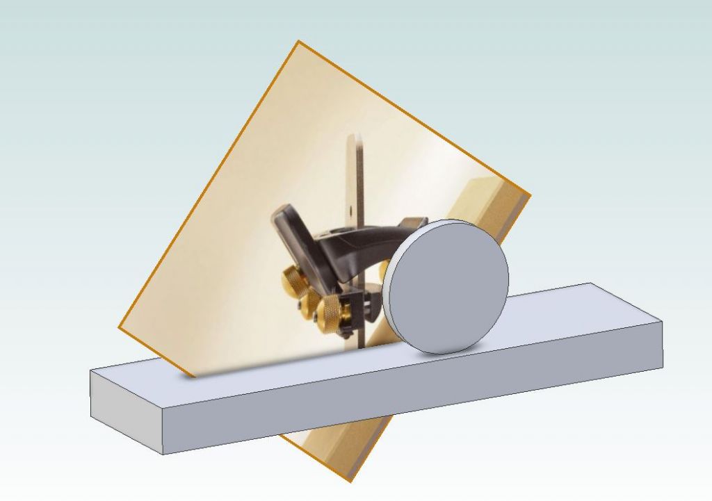

                    Pull the axle out of your current jig and replace with a longer one so you can mount two larger wheels sufficient to increase the angle it can grind to 90deg.
                    Edited By JasonB on 26/10/2021 20:27:32

                      I foresee two problems with Jason's suggestion. One is the requirement to have a slot in the stone, and secondly how will the user know the edge is at exactly 90 degrees (angle changes as the steel is ground away.
                      Ian P
                      #568389
                        I'll ignore the first and as for the second if it's the way Brian has got "remarkably accurate" 45deg angles then the change of angle as the blade or workpiece wears is obviously not an issue to him.

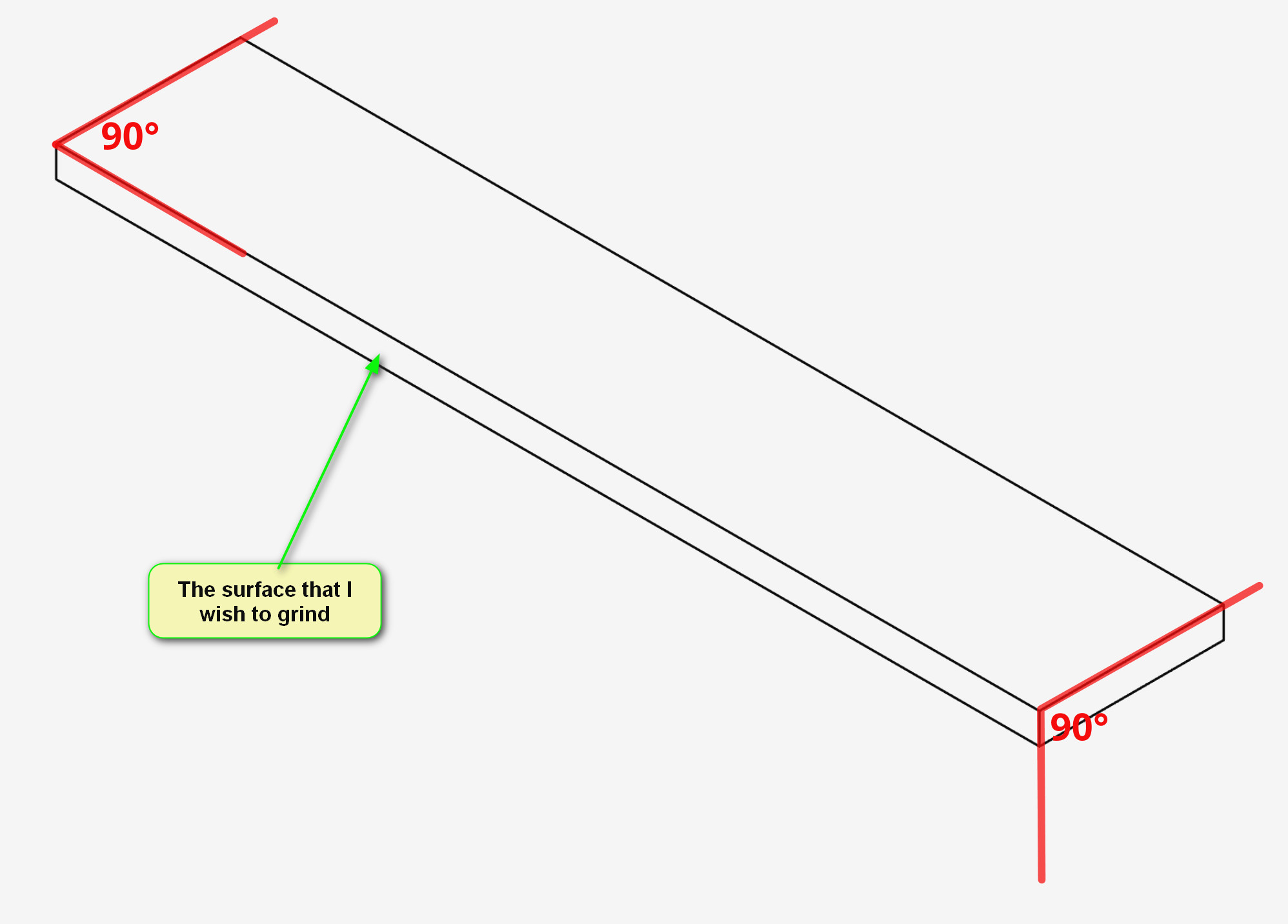

                            OK here is my 3D sketch
                            Here's my part:
                            And here's a face that I want to be at either at 90° (or parallel) to all other faces.
                            (Although I reserve the right to wish to grind any of the faces!)

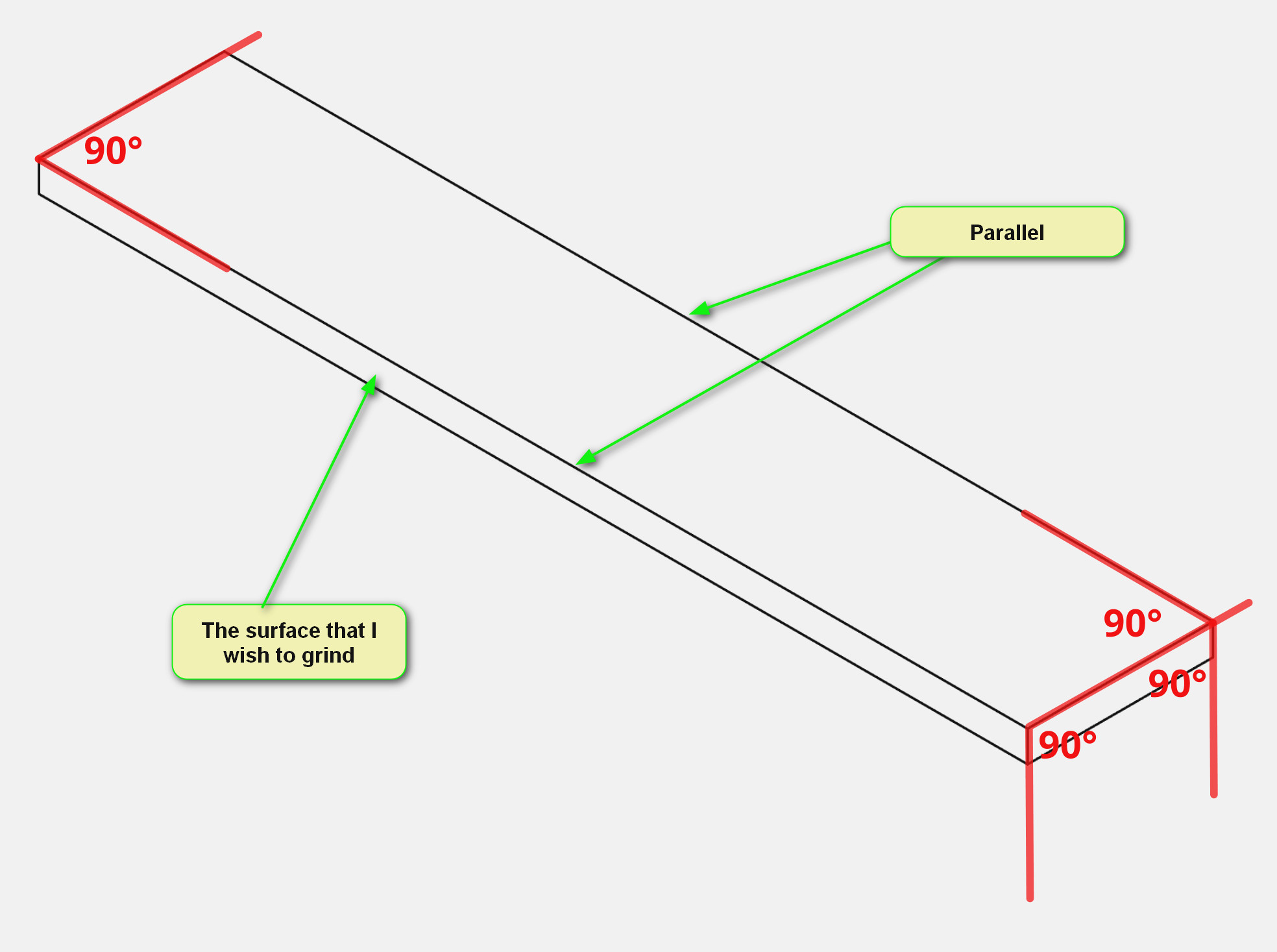

                            EDIT:
                            Wait, it is also important that all of the sides – particularly the long ones are as close to being parallel as possible. So a tolerance of say 0.2mm would be fine.
                            So my sketch should look more like this:
                            In the first instance I only need to make four such pieces.
                            If successful, then later I may need to so a short production run of say x64 of them.
                            > and the resulting block could be filed by hand to exact size
                            The problem I find with filing is that try as one might it's incredibly hard to not at least very slightly round the edges.

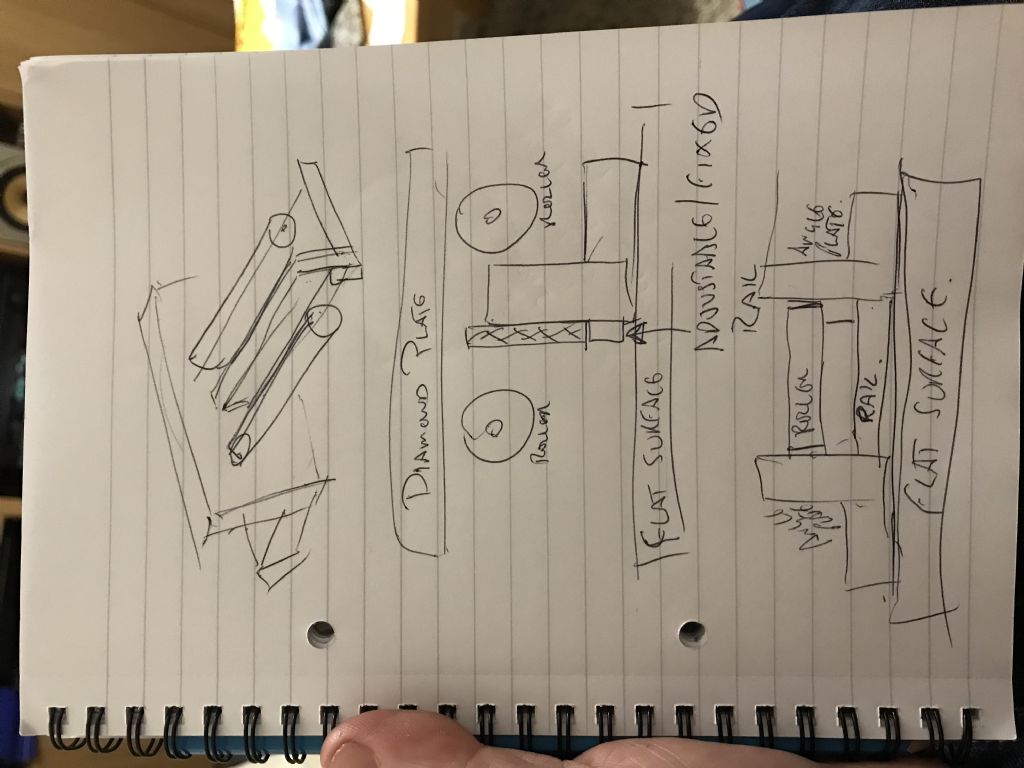

                              2 or 3 angle plates and a pair of rollers. Set the whole lot on a flat surface. Adjust the rail to give required size, push up against angle plate to give squareness.
                              Sketch appears to be at 90 degrees to the intention.

                                  Jason, the main problem with your design is my current hone has a roller rather than a pair of removable wheels. Also I can't just cheerfully destroy it because I am still using it to cut 45 deg chamfers!
                                  I still say a 4-wheeler toy with nice hard plastic wheels & zero suspension could be made to work. You would need to push hard down too keep the wheels on the ground. Maybe really solid a little toy railway carriage…(?!) with a vertical cut through the centre of it. Of course one would need to take care not to accidentally grind any of the wheels….
                                  OR maybe quite a large toy whose wheels straddle the diamond hone without actually touching it? Of course it would need to be held low to minimise vibrations.

                                    This:
                                    is a roller filing jig for a lathe.
                                    the 2 rollers guide the file in a linear manner. Traditionally they are used with a head stock division plate to file squares and other polygons onto the end of round stock.
                                    Squint a bit and refer to my sketch and you will see how to make such a thing.
