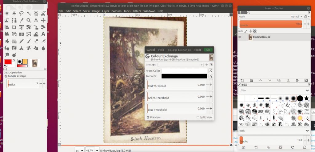

              GIMP has a tool for doing this. From the menu bar click, Colours->Map->ColourExchange. It gives a dialogue like this:
              The colour exchange dialogue lets you select a colour from the image (with the eye-dropper button) and then change it to another colour. The new colour can also be selected from the image, or it can be set manually to anything. The RGB threshold sliders control how close you have to be to the selected colour for the change to be made: this is necessary because many images are built of similar but different shades.
              By default colour changes are applied to the whole picture but you can select a specific area to work on. Works fastest and best on images with a simple colour scheme – can be hard work on images packed with subtle shades.

              Francis makes a good point about GIMP's steep learning curve. It's easy enough when you 'get it', but it's NOT like Photoshop or other picture editors. For example, the screenshot above shows GIMP uses 3 separate windows to do its stuff: this alone is enough to blow the mind of many a newcomer! It's done that way so power users can edit with more than one screen: typically a big screen is used to display the image and all the controls are out of the way on a smaller one. Great feature but it tends to stall the average Joe out for his first test drive.

                                Success! I looked at some tutorials and the manual (which has very clear and logical section names) and ended up doing this:
                                1. Posterise the original scan with: Colours. Posterise> Posterise Levels [10]. I chose a fairly high number to reduce the number of intermediate shades of grey. Puzzlingly, these were present even though I scanned on a black-and-white setting.
                                2. Tools>Selection Tools>Free Select. Zoom in using <Ctrl+Mouse Wheel> and draw an accurate outline of the desired area.
                                3. Colours>Map>Colour exchange>From colour [black] to colour [red, for example]> OK.
                                4. File>Save as>[suitable name]
                                5. File>Export as>Select file type (by extension)> JPEG image> Export [and follow any further instructions on screen.]
                                I think that's all there was too it. I know there are short cuts available and I used some of them. It wasn't scary at all because I was trying to do a very closely defined task.
