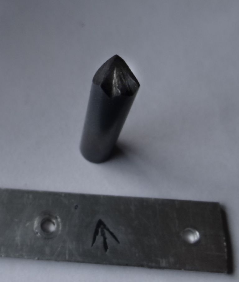

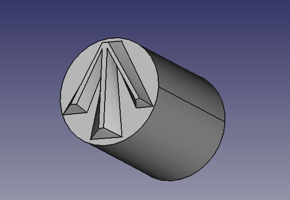

                                    #401564
                                      Broad arrow, done roughly with a flat file and a two small triangular files wasn't difficult on an 8mm diameter silver-steel rod.
                                      The arrow stamped onto the Aluminium strip was filled with shoe polish to get a better photo. Sorry about the punch, the shadows fooled my camera.

                                                  Nothing wrong with that punch sir, similar method to that used in old days I guess.
                                                  A lot of my decorative work is done with needle files in a similar way.
                                                  And I made a lot of punches for my fly press to make nail Mark's on my blades etc.
                                                  One nice tip for finishing a punch marked item is to flood the mark with silver solder and the file it back to flat so the mark becomes a bright print rather than a dark indent.
