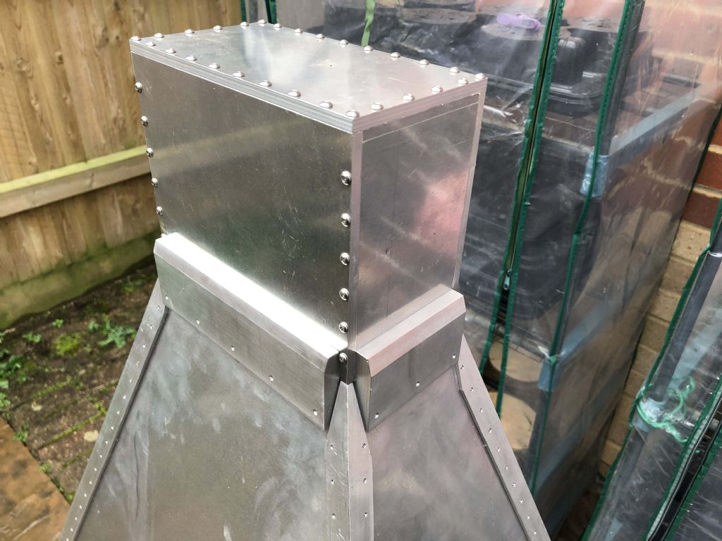

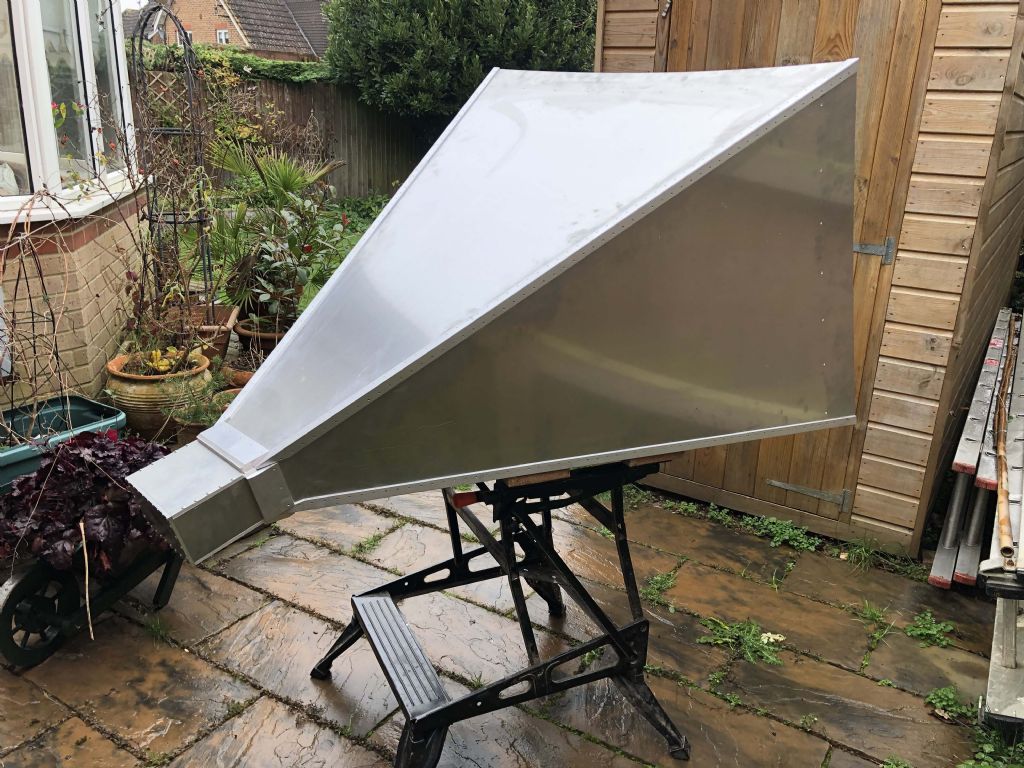

        Hi folks,
        This project made an interesting diversion form my Stuart Beam engine. There seem to be people on this forum who are interested in astronomy so I thought I'd post this. It was made for my brother in law who is a keen astronomer and is just getting started in radio astronomy.
        It's a pyramidal horn antenna designed to operate at a wavelength of 21cm (1.42GHz) which is the hydrogen HI line **LINK**. The dimensions are quite large for a horn at 940 x 735mm aperture and approx 1.4m length including feed. This gives a theoretical gain of 20dB.
        Because I don't have the skills or equipment for welding, the whole thing is bolted together. Some might be wondering why there are so many bolts; they are spaced at 1/10 wavelength to ensure good electrical continuity at the frequencies of operation. There were no particularly difficult parts apart from cutting some reasonably accurate tapers on the mill – these are for the transition pieces between the waveguide feed and the flared horn section – first time I used a sine bar. The large flared plated were cut at reasonable cost by Model Engineers Laser. The design for the mount is still being worked up.

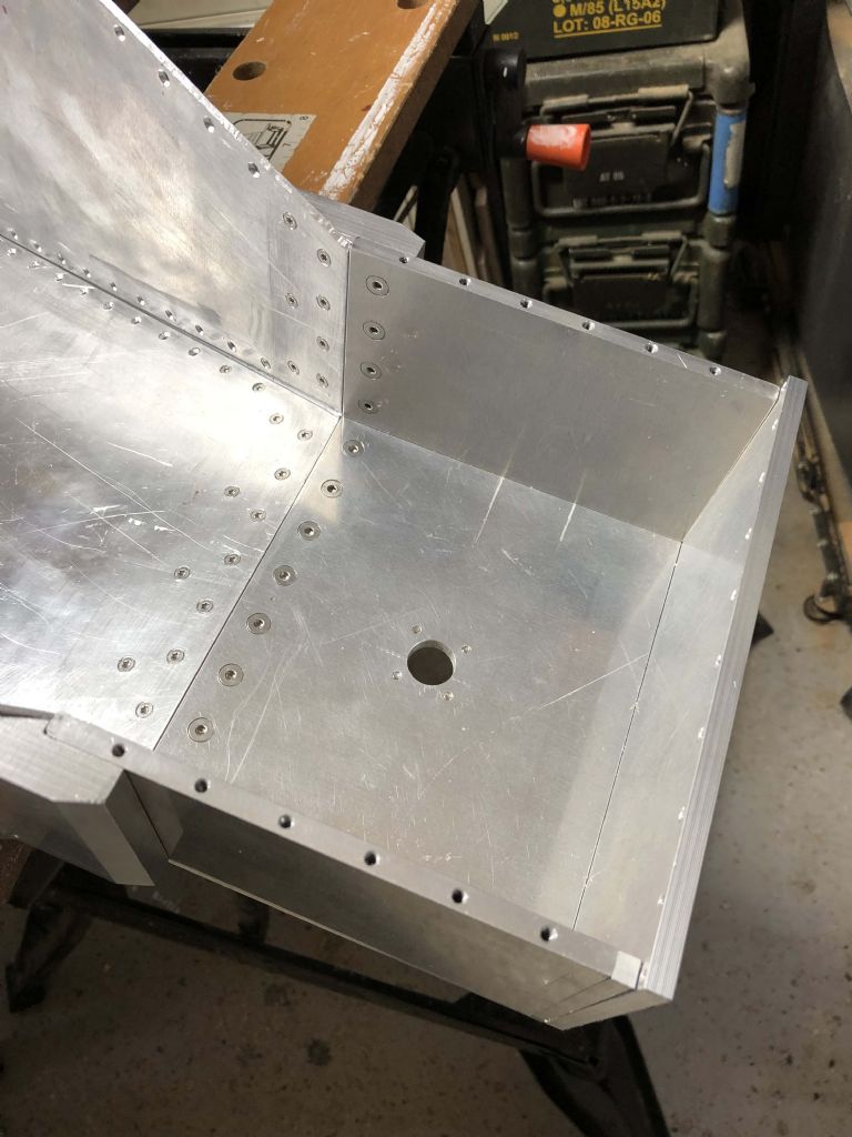

        The following picture shows the waveguide feed section and transition section:-
        This shows the method of construction internally and the fixing/feed point for the coax connector:-
        Hope this was of interest,
        Clive

                Nice Horn that Clive! Have you an idea of the weight?
                I must admit I would have thought a Parabolic dish antenna would be far easier to mount, manipulate and set up.
                I realise you are not into antenna – Is your brother in law an antenna guru?
                A 1 meter diameter dish ( almost the same frontal area as the horn) of F/D ratio around 0.4 ( typical of most small TVRO dishes), fed with a very easy to make patch antenna or better still a 2 to 3 turn helical antenna ( even easier to make) will give an antenna of around 65 to 70% efficiency, and gain of 21 to 23dB. If using the helical feed it has the advantage of only 3dB signal loss for cross polarised signals, very typical of the hydrogen HI line radiation oft rapid polarisation oscillation. The horn would give 3dB more gain if aligned with the signal polarisation, and 'no-gain' if cross polarised.
                The dish would be much lighter and not require polarisation rotation if fed with the helical. Wind loading would be a little more, maybe 20% or so, front on, and probably less side on.
                All those screws….! My Goodness.
                I think welding on that size may cause some distortion, but even 5mm distortion would affect the gain by no more than 1 to 1.5dB at worst.
                Do you have photos of the curved transition pieces? Those are the trick in the matching..
                Regards
                Joe

                  You will need to watch out for the joints getting corroded where there are currents flowing across them. This can seriously affect the waveguide loss.

                    Joe, The horn was supposed to be a simple solution, although it is a bit unwieldy at 15kg! In the longer term, particularly for gains higher than 20dB, agreed the dish would be a better way forward but I believe the feed needs some care. The transition pieces are shown in the third figure.

                      Looks about the same size as a J band one I built at uni.
                      Of course at J band even though simular size much bigger in wave lengths (J band is 15 to 30 mm ) and from memory Large end was 800 mm..again from memory output was 15 mm widest so area ratio 2800 gain of around 28dB measured mid band..
                      Learn to weld brass for this..using beautiful Oxy hydrogen torch..

                        Yep, 15kg is a 'bit' unwieldy! A 2 turn helical feed for a dish of between 0.3 to 0.5 F/D is very easy to do and to match. It becomes difficult when the dish is very deep and the feed gets closer to the rim of the dish – the feed cannot easily illuminate the full dish sides so the efficiency drops.
                        I still am not sure what the transition pieces are – When you mention by that name, it normally means the curved tapered transition plates as in the photo below, seen from the open end. Those plates extend the horn matching bandwidth to a decade or more, and I was wondering why such a wide frequency bandwidth was needed when the interest was only in the HI line frequency – since those are not the plates you mean the horn is indeed narrow band – matched mainly only at the resonant frequency of the coax feed element at the horn focus.
                        I am interested to see how the horn performs, and what the cross polarisation effects show up as.
                        Still an engineering masterpiece!

                            I think your picture shows a double ridged horn which is optimised for a much wider bandwidth. Here is where my knowledge of antennas becomes extremely flaky however. The pyramidal horn I described is fed from rectangular waveguide (WG650 size in this case) which limits the bandwidth to approx. 1.15-1.72GHz. It is a very conventional design. The transition plates as I call them just connect the rectangular waveguide feed to the flared plates where the angle changes and there is no gradual flare. They serve a very different purpose to the tapered "ridges" shown in your picture, there are no "ridges" in the horn that I described.
                            Clive

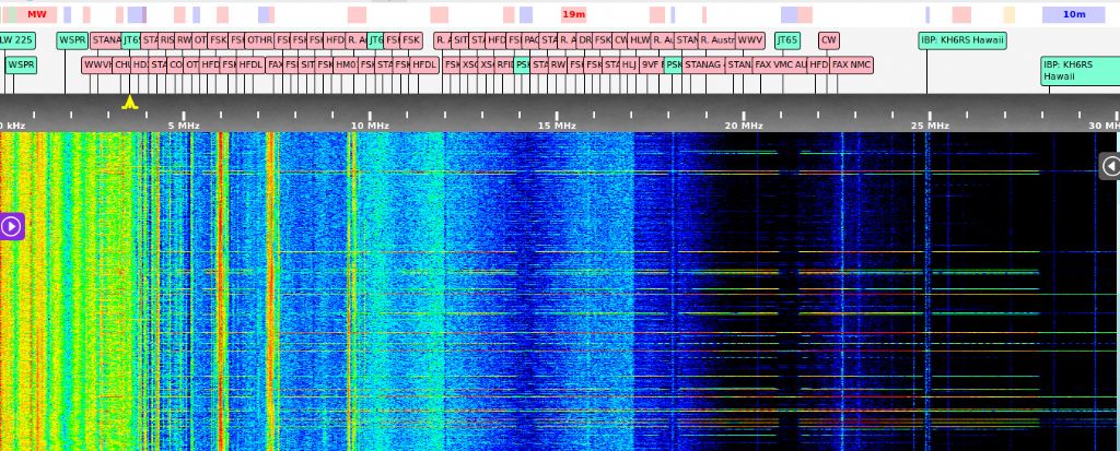

                              That is interesting specially considering the problems I'm having at the moment at the other end of the spectrum using a wire antenna consisting of 15m of wire in my loft and 12m out the window across my back garden, about 8m high. Despite the antenna being carp 200mW of WSPR on 3570kHz was received 2700km away in the Canary Islands, and by k9AN in Illinois on 7040kHz at 6300km. I'm trying to analyse the data to see if I can calculate the height of the reflecting layers in the ionosphere.
                              Much less success receiving. This is my new toy, a KiwiSDR, which can see from 10kHz to 30MHz in one go.
                              The waterfall display shows heavy interference and no obvious stations. On the left the Long Wave is full of hash from switch mode power supplies and energy saving lights. I think the Medium Wave is hidden under ADSL internet noise radiated from telephone lines. Shortwave up to about 18MHz looks to be awash with VDSL noise also off phone lines. The bright horizontal lines slashing across the screen are caused by my Ethernet over Powerline equipment.
                              Partly my own fault – I bought a house that's almost surrounded by pole strung telephone and power cables.
                              Lot to be said for pointing a beam into the sky – I might be able to hear something! As to detecting doppler shift from the arms of a galaxy, I've no idea how big the effect would be or how long it would take to measure it? I'd need to make a long yagi and a motorised equatorial mount to keep it on target. The radio and data analysis part I think is fairly straightforward. Ten years ago technology would have been special: today it's almost too easy.
                              Thanks for the link – another fascinating distraction!
