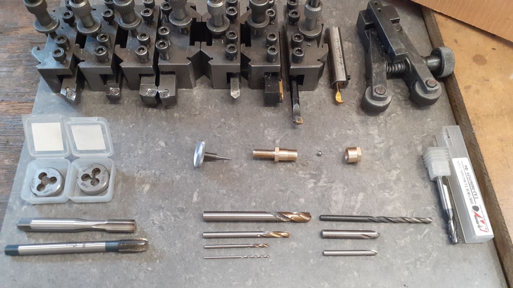

            I was in the workshop for about 1.5hrs today and made three small parts for a carb and used 9 different tools, 7 were in their holders two had to be mounted in the non-dedicated one I keep for this and only one of those needed adjusting to ctr height done by eye. Luckily they were all non ferrous otherwise I might have needed a couple more tools which even if they had shims already sorted would all have taken longer to change over than they do with my QCTP.

                  Yep, even though the majority of my holders are locked to the height for the tool that stays in them I still have the easy screw adjustment for the couple of holders kept for all the other cutters be they Insert, solid carbide or HSS
                  Oh and seeing the Lammas tool post mentioned today, I also have a couple of extended tool holders if needed for additional tailstock revolving ctr clearance where a 4-way either means excessive tool stick out if it is not to hit the ctr.
                  here are the tools used to make the 3 small parts mentioned above that are in the middle of the photo, two brass one stainless. Had I not saw the part off the stainless bar then a second parting tool could be added to the lineup
