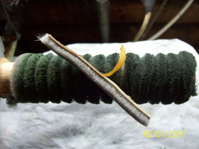

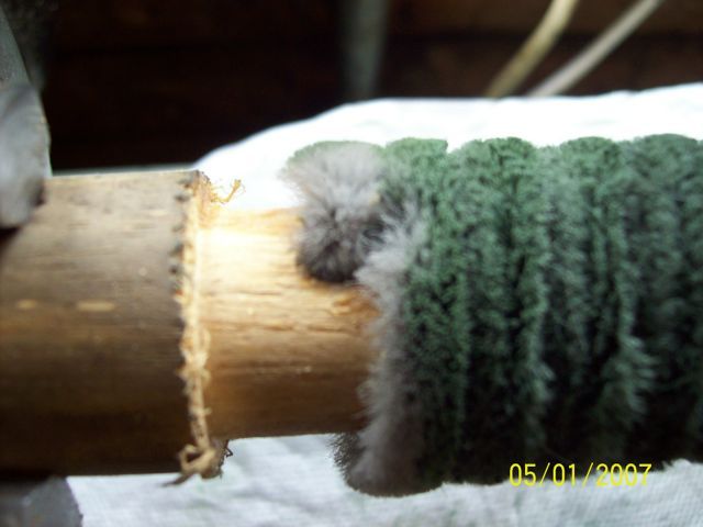

                Hello Bob, you may find this useful in achieving the surface finish you seek. I used it to polish some bores, using green buffing compound mixed with a little oil, but equally well you could use a different compound, such as superfine grinding paste if you are after a micro-scratch oil-retaining surface. A very short description can be found by searching for 'quick and effective bore polishing mop'.
                Bore polishing mop
                Fixing method
                It comprises adhesive backed draught excluder and (in this case) a piece of broom handle, turned to about 3/16" smaller diameter than the bore. Spin the mop at modest speed in the lathe or drill, and feed the casting back and forth by hand, making sure of course that the mop is not too tight a fit.
