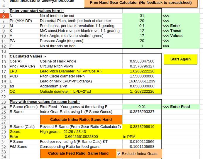

                  Adam kindly emailed me a copy of hobnail last night and I looked at the code.
                  I was hoping to find it written in a way making it easy to modify the calculation to accommodate a 6 gear rather than 4 gear compound,  and then allow me to patch in some timing statements to measure performance.    Unfortunately, more work than I care to do out of curiosity:
                  • the VBA code is event driven by changing various cells in the spreadsheet, so there isn’t a single simple interface to a number-crunching function.
                  • the number-crunching is done by ‘for’ looping through a deep list of nested if statements, ending in the 4 gear calculation.   Not obvious to me what new ‘if’ blocks would be needed to do 6 gears, or how the ‘for’ loops should be modified.
                  By default the program arrives set up on the assumption that the hobber has 71 change gears available in increments of 1 tooth, from 30 teeth to 100 teeth.   Having the full range available makes it much easier to find a close match, but real hobbers are likely to come with a much smaller gear selection.   The user is expected to delete gears he doesn’t have from hobnail’s “Preferred Gears” table.   Begs the question, “what’s the smallest range of change gears needed to hob most gears?”  My gut reaction is that this is more difficult than identifying the minimum set of change gears needed by a lathe to produce most pitches/TPI.
                  To reiterate what Adam and others have said, hobnail isn’t a lathe pitch calculator.   Instead it calculates change gears and other parameters for a hobbing machine, possibly one model in particular.   (I don’t know enough about hobbing to confirm that the code is suitable for all machines.)   Two compounds are needed, one for the indexer, the other for the feed.
                  Helpful to see what hobnail looks like:
                  hobnail
                  Note that the program isn’t entirely deterministic – the operator is invited to play with the F starting value to get a better match.  Also, not shown for space reasons, it calculates different ratios for the other hand.   This is beyond my understanding of hobbing!
                  Although hobnail is implemented with VBA inside an Excel spreadsheet, implying it will only run on MS-Windows with Excel installed, I tried it first on Linux and LibreOffice Calc (also available free for Windows).   Pleased to report hobnail appears to work correctly without needing Microsoft.

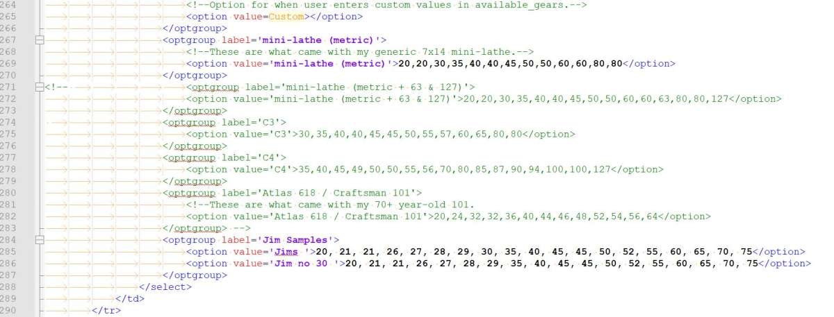

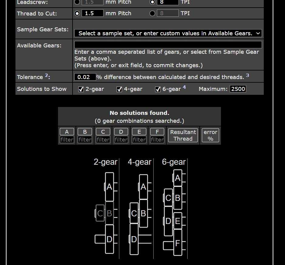

                            If a required feature is that the program be local so that any modifications don’t have to be re-entered then I have a program I downloaded from the web called
                            Gear Change calculator.
                            It’s free to distribute, it’s an htm file with calculations done in Javascript.
                            Easy to run, just click on the file and it will run in your default browser.  Open with a text editor and you can modify the list of default gears.  It does handle six change gear setups.
                            Re-distribution permission blurb.
                            “Permission is hereby granted, free of charge, to any person obtaining a copy of
                            this software and associated documentation files (the “Software”), to deal in
                            the Software without restriction, including without limitation the rights to
                            use, copy, modify, merge, publish, distribute, sublicense, and/or sell copies
                            of the Software, and to permit persons to whom the Software is furnished to do
                            so, subject to the following conditions:
                            The above copyright notice and this permission notice shall be included in all
                            copies or substantial portions of the Software.”
                            The two pics below are the initial screen and my edit of the Javascript to enter my default list of gears.
                            If there is any interest I could upload the Gear Calculator.htm file.Capture1Capture2

                              Just a clarification, but Jim’s program finds the lathe Change Gears needed for screw-cutting whilst Hobnail meets a different requirement, which is calculating the settings needed by a Gear Hobbing Machine.
                              Both calculators are useful, but only for what they’re intended to do.   Hobnail is no good for calculating lathe screw-cutting change gears and screw-cutting calculators are unsuited for setting up gear hobbers.
                              Jim’s program is more likely to be useful than Hobnail because we almost all own lathes and might need to cut an unusual thread.   Hobnail is good for Hobbing Machine owners, a relatively rare breed!
