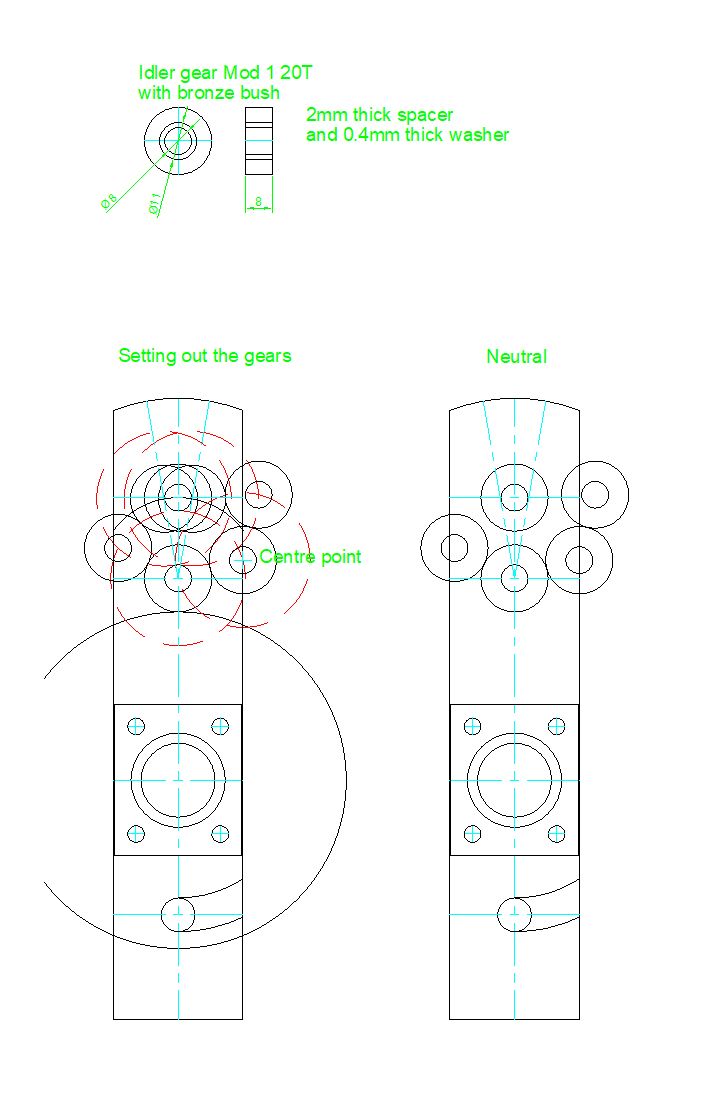

                                          Phil,perhaps you can also post hte picture you have of hte unit on here to make it easier to see that going off to imgur.
                                          The device appears only to be intended for variable feeds, not screwcutting as the spacing fixes the final gear to leadscrew at 100. The picture you have is missing the 20tooth on the stud, which has to be compounded with Z1 in the table. W is the mandrel gear.
                                          Referring to Phil's picture (when available) it shows 4 gears of 20 tooth on a sub plate and a stud on the main plate behind coming through a slot. The sub plate pivots about the gear second from left.
                                          The stud should have a 20 tooth gear meshing with the leftmost gear in this position. When the subplate is pivoted the left gear moves out of mesh and the rightmost gear moves into mesh. The gears are 1 module so separation is 2cm.
                                          The pivot point gear has to mesh with a 100 tooth on the leadscrew (coming through the big hole near the bottom) so that spacing must be 5cm+1cm.
                                          The slot in the bottom is for the clamp so measure from your own lathe.

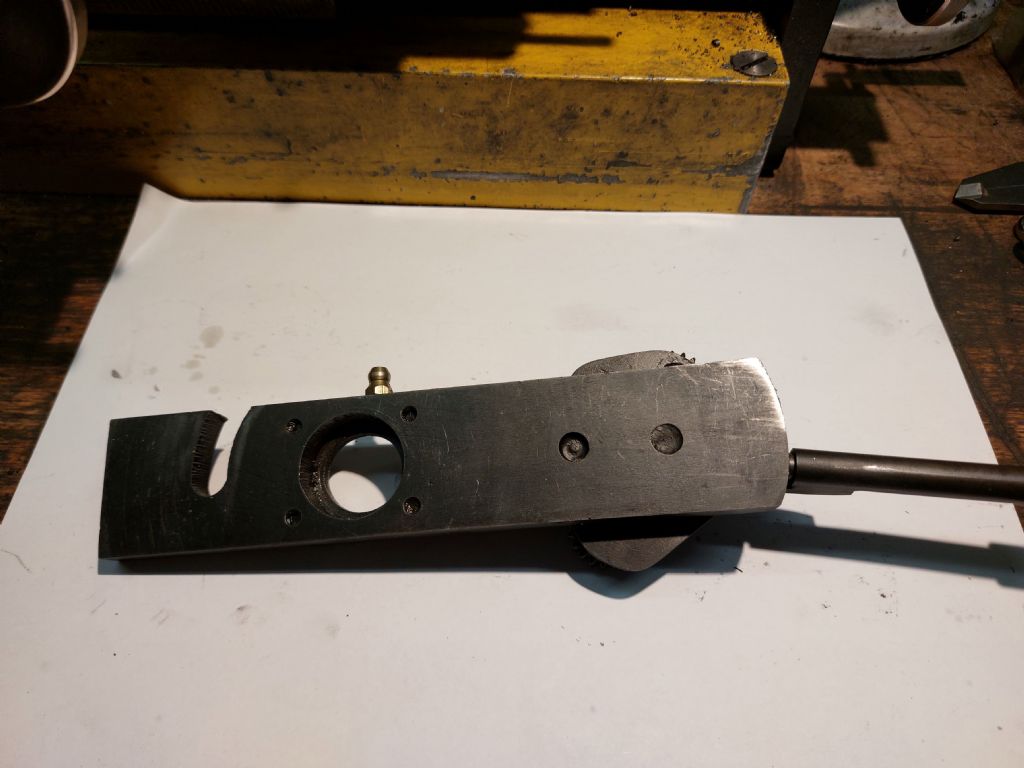

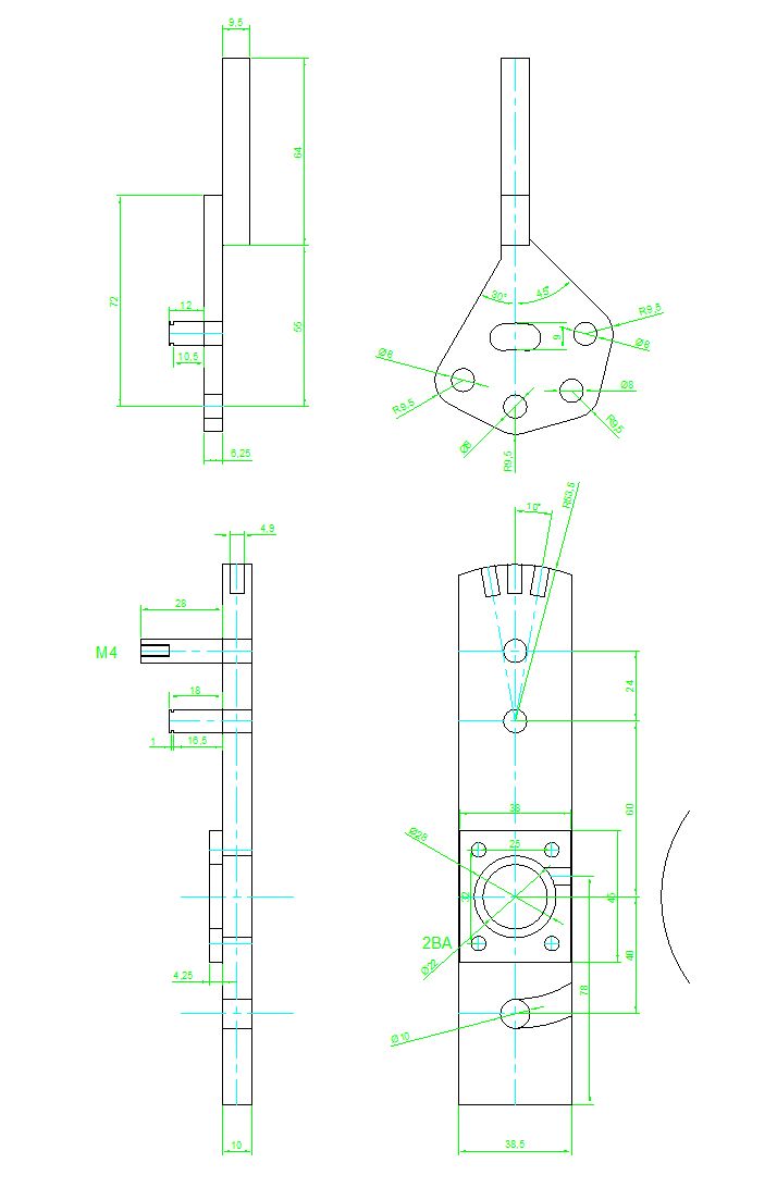

                                              I will try to take some measurements of my tumbler reverse over the next couple of evenings. I don't think that there are many critical dimensions.
                                              #656754
                                              Roger B
                                                @rogerb61624

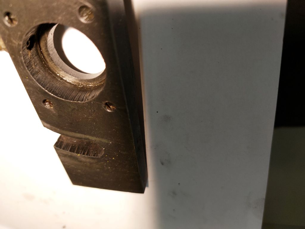

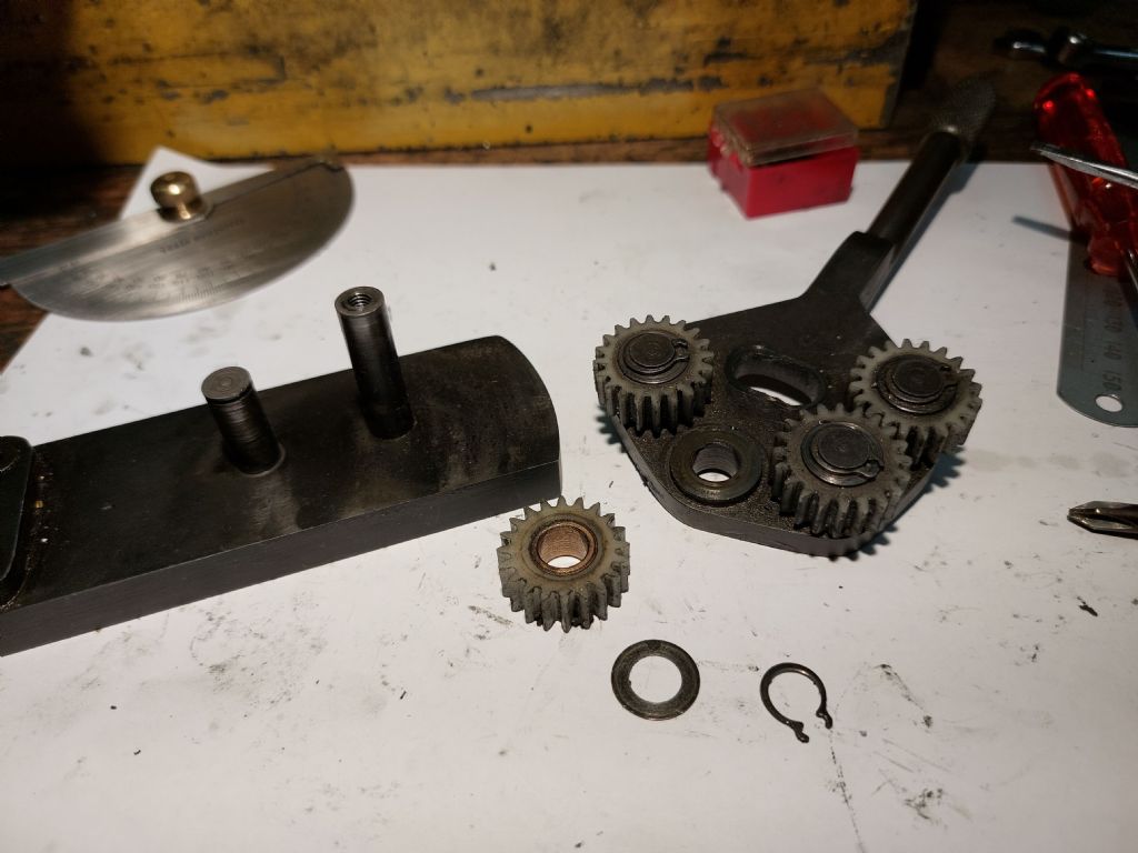

                                                I have dismantled and measured my tumbler reverse and have drawn it in DraftSight but there dosen't seem to be a way to upload a .dwg file.
                                                The various sectors and large holes are quite rough, possibly plasma or water jet cut.
                                                I can send the .dwg by email if requested.

                                                    #656817
                                                    Phil Pemberton
                                                      @philpemberton74433
                                                      Very nice work, Roger!
                                                      Could you please send a copy of the DWG to me at philpem at gmail dot com?
                                                      I'd be happy to host it on my website at https://www.philpem.me.uk/machining/md65 with appropriate credit if you'd like.
