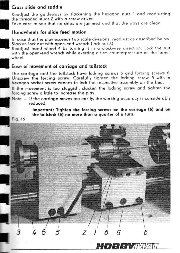

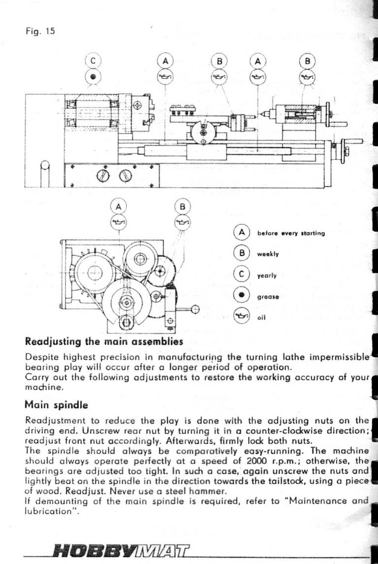

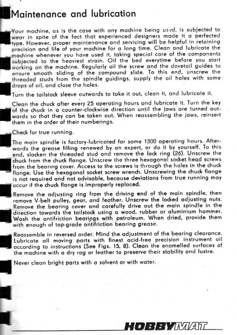

                          Hi Jamie, I assume that there is no dirt or gab etc. between the chuck and the flange on the spindle. I think if you have a bit of 25mm bar 120mm long held just by a normal 3 or 4 jaw chuck and no tailstock support, it is a big ask, as you are only holding by the end of the jaws, assuming you have the normal size ones for a Hobbymatt.
                          Just in case you don't have the information about the spindle bearing preload, below is a scan of the instructions for adjustment.
                          I'm also assuming that the flange has not been unscrewed from the spindle at anytime or during disassembly, as the instructions strongly recommend not too.
                          Regards Nick.

                            Nick, as a matter of interest, do your Clamping & Forcing Screws 5 & 6 actually conform to the last illustration? ..only asking because mine are the opposite way round to that..
                            #445134
                            jamie creighton
                              @jamiecreighton58639
                              mine are too,the middle hex bolt is the forcing one
                              #445135
                              DiogenesII
                                @diogenesii
                                Thanks for clarifying..

                                    Hi DiogenesII, yes mine are exactly as the illustration is, but I believe mine is an early model, which had two slide switches, and the start/stop one was broken alone with that part of plastic laminate plate that held them. I made a new plate from a piece of Aluminium and moved the forward/reverse switch to the start/stop position and fitted a NVR stop/start in the other position. (see below)

                                      Nick – interesting – I've never seen one with those slide switches – they have quite a "Soviet" look to them..

                                        If the flange has been removed and replaced, it may be worth just giving it a very light skim to clean it up, to ensure that the chuck sits on a face that is truly square to the axis.

                                              DiogenesII
                                                @diogenesii
                                                Unplug the machine and remove the collar, pulley, gear, and key.
                                                Loosen the rear locking ring and snug the front ring up until play is eliminated at the front bearing – the bearings should not be under load and the spindle should rotate smoothly.
                                                A bar in the spindle/chuck to act as a lever will enable you to check more easily for sideways movement.
                                                Having achieved this, hold the front ring still with the spanner and tighten the rear ring to lock it – it may take a few goes to get it feeling just right – patience is the key!
                                                Replace the key, gear, pulley etc. and test run the machine – it should run smoothly and freely at 2000 rpm, and without getting hot at the bearings (warm after prolonged running is okay).
                                                If it feels stiff, "notchy," or labouring to reach maximum speed, you will have to go back, loosen the rings, and release the bearing load by tapping the back of the spindle towards the tailstock with something soft, such as a piece of wood. Repeat adjustment until satisfied – it sounds laborious, but doesn't take long and is worth doing carefully because the improvement in the feel of the cutting action and the finish on the work are marked on this small machine.
                                                The photo's provided by Nick include the section regarding adjustment of the spindle bearings, such as they are..
