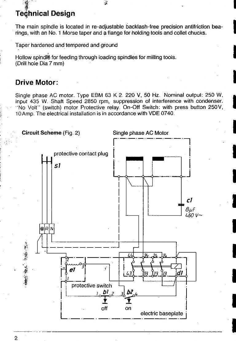

          Hi Chris, this is the only help I can give you.
          Regards Nick

            Suppression of interference with condenser forsooth! Written by a knowledgeable person clearly. Capacitors easily and cheaply available from sources such as CPC Farnell. The motor is probably a standard frame size so a replacement should be easy to source. There are motor rewind companies around that could fix winding problems. If you did decide to replace the motor you could consider a 3 phase type with a small vfd which would be smoother and give you variable speed.

                The Capacitor should be easy because they often have to be replaced on this type of motor. Search for Start/Run Capacitors on the web, they're sold by Farnell, RS, CPC and many others. The spec is in the circuit diagram 8uF, 460Vac. Don't rush to buy one unless the motor can be reassembled, because new motors come with new capacitors. There are firms who rewind and mend electric motors, but the cost is likely to hurt. It's economic to repair big expensive motors, but usually cheaper to replace small ones.
                Finding a replacement motor will be more difficult because the type isn't listed. However, it's single-phase, 220/240v, about 435W (say 1/3HP). Any motor that physically fits the mill between about 1/3 and 1/2HP will do. Might be a standard footprint, possibly not.
                EBM 63 K2 is the maker's part number. There's almost certainly a modern equivalent. I'd start by measuring the layout of the fixing holes etc on the mill. Then look in catalogues for motors that match the fixing; the motor might not electrically correct, but the catalogue may name the fixing standard, which will make searching much easier. EBM are now EBM-Pabst, this is their current catalogue.

                  I believe the motor Frame size is 63 with 250W power output and 2 pole for 2850rpm, as per the list posted by Nick.

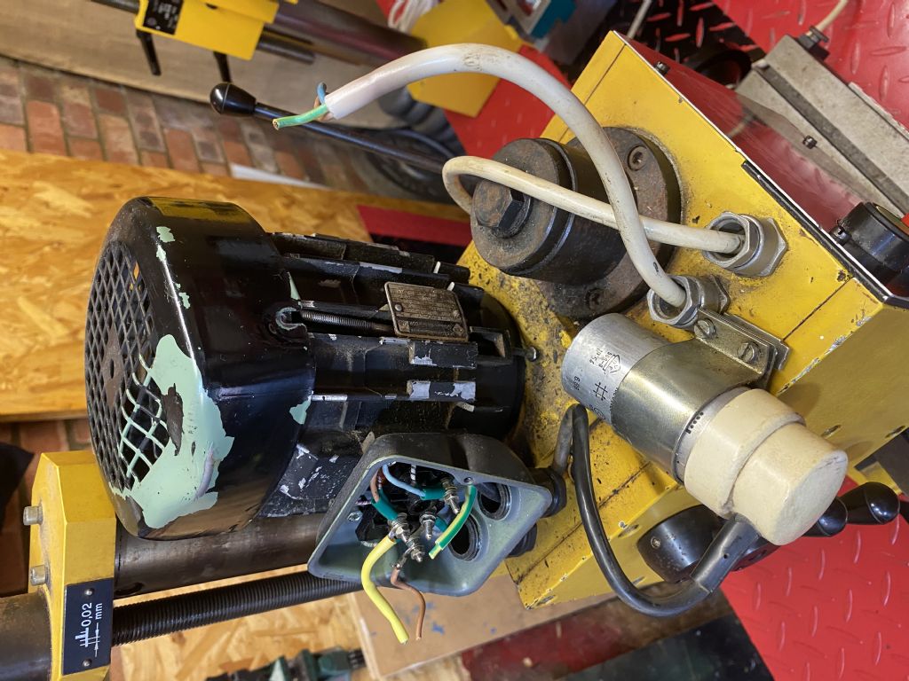

                    Pictures of the BFE65 show a flange mounted motor, so a 63 frame with a B14 flange, 2 pole 250W. Ebay has such an item for around £105 delivered here
                    One point to note is that the original motor had a small connecting box with a remote mounted cap – the modern motors seem to have a large connecting box that contains the cap. Space is rather at a premium at the top of the machine, so a large connecting box may not fit in the space available.

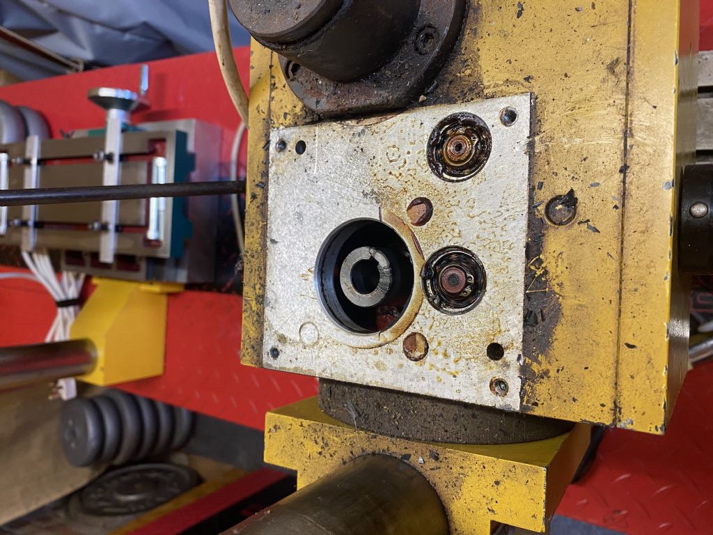

                          I've not physically measured up yet until I discount the OE motor, but ballpark spec this seems to be there abouts. Length of drive spindle looks like an issue. Any views on that other than physical dims? I don't really want/need to go 3ph VFD with this.

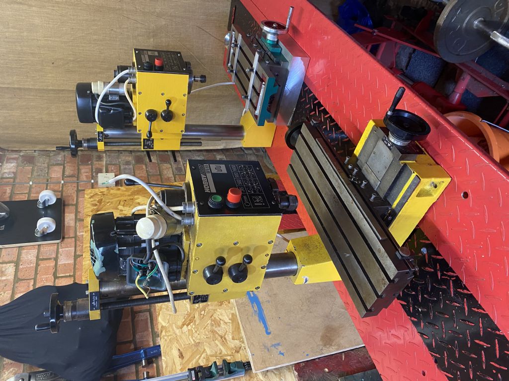

                            Pics !

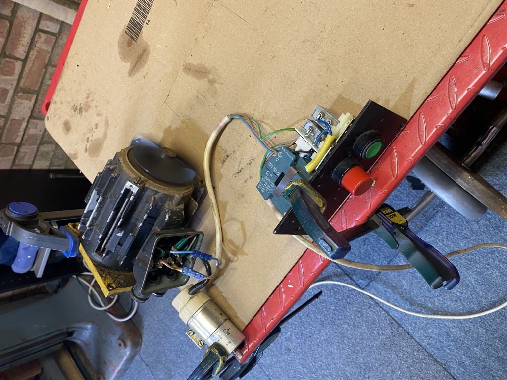

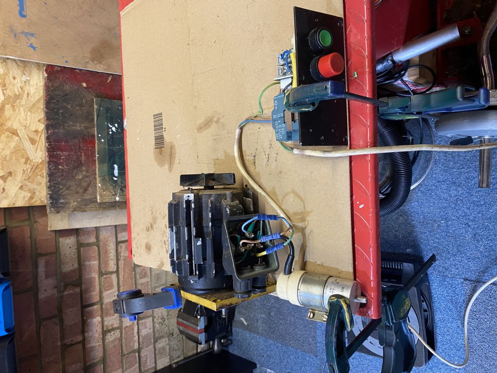

                                Hi Nick, well I'll be blown…
                                Unbolted the motor halfs retaining screws, which were mostly missing their nuts, realigned the motor halves properly, and spinning nicely by hand.
                                Took the NVR switch out of the mill head and temporarily wired it all up (forgive the bodge bench rig)
                                Well it runs on the button very smoothly. I have no idea what the previous guys had been doing, perhaps it blew the plug fuse smiley
                                So a working BFE 65 for £130 – no complaints yes
