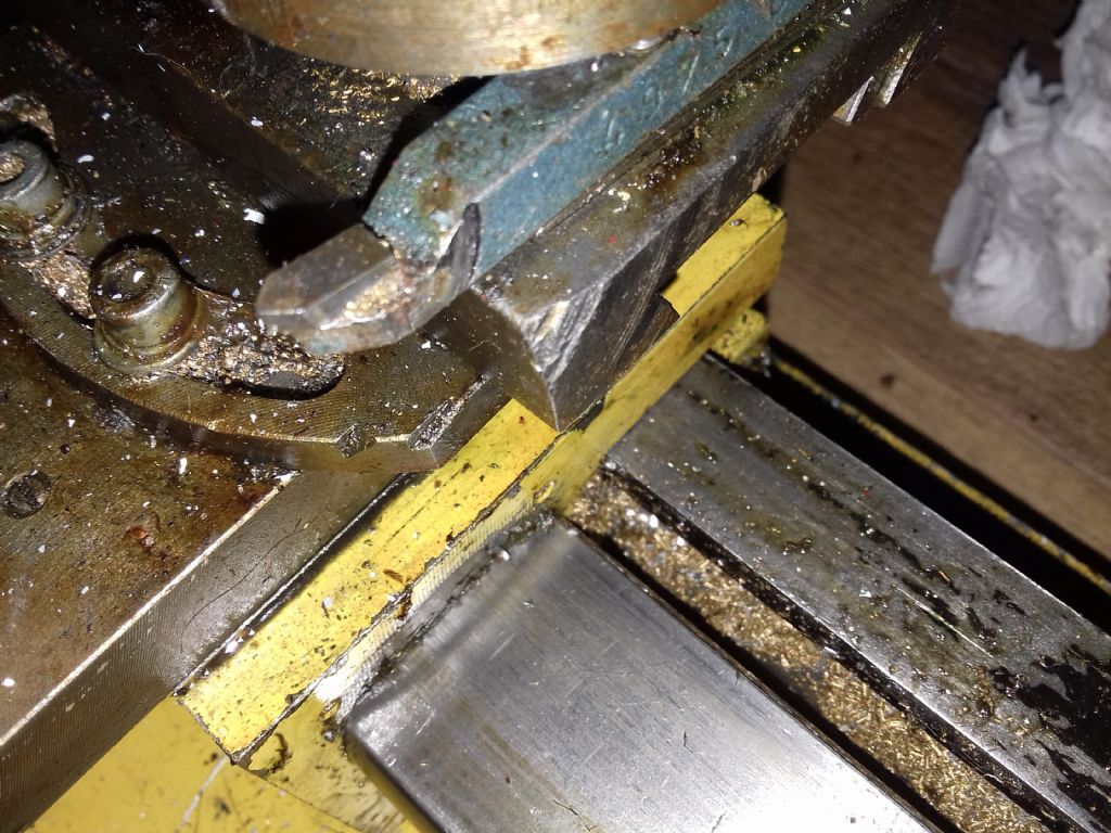

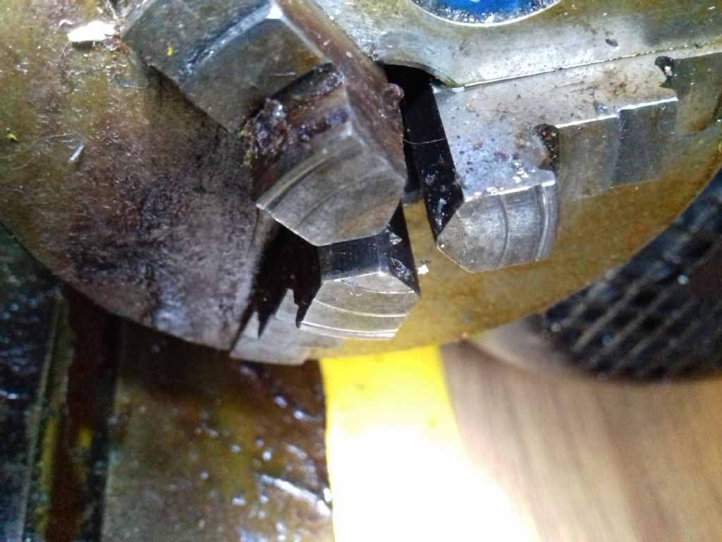

        1. The toolpost has crashed into the chuck while on autofeed and has damaged the side of the toolpost and the surface of the chuck jaws. Is this anything to worry about or just a normal accident?

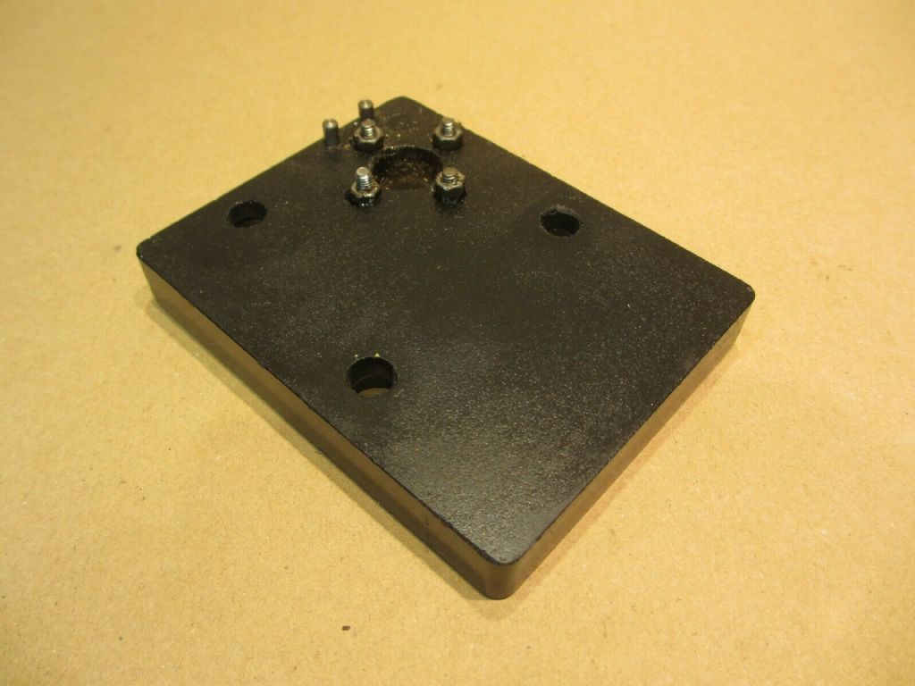

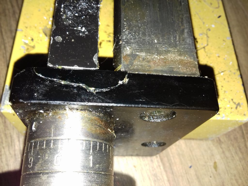

        2. A support piece for the leadscrew seems to be broken. I can not see what the long bar does other than provide some compression support. I have located the part as in the 2nd picture and it seems to be 2 dowels that have torn a chunk of the casing out for some reason. Is it anything to worry about?

          I would say that the damage to the toolpost is minimal. Hopefully the chuck jaws can be cleaned up with a fine file. The outer gripping surface is seldom used and 3 jaw self centering chucks are not high precision components.
          The long rectangular bar is mainly to protect the leadscrew, some people me included, use it to mount travel stops. Hopefully you can repair it with Araldite or similar.
