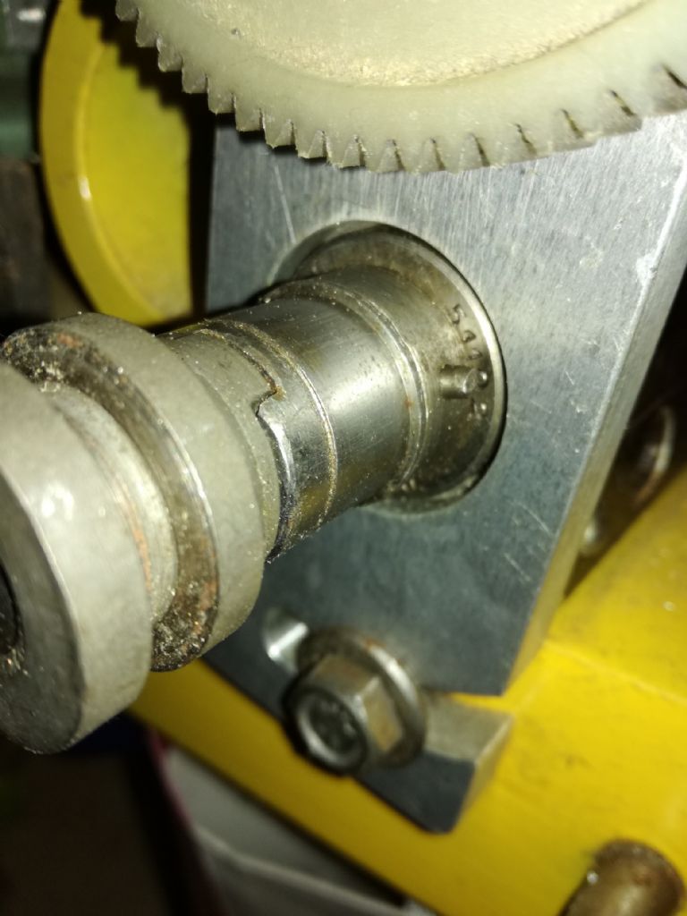

      Good afternoon everybody !
      I ve run in an issue with my recently acquired Hobbymat MD 65. I ve noticed that the leadscrew needs more effort to move on a particular segment of its rotation.
      I also think that while in automatic feed, I get a pattern on stock while cutting, that looks like screwcutting – but I need to buy some new stock to further examine this.
      I have put on some thrust bearings on the right end of the leadscrew, but I haven't machined a recess so they can fit into.
      After a few moments while investigating, I saw that the grooved taper pin – No 28 on the manual, seems to be heavily bent, as well as rubbing on the steel plate – the one on the left end of the leadscrew.
      Is that normal ? Should it be that way ?
      Could someone provide me with some clear photos of that point from a running MD65 so I can further investigate ?
      What else should I check ?

            Pin 28 should be fully 'home' in it's collar, not hanging out. It's purpose is to secure the collar to the leadscrew.
            If it's not too badly damaged, it's okay to straighten it out and replace it – loosen off the nut and handwheel at the R/H end of the leadscrew and the carriage lock first to release any tension.
            Once the pin is back in, re-fit the handwheel loosely (i.e. with ample end-float), and lightly nip up the locknut just to check that the leadscrew turns freely and without binding or rubbing on anything.
            If you can't achieve free rotation at this stage, something else is amiss and will need sorting out.
            Once everything feels free-but-sloppy, turn your attention to adjusting the handwheel to give the minimum of freeplay/backlash/endfloat, but without binding or becoming stiff to turn – it will not be possible to eliminate all backlash because some clearance is necessary for the parts to turn without binding.
            It can be a pain to achieve correct adjustment, but it's worth persevering, and if you must, err on the side of too much freeplay rather than not enough.

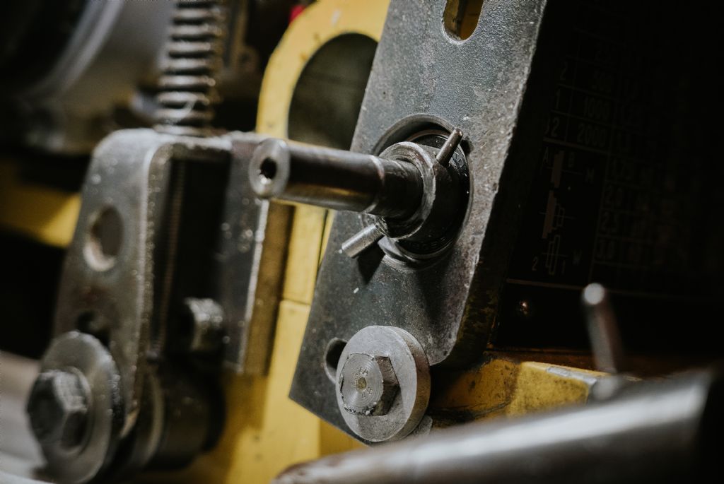

                Hi Harry, no it should not be the way you describe. The tapered pin shouldn't be showing any more than my one shown below and it should be able to be seen no more than the same amount on the other side of the bush- No. 8 on the drawing.
                There shouldn't be a steel plate that the pin can rub on anyway, as there should be an aluminium apron No.1 on page 48 as shown in the above photo that holds change gears.
                Regards Nick.

                  My pin is really huge compared to that on the photo – and therefore really bent while rubbing on the aluminium plate.
                  Will try to take a photo – as well as take the whole thing apart and investigate – and then get back to you.
                  But as I can see, somehow a previour owner really messed up with that part. Hope my leadscrew is still straight and not bent.

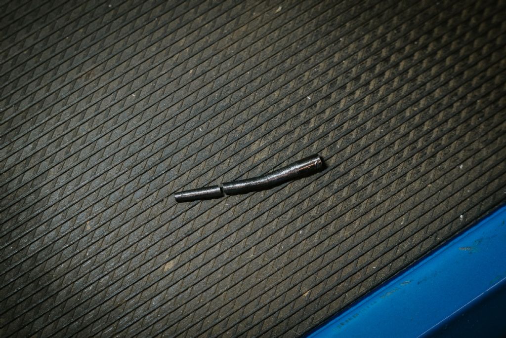

                            So, I started by disassembling the left side of the leadscrew and saw that picture :
                            Went further into disassembly :
                            And :

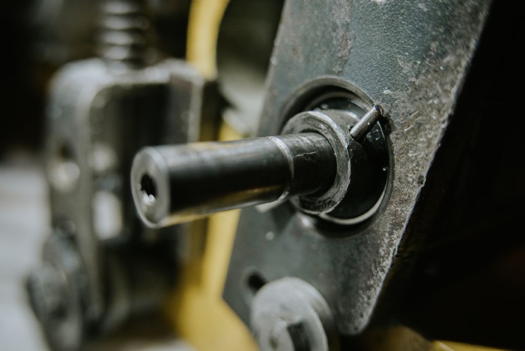

                            As you can see, the pin is really huge compared to what it should be, and it was definitely rubbing on the aluminium apron.
                            Tried to gently straighten the pin so I could get it out and then…

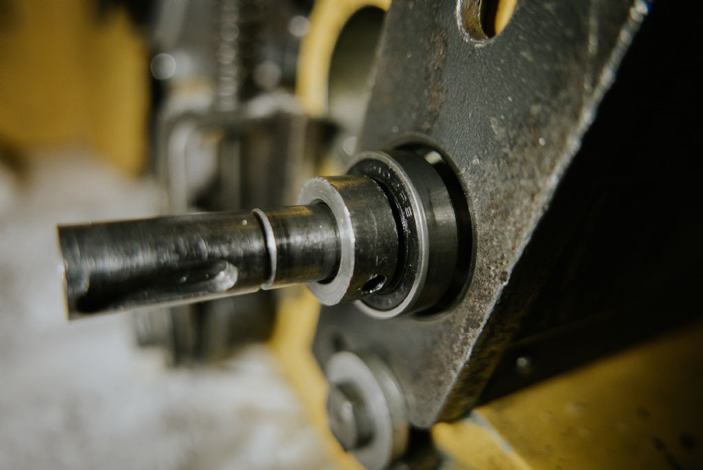

                            So, after a few moments of unscrewing the leadscrew I got there :
                            The ball bearing is definitely not the factory one, so somehow a previous owner has probably messed up with the leadscrew.
                            I also noticed that the bearing should be trashed a bit and when it came off the apron limits the leadscrew started to turn more freely.
                            Is that indicating that the leadscrew is bent – or it's just the bearing that is trashed ?
                            Could someone provide the original bearing dimensions ? Is it a 6902 2RS – That's 15x28x7 in mm.
                            Any more suggestions on what else should I look into ?

                              According to the book, should be a 51102 (15x28X9) ball thrust bearing – try ArcEurotrade;
                              Arc Euro – Thrust Ball Bearings
                              Buy a new 3×18 metric taper pin.
                              Bob's your uncle.
                              See what it's like with the proper bearing in it, hopefully normal action will be restored…

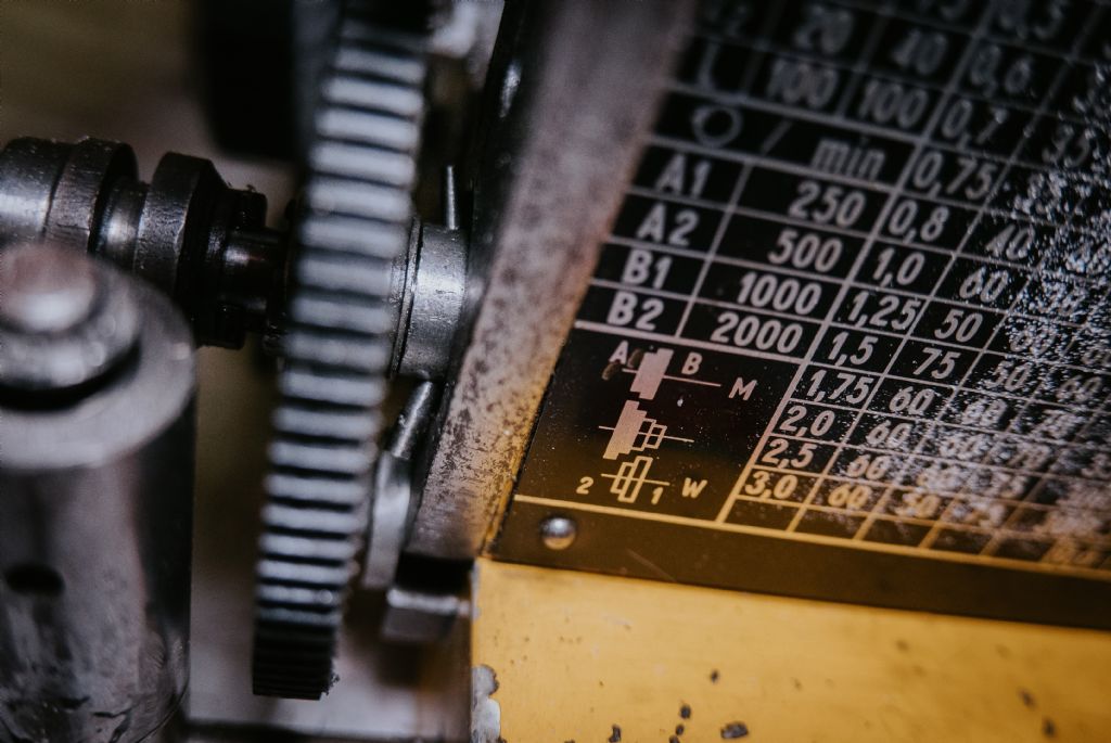

                                  Finally managed to acquire some NSK 51102 thrust ball bearings.
                                  At first, I managed to place the bearing, but the leadscrew kept seizing.
                                  I unbolted everything I could, the leadscrew end collar, the leadscrew nut bolts – but the problem persisted.
                                  Then the aluminium apron caught my eye. I disassembled it and then proceeded to fit it again on the lathe, while putting back on everything else.
                                  Seems to be ok, the gears are much less noisier than before and the leadscrew works fine while on power feed.
                                  Needs some effort while hand cranking but, it's much less than before.
                                  However I managed to do a stupid mistake – I carelessly screwed the grub screw on the carriage (the second one from the right) while the protection collar was a bit extended. Therefore it came in contact with the leadscrew about 2 inches from the far end and managed to strip 1/5 of a thread or so. I know, I should have paid more attention
                                  Would that fault cause any problem in the future ? Hopefully it's at the very end of the leadscrew.
