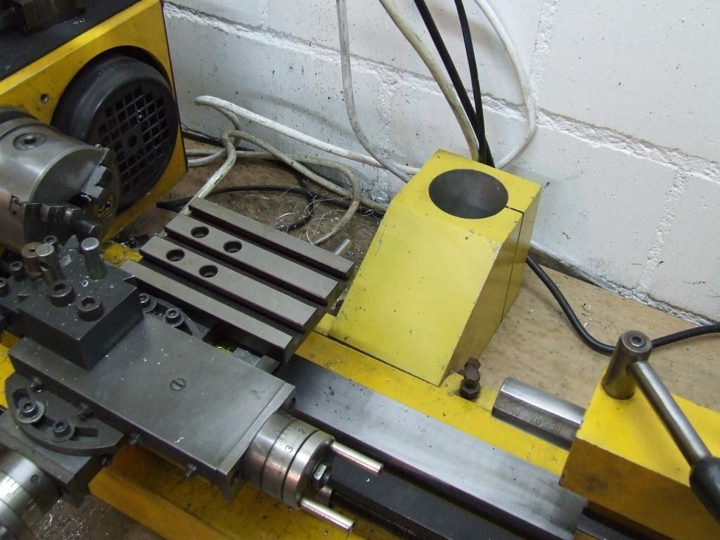

          When new the Hobbymat was supplied with an angle plate (shown here) that allows the compound slide to be mounted vertically on the cross slide so that the lathe can be used for milling. If you have this, or can make one, you might be able to do the precision parts of the job with the lathe and use hand tools for the rest.
          There are some forum posts and photos here showing another fixed steady being made **LINK**

            The lathe I'm buying comes with the angle plate and also a vise (looks also like an original accessory).
            I was wondering how exactly it should be used, I was thinking I'm gonna have to buy a vertical slide to mount on the angle plate, but if I understand you correctly, the compound slide can be mounted on it and basically becomes a vertical slide? The vertical slides I've seen for sale use T-slots to hold the work, but the Hobbymat angle plate has just a few drilled holes in it. Are they for mounting the included vise to hold the work?

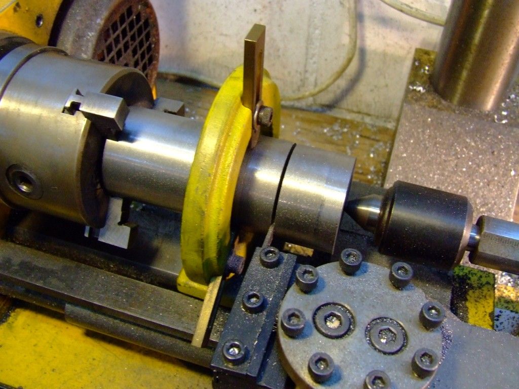

                    Hi Gene here is a photo from my Hobbymat manual, it shows the set up using the angle plate to convert the lathe into a useful milling machine. The top slide is taken off and replaced by the angle plate. Remove the tool post and bolt the vice to the top slide. The top slide and vice is then bolted to the angle plate. All the holes will line up for easy fitment.
                    Ian

                      I understand know, thanks to the picture in the manual, how the angle plate and vise are installed to allow movement along 3 axes, and thus can be used for milling.

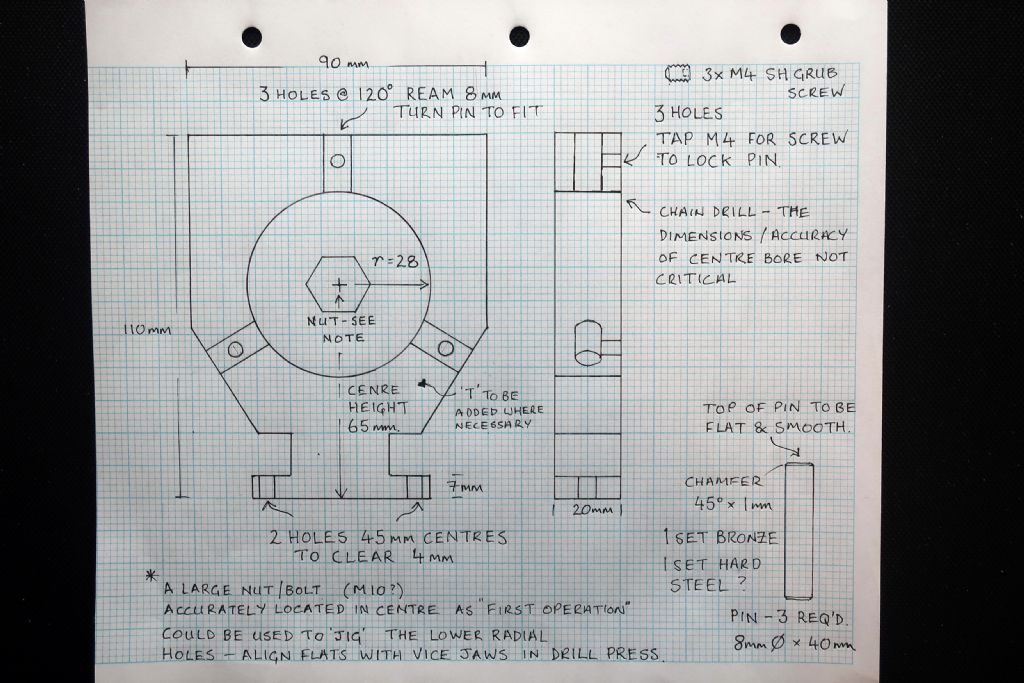

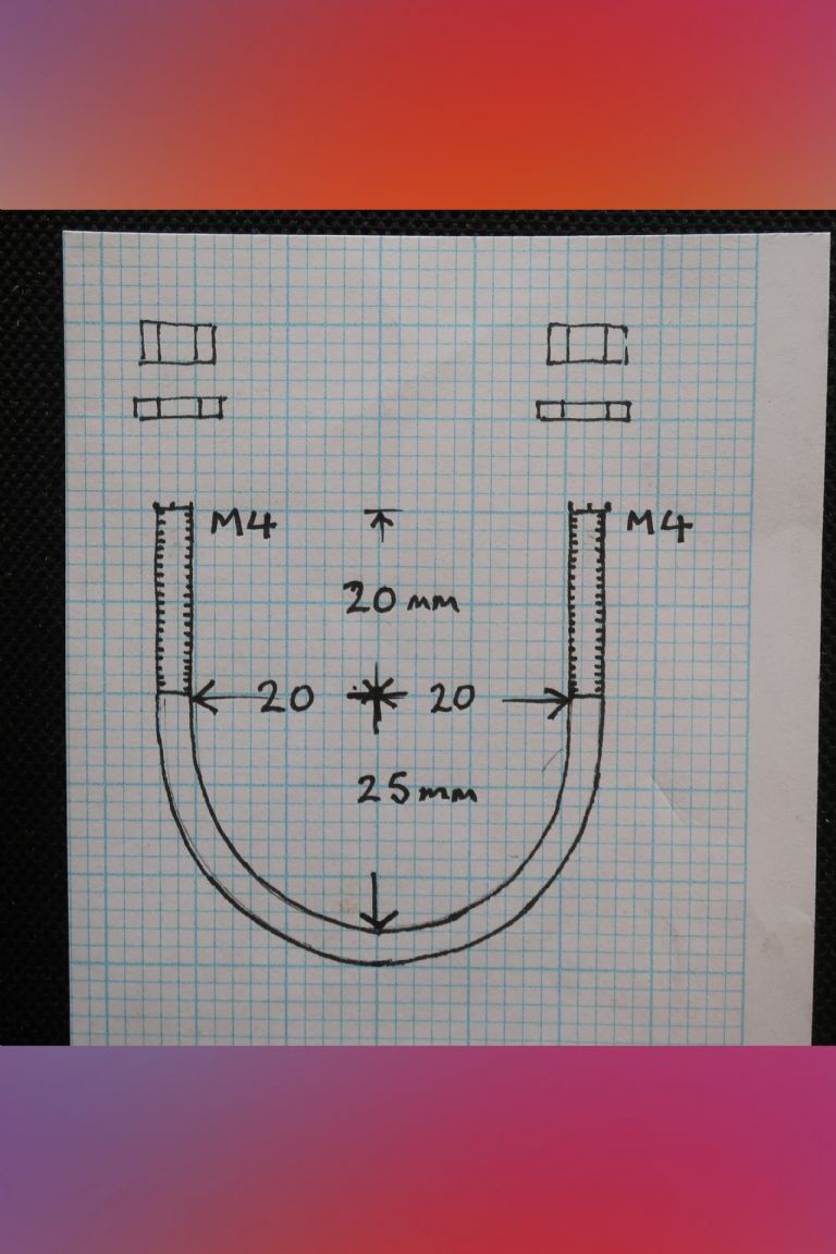

                                  Michael; thanks for the link, the bed stop details most useful..
                                  Gene, aluminium will be fine for the steady, I have one and will photograph/draw as soon as I have time.
                                  It is just a round aluminium casting, lugged and drilled radially with three holes for the pins that support the work, and with a flat "foot" which is secured to the bed with a "U" bolt.. not a very elegant solution, but it works..
                                  The aperture does not have to be bored – depending on the style, most of the body could be made with hand tools if necessary, with only the three holes for the support pins and the flat base requiring accurate drilling or facing, for which they could be clamped to either the top- or cross-slide..
                                  I'll post as soon as I can.. busy for two days, I'll try to steal some time..

                                        DiogenesII
                                          @diogenesii

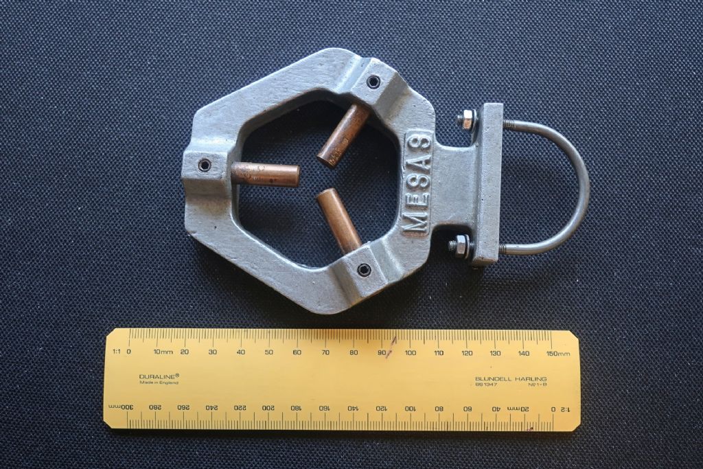

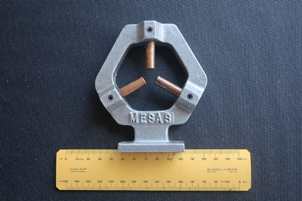

                                          Hi Gene, it sounds like your lathe came with a useful selection of accessories.
                                          The second part of the article in MEW describes the upper part of the steady, it is in issue 217, p.40
                                          Below are some photo's of the Hobbymat-supplied item. It looks flimsy, but I've never had any problems using it. Also a quick dimensioned sketch made with a view to hacking one out of a piece of 110x90x20 aluminium plate with hand tools and drill press – apologies for it not being a more formal drawing, I hope most of the essential details are clear..
                                          #446461

                                            Dear Diogenes,
                                            Thanks a lot for your drawings and the photos. I see you put a lot of care into there, I really appreciate it.
                                            I will check the MEW issue you mentioned, as well.

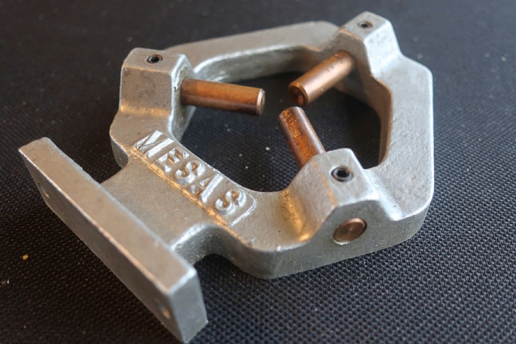

                                              Hi Diogenes
                                              That steady bears the MESAS logo who were a Model Engineering Supplies and Services firm based up north so perhaps the steady was built from 1 of their kits.
                                              Emgee
                                              #446497
                                              DiogenesII
                                                @diogenesii
                                                Emgee, thanks for the correction, I should have researched – now I think of it, I'm not sure I've ever seen one that was made by Prazi.. would love to know if anyone has.. The one illustrated seems to be the most common pattern in the UK.
                                                It'd be an easy casting job, being open moulded..

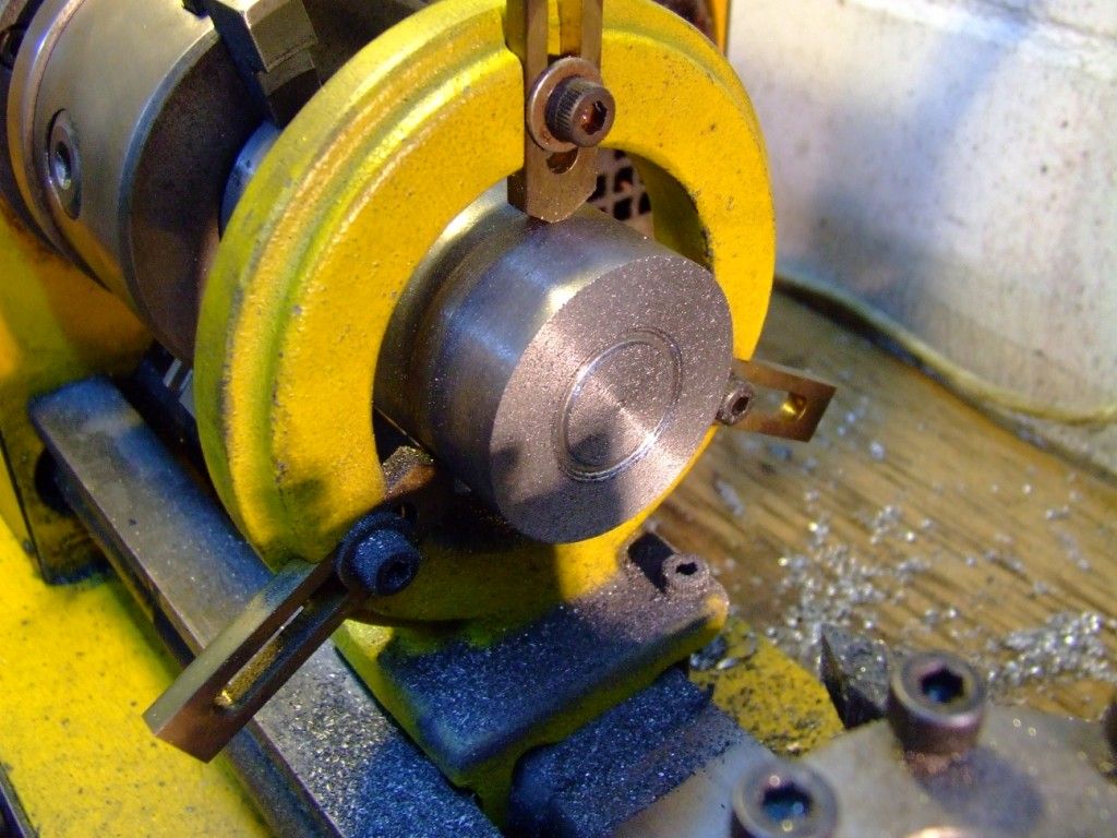

                                                  @rogerb61624
                                                  I believe that this is a Prazi fixed steady. Not the best of pictures but the real thing is inaccessable at the moment due to a workshop move.
                                                  Fixed steady 2
                                                  Fixed steady 1
                                                  #446556
                                                  DiogenesII
                                                    @diogenesii
                                                    Thanks, Roger, certainly looks a much more rigid set-up than the MESAS one.
                                                    Now there will be two of us looking for one…

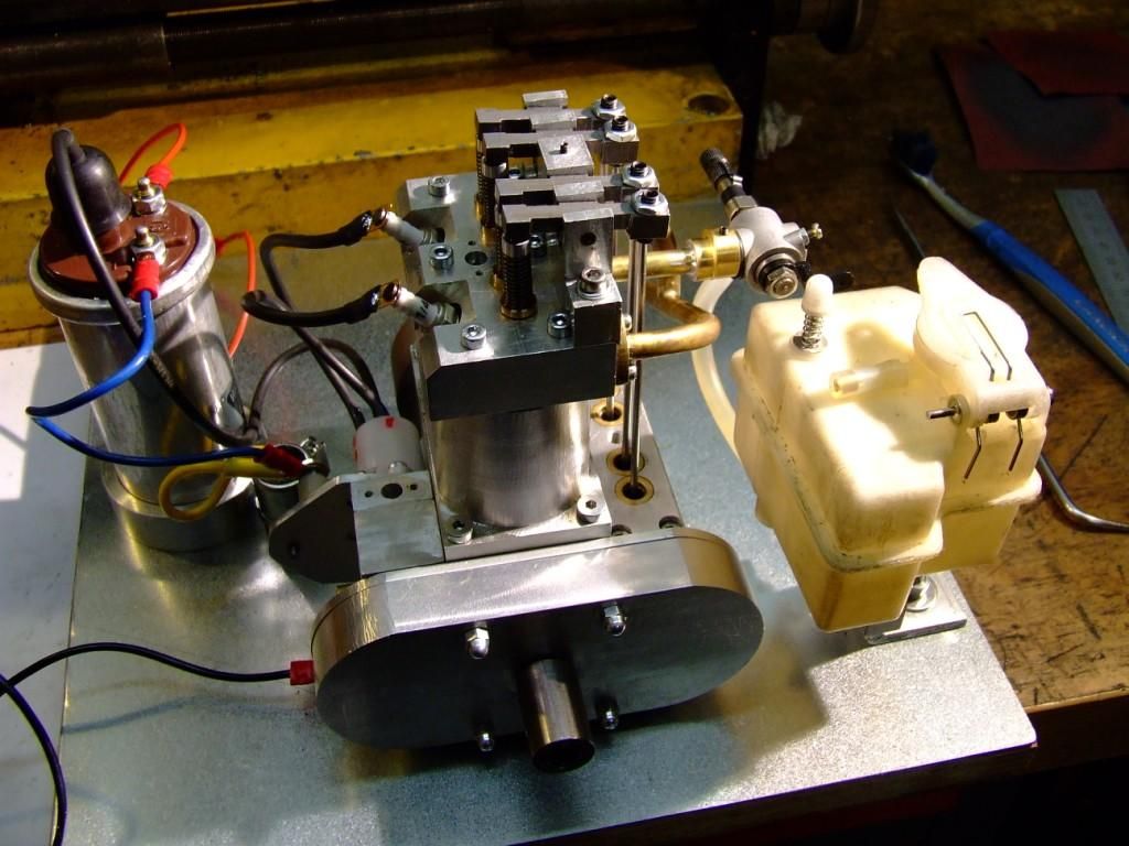

                                                      I like you have very limited space for a workshop and have the milling head on my MD65. This was purchased new from TECO, my secondhand lathe already had the adaptor block.
                                                      Support for milling head
                                                      It is not as rigid as a dedicated milling machine however I have made several working IC engines with it.
                                                      Two cylinder engine
