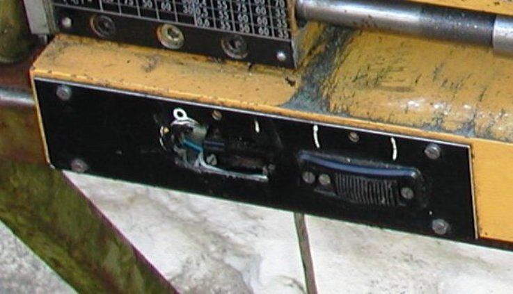

        Hi Modellers, I'm new to this forum and joined to get help with my newly purchased MD65 hobbymini lathe. The model I purchased is a classic yellow east german original. I have just started rejuvenating it and have found that BOTH rotary panel switches (On/Off and Reverse direction switches) have had-it!
        So, I just wondered if any of you kind and knowledgeable folks could point me in the right direction to finding a replacement new pair of rotary switches for the beast?? All help would be appreciated. My searches on the internet have not been fruitful so far.

          You can often get spares for the Hobbymat on that well known auction site – BUT – beware that prices can be higher than you may wish to pay.
          There is no need for the switches to be of the rotary type – toggle switches would work just as well as long as you ensure that you can't accidentally toggle them when you don't mean to! some sort of simple cover should do the necessary.

              Hi Christopher, when I bought my Hobbymat, the on/off was busted and so was the Formica type plate the switches were mounted on.switches.jpg
              These were both slide switches not the rotary ones, but the forward/reverse switch was OK, but I replaced the on/off switch with NVR start stop switch, made a new plate and in good old Blue Peter style, covered it with sticky black plastic. The NVR makes it safe in the event of a power cut or the plug top fuse blowing.
              Switch Plate 2
              You can view more photos of my refurb in my Hobbymat Album and there is a wiring diagram there too, if you need one. Yes you can use a suitable DPDT toggle switch for the reverse switch.

                I would also recommend installing start stop buttons to give a no volt release as were fitted to the latter machines.

                  Get the type of NVR switch that has an extra terminal (yes costs a little more) to allow an additional emergency stop button to be fitted, If you read all the posts from the last ten days you will find a thread about this giving a wiring diagram. I can' t remember the title of the thread.
