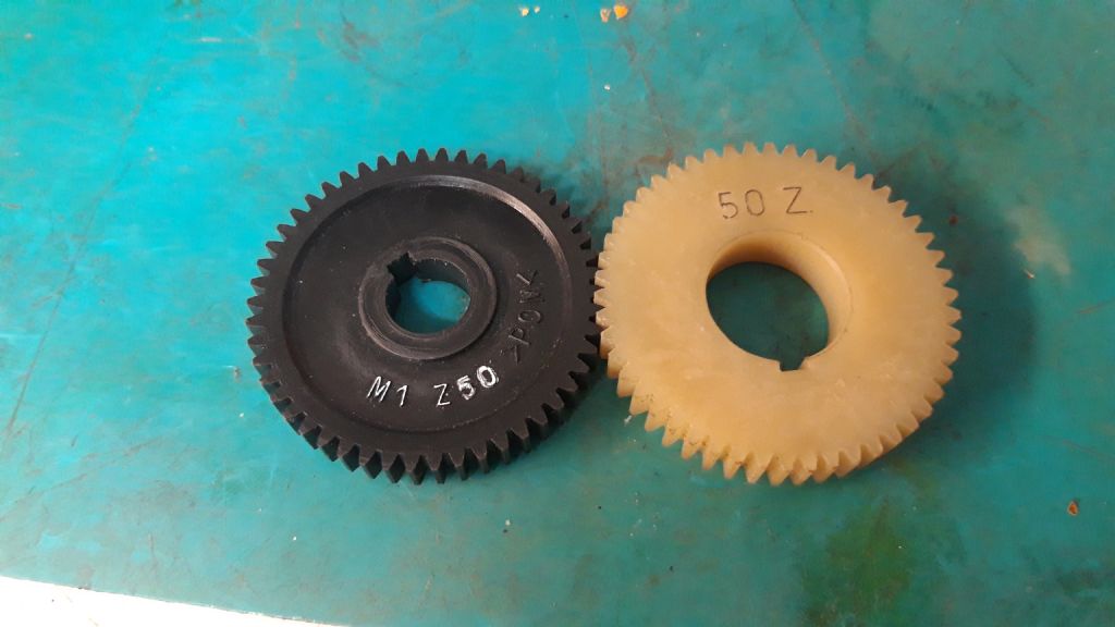

                      The gears appear to be 1.0 MOD, are 10mm thick, and have a 20mm bore which is slotted to accommodate a 4mm key.
                      (50T gear=52mm OD, 60T=62mm, 70T=72mm, = 1mm of PD per tooth plus the addendum (= to mod) on each side).
                      I can't establish the pressure angle exactly from my worn examples, but 20 degrees seems the most likely to me – it's a "modern" metric machine made in Europe, for those not familiar with it – additional informed comment or confirmation would be very welcome, here.. (..although if you are going to get a set printed, it's rather immaterial in any case, as long as they are all the same.).
                      You will need; 20, 30, 35, 40, 50, 55, two 60's, 65, 70, 75, and 100, if you want every option listed on the plate. Even for common metric threads you will still need 30, 35, 40, 50, two 60's, 70, 75 & 100. A 20 is "nice-to-have" for a fine finishing feed.

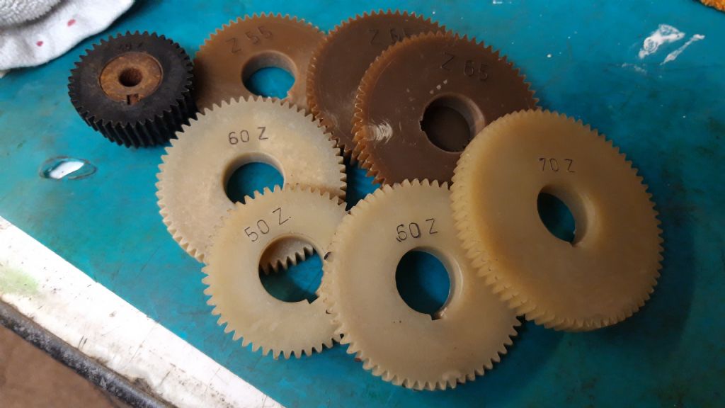

                          Hi Chris, the Hobbymat is a very capable and accurate lathe.
                          The photo shows my change wheels for my Hobbymat, which is the same model as yours, if you do get the urge to screw cut this is the set you will need. I haven't shown the change wheels which are on the machine because it is under cover in the shed, but they should be the same as yours.
                          That three jaw chuck by the way is probably one of the best quality chucks around, hope you find the outside jaws for it.

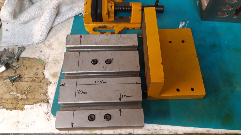

                                    Oh! nearly forgot here is a photo of the tee slotted plate, hope you can make out the dimensions
                                    Ian

                                      What gears are you missing Chris? If you can get some delrin and cut the blanks I'll put the teeth on them for you no problem. They'll work just fine with the ones you have and be a good bit stronger I expect.

                                        The 20T gear carrier comprises a simple stepped cylinder 21.7mm long. The central bore is 8mm (ream if possible).
                                        The larger part of the component has a diameter of c.19.98mm (light push fit for a 20mm bore) and is 10.2mm long. It has 4mm wide key slot, 2.6mm deep (which could be formed by hacksaw and file if necessary – aim for perfection, but settle for adequate – it doesn't run at high speed or take a great load, and mates with a moulded component).
                                        The reduced part that carries the 20T gear is c.13.6 to 13.7mm in diameter (mine is firmly fixed and I'm not going to prise it off!), the dimension isn't critical as the gear is permanently affixed by pressing onto the carrier, so make matched components – aim for a fit that requires say, light vise- rather than finger- pressure, but without "stretching" the gear too much – again, a tiny inaccuracy here isn't the end of the world as running clearance is established whilst setting up the gear train in any case. If one could arrange a parallel knurl, this would be exactly the job for which that process is intended, but failing that any knurl would probably do.. An adhesive might do, but I'm not sure that all are effective on plastics – advice welcome!
                                        The gear should be 11mm thick, leaving 0.5mm of the carrier projecting beyond the face to provide axial clearance for the gear once the carrier is secured to the stud with it's screw & washer.
                                        Both outer edges and the ends of the internal bore should be generously chamfered, for ease of fitting, to reduce friction, and to allow the ingress of oil.
                                        In order to cut the blanks for any of these 1Mod gears, simply take the number of teeth required and add 2 to arrive at the finished diameter in mm – thus 30T = 32mm, 60T=62mm, 100T=102mm etc. With the exception of the 20, which is 11mm, all the others are 10mm thick.
                                        I'd get a piece of Leaded ("free-machining" Bright Mild Steel Round Bar (EN1APb) for this job (I note the standard item is "soft", probably to save wear on the studs), and it's an exceptionally pleasing material to work with.

                                          As these are just hobby lathe change gears IMO t'aint worth the cost and effort of making them in metal.
                                          option 1 the hard way – as you suggest, purchase a set of nylon minilathe gears – bore and bushed to suit but the bushing will need to be keyed to the bore in the gear. You wont get the whole range, but most of them. you could start just with the few common threads you think you are likely to use.
                                          option2 my lazy way – acquire a cheap 3d printer, download a set of minilathe gears STLs from thingiverse, ,modify them to suit in Tinkercad and print whatever you want. You will suddenly find a myriad other things to print such as soft over jaws, chuck spiders, nudgers, dial clamps, angle gauges, micrometer holders etc etc too many to list as they say.
                                            Ian
                                            Hi Ian, thanks a lot for this, the dims are perfect but could you advise on depth before I order the plate please? I am guessing 20mm? – many thanks in advance!

                                              Hi Pete, that would be great and really good of you. I have added up from lathes uk that a full set of gears would be well over £200 and actually they don't have them all. For the the bigger wheels its all 8mm.
                                              A slab of delrin 1000m x 125 is a 1/4 of that cost but I need to work out (get the boy) to cut the blanks, if I can get him t commit I will order the delrin yes

                                                    Hi Chris the plate is actually 27mm thick, but I don't think it matters too much how thick it is.
                                                    Bazyle makes some good points about machining the existing boss / bosses on the hobbymat to suit the mini lathe (or similar) change wheels. And a flat plate drilled and tapped to suit your equipment is also a good idea.
                                                    But if you are going to machine new wheels from blanks, a piece of 10mm thick Acetal sheet (or Delrin) 700mm x 90mm should provide enough material for all the change wheels in my photo. It's easily sawn into square pieces and will give enough extra to trepan out the discs for the wheels. This doesn't include the ones fitted on your lathe.
                                                    And a piece that size will cost about £17 + postage (UK)
