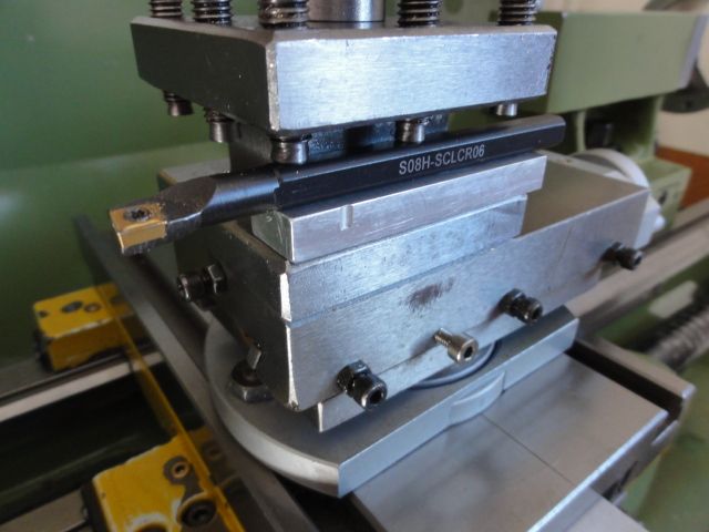

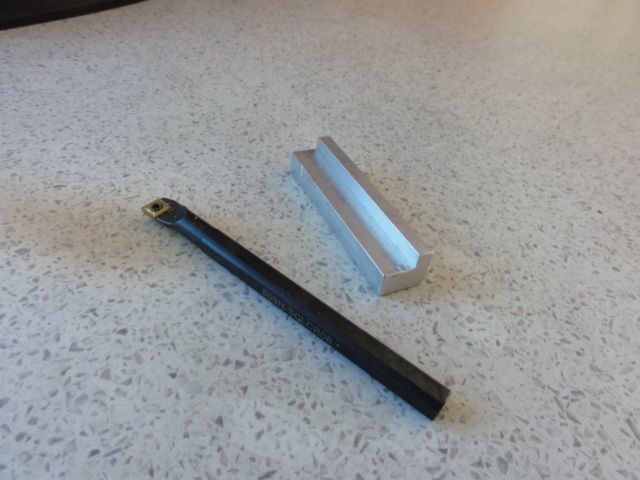

                          I use a Tangential Tool from Eccentric Engineering (advertisement to the right of this page) for the vast majority of my lathework and have done since the very early days of my modelling "career". No shims required and sharpening HSS bits is easy using the jig supplied.
                          For my small boring bar I made an aluminium carrier which is kept with the bar ready for use.
                          On the odd occasion I need shims I use metal packaging strapping and, for fine adjustments, cut up drink cans.
                          Jim
                          Edited By Jim Nic on 13/09/2018 10:24:45
