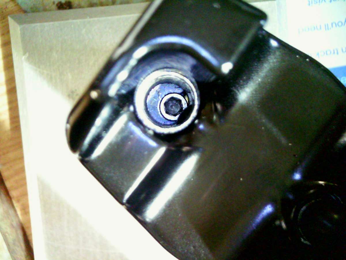

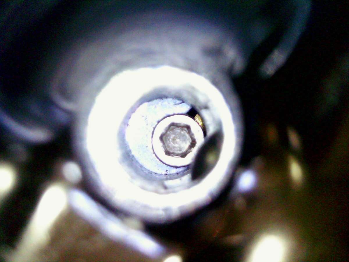

      I need to undo a hex socket screw but cannot find a hex key that fits. A 3mm key is slightly too big and a 7/64″ is too small. Are there any other sizes?

                The screw is at the bottom of, basically, a well. It’s actually a Master 6321 padlock. I managed to get a couple of photos with a rather cheap digital microscope.
                I’ve tried two different makes of hex keys with the same result.
                vlcsnap-2024-01-03-14h47m55s485vlcsnap-2024-01-03-14h44m59s339
                      That looks like Torx (or similar) to me – note the curved edges at the base of the of the “hex”

                        Masterlocks site say to use a 7/64th key, is yours worn or undersize? Page 4

                          Well… It looks like I’ve been on a wild-goose-chase. It seems that my 7/64″ key was miss-sized. I should have realised that Master, being an American company, uses Imperial sizes. I spent a few minutes with a diamond file and converted an old 3mm key until it fitted. The lock is now ready for gutting.
