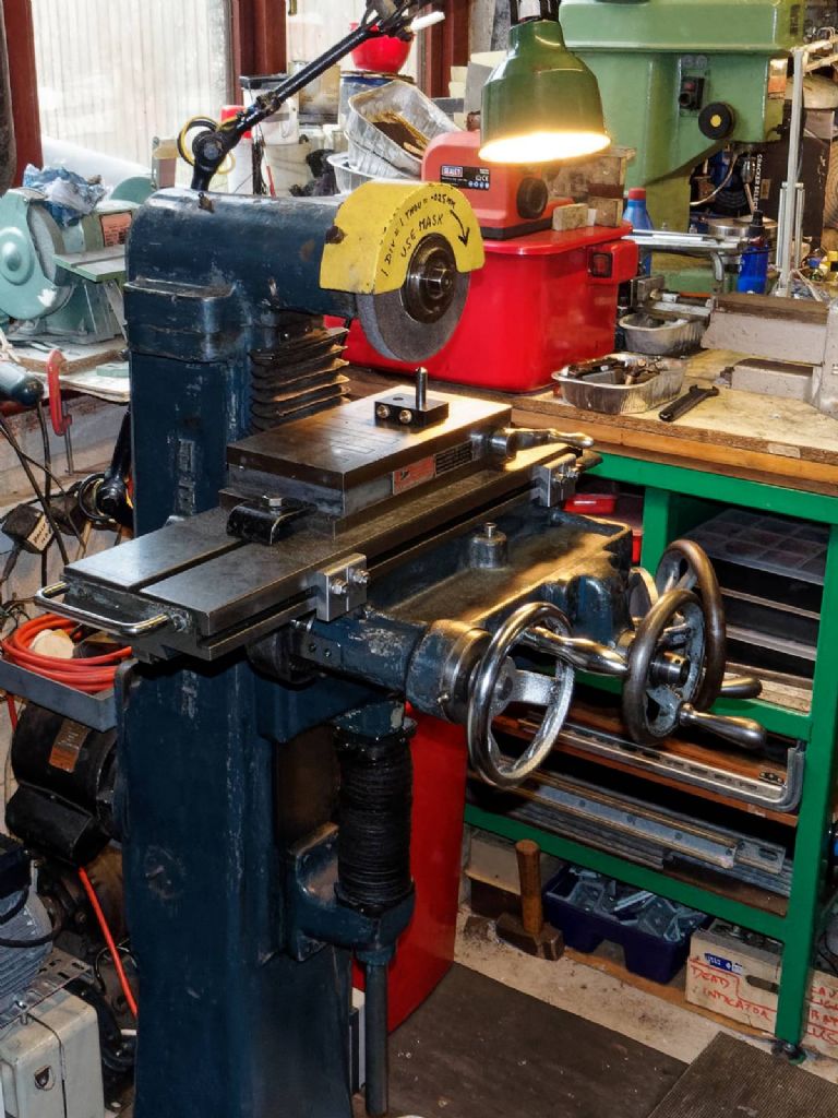

      I picked up a slightly tatty one of these a month or so ago, and knowing that several folks on here have one themselves; I was wondering, does anyone have a manual for it. The only one I can find on the net is on a file sharing site, which needs a credit card for access.
      Currently I've got it stripped and am gradually cleaning it to see if I can get by with the level of wear; I know I'm going to have to shim the tapered gib key on the vertical motion, but have the stuff to do that. I may need a thicker key on the table as well.
      I completed the re-wiring yesterday, but was rather delayed by the lack of a contactor behind the switch cover. In its place was a Tupperware box containing a variety of live ammunition. surprise
      Some .22, 7.62mm, 9mm, 12 bore and 410, along with a load of nail gun cartridges. All are now handed in to the local police station.
      It did come with a magnetic chuck, but just too big to re-face on the machine itself, as it's 10"x5" and the grinder only has 4" X travel.
      Also Tony's site claims a Y travel of 10", which the rack under the table would just about permit. The motion is controlled by a lever, which interferes with the X handle, and limits travel to about 7 ½", which is too short for my planer blades.
      I was thinking of replacing the lever with a normal three spoked hand wheel; any thoughts??

                    Probably time for a bit of an update on this one.
                    I never did find a manual, so like all good engineers, I stripped it to find out how it worked. wink
                    It turned out to be so worn in the slides as to be more or less unusable for anything precision, though it might have sharpened a scythe OK with the amount of "banana" wear in the main table's movement.
                    It it's of interest to anyone, there's a couple of photo albums (both the same) with annotated pictures on
                    Facebook HERE
                    https://www.facebook.com/peak4/media_set?set=a.10216842822810830&type=3
                    and on
                    Flickr HERE
                    https://www.flickr.com/photos/peak4/albums/72157715281085636
                    This one has higher resolution photos than the facebook album.
                    Also the Flickr album should have a slide show facility at the top right, but you'd miss out on the photo descriptions, which with so many photos might actually be a good thing.
                    There's probably far too many photos, mainly of the various setups for measurement and machining.
                    I hope they might provide use or interest for someone considering attempting a similar job, as the methods I used will apply to many machine tools.
                    Note that it's not intended as instructions, as I've never been taught how you are supposed to approach this type of work, and I'd never scraped anything before.
                    First job was to make a scraper, and then chop a piece of cast iron to make a straight edge; it became more and more time consuming from then on, but filled the lockdown time nicely.
                    It does however show that even someone like me, with no training, and little experience of machine tool re-building, can achieve a vaguely passable result; I hope it will provide a bit of inspiration for someone else to have a go.
                    Quite happy to answer any questions.
                    In the end it was probably worth it, though certainly not cost/time effective.
                    Maybe I should strip and paint it now.
                    The first job I've done, other than roughly re-finishing the mag chuck, was to make some end/side plates for the chuck.
                    I was quite pleased that they have come out about 1½ tenths over 10" length (0.004mm over 250mm), though they are only a bit under 1" wide.
                    Still awaiting a more appropriate wheel to complete re-surfacing the chuck; I'm using a spare 6" offhand grinder wheel at the moment until the courier turns up. The surface finish certainly shows some fine "bounce" marks from the wheel, but whether this is due to an inappropriate wheel, lack of balancing, or shot spindle bearings, I'm not sure.
                    Any thoughts on the best way to re-finish a 5" wide chuck with only 4" cross travel??
                    The only options I can see, are to use a wider wheel of 1"+ or move the chuck on the table.
                    The machine has an official wheel capacity of 6" x ¾" x 1¼" and only a ½HP motor, which struggles at much more than a ¼ thou full width pass; the vertical adjustment only has 1 thou divisions.
                    Bill

                          I have the same machine, could not find a manual anywhere.
                          Its a great little tool and gives a good finish.
                          Mine has the one shot lubrication system on it so not as worn as it could be.
                          I sharpen horizontal milling cutters using a pair of centres and a mandrel with a basic indexing finger.
                          Mick
                          #489059
                          peak4
                            @peak4
                            Posted by Plasma on 03/08/2020 19:22:48:
                            Mick
                            Cheers Mick, what wheels are you using, and have you found a source at a reasonable price please.
                            The finish on this one is certainly showing an element of wheel bounce, so I'm not sure if it's a wheel issue, or main spindle bearings.
                            Have you had the top end of yours apart?
                            Any thoughts on the best way to re-grind the 5" wide chuck?
                            I'm fortunate enough to have a Clarkson grinder as well for the tool sharpening, which came out of one of Arthur's Skips years ago.
                            We used to be neighbours in Sheffield.
                            David, Yes I do have a box on the end, though only a temporary wooden one at the moment.
                            The plan is to make something better, that slots into that little chrome handle, and then couple it up to an old Aquavac to keep the dust down (particularly when dressing wheels).
                            Bill
