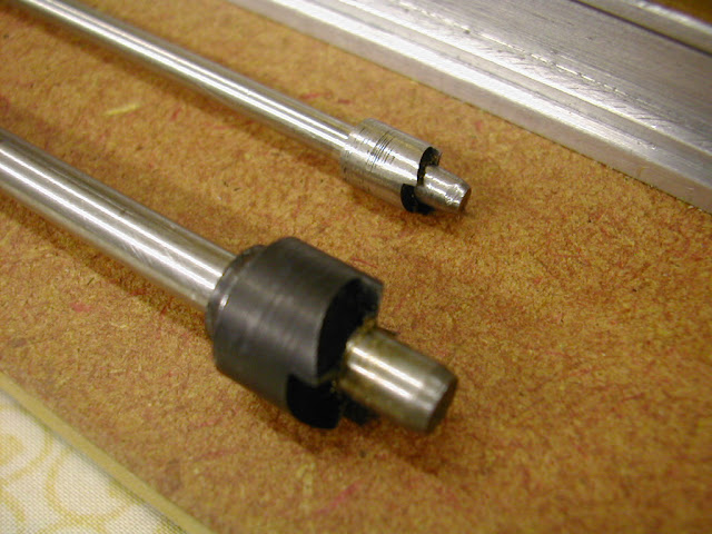

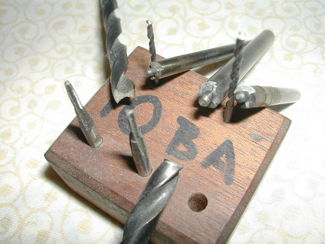

              ‘Flat bottoming’ a drill is one way but if it’s the only drill you have its a pain to keep resharpening a new point on but it will get you by. It’s good advice then to have some spare drills as Martin says.
               I have several kept for this purpose but only use them to flat bottom the hole that has previously been drilled with the correct (counterbore diam) size drill nearly down to depth. A flat bottomed drill has nothing to guide or centralise it – this way ensures it and it is used only to take out the ‘slope’ at the bottom of the hole. A slot drill has one side ground ‘over centre’ – there is no need to recreate that on a FB  drill, just grind the angles as suggested to the approx centre – there is no material under it to be cut anyway.
              Another way is to use a FC3 cutter of the nearest size  – enough clarance with a 5.5mm? Either in a holder or in the drill chuck – nothing wrong with the latter as long as you use it as a drill.
              And of course you can make one from silver steel – turn the diameter you need for long enough to suit the job, Drill for a pin which is slightly smaller than the clearance drill diameter for about 1/2 deep. Turn a pin to fit this hole and which will protrude about 3/16. Set the part vertically in a vice and using a three cornered file cut some teeth – they dont have to be perfectly divided but make sure they point the right way though. Three are ideal – the less teeth you cut the deeper they are and the less quickly they will clog. Harden out  and temper and do the same with the pin then fit the pin with Loctite.
              Keep the revs well down and use coolant – this will cut a counterbore from solid (with the previously drilled bolt clearance hole in of course) on most materials as long as you retract continually to clear the chips which as said will clog quite quickly.
              I’ve taken this pic of some – not very good but it should give you an idea.
              hope this helps as well
              Regards – Ramon

                              Hi Ramon,
                              Of course I agree with you.  The D bit does have it’s limitations.  I wouldn’t produce a spotface and yes you would have to drill a hole close to size, in fact for a counterbore it should be on size, that’s just what I said, it would just be used to flatten the bottom of a pre drilled hole.  But they are so simple to make and work so well I don’t see a problem, I’ve made and used them for years and if good old GHT used them that’s good enough for me.  And they can be made with just a file and a heat source to heat treat them.
                              I wouldn’t personally use a counterbore with small cutting edges, they just clog up too fast and it can be a slow process drilling the hole with one ad I’m too impatient I’d ruin it.  However by using the D Bit most of the material is already removed with the drill bit and a very small amount is left to be removed.   But we all have our own preferred techniques and that is just as it should be, I’m just too lazy to go to the extent of setting up to drill perfectly concentrically (my old 3 jaw isn’t that accurate and I would use a 4 jaw) and then file al those teeth accurately, I’m just not that good. and I’d be afraid that Loctite would lose it’s grip if it got hot (I just can’t bring myself to trust glue) when drilling so I would silver solder the pin etc, just too much trouble for me.
                              Best regards
                              Terry
                              #52118
                              Ramon Wilson
                                @ramonwilson3
                                Ah Terry,  I guess we are so alike.
                                I too was (and still am) a devotee of GHT – I used to devour the pages he wrote in the ME at the time and tried to take on board all he said. I only heard recently (Myford day) that he was not always considered by some to be correct but for me he had such a way of putting it over without complicating it I can’t see how anyone could take exception.
                                I had a smile when I just read your post as I was previously in the workshop mulling my previous post over – you’ll see what I mean.

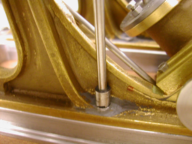

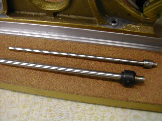

                                I thought I would take a couple of more pics to clarify my last post a little.
                                This shows two counterbores quickly made to CB holes in the base of a McOnie engine to accept steel ‘bolt pads’. They are just filed up by hand, no division except by eye and simply Loctited to a piece of silver steel (left soft). They are just for the job in hand though will still have some use in the future ie they are not made to last – just to do the job.
                                The Loctite held as very little heat is generated as the speed is quite slow and the cutting well lubricated. They are not tempered back just left as hardened the smaller one just polished with use. I do agree though that they are more like spot facers than cb’s and yes you do have to clear the chips but they do work.
                                This gives some idea of the tooth form – I notice from the traces of bronze remaining  that only two teeth were leading! but it did the job okay.
                                This shows the small one (resting on top of the now in situ bolt pad) but this is how it was used to get past the ribbing on the casting. This could have course been done by reverse cb but this did it ‘all in one hanging’ and was much simpler.
                                The drawing just calls for spot facing but this would be an area more built up I feel hence the decision to put in bolt pads. The grey stuff is JB Weld – believe me it will look much more the part once a coat of primer goes on
                                This is not to take anything from your advice on D bits on the contrary – just another approach to do the same thing though on this particular op as you can see straight drilling was not an option.
                                Regards – Ramon
