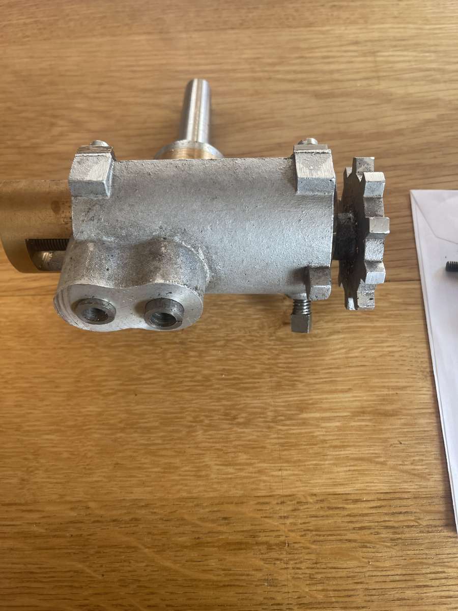

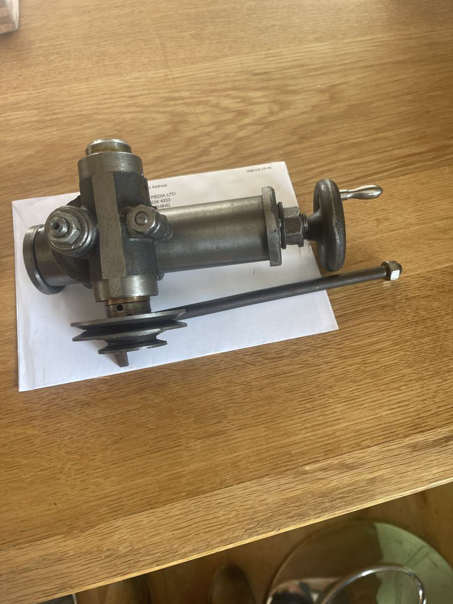

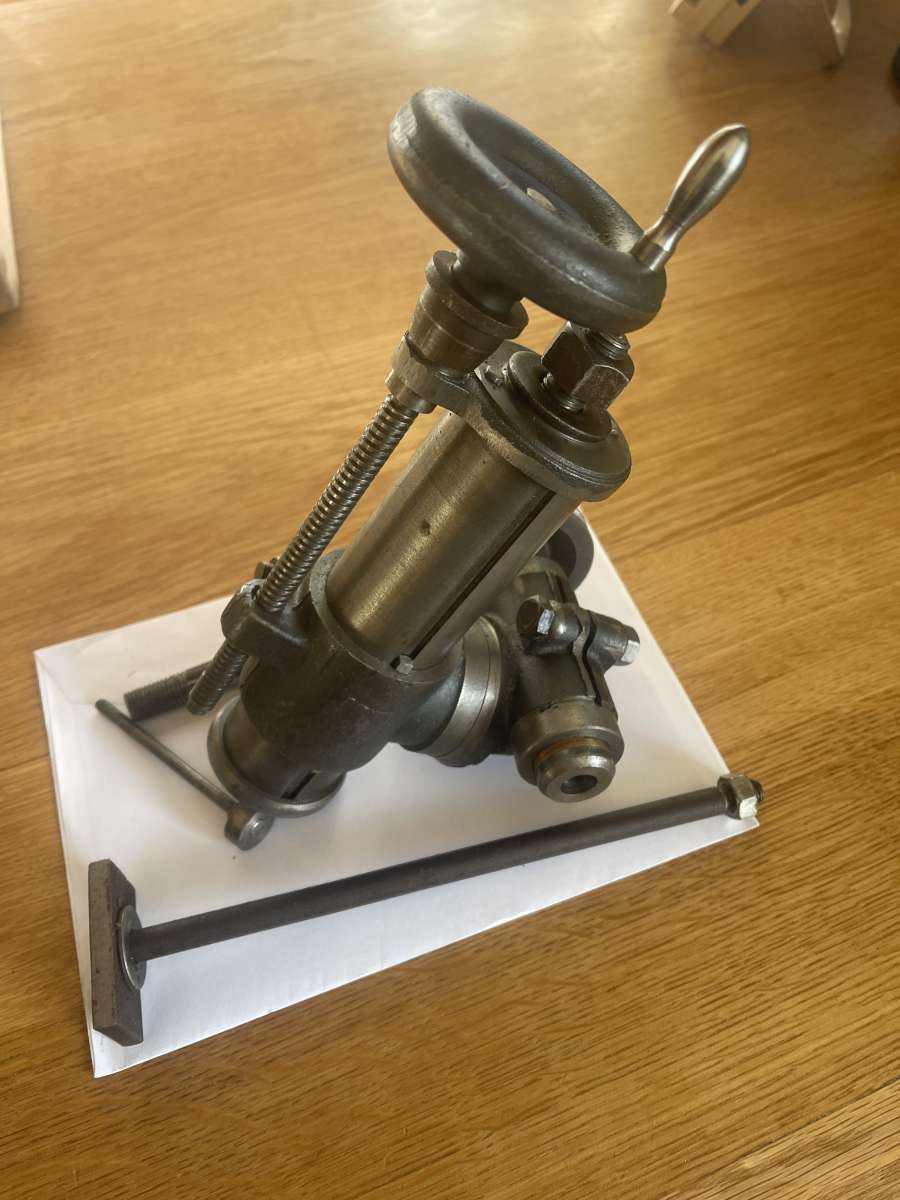

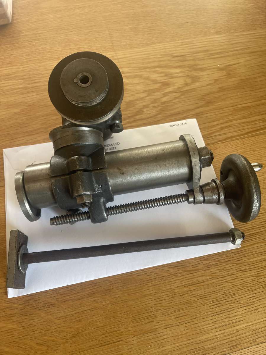

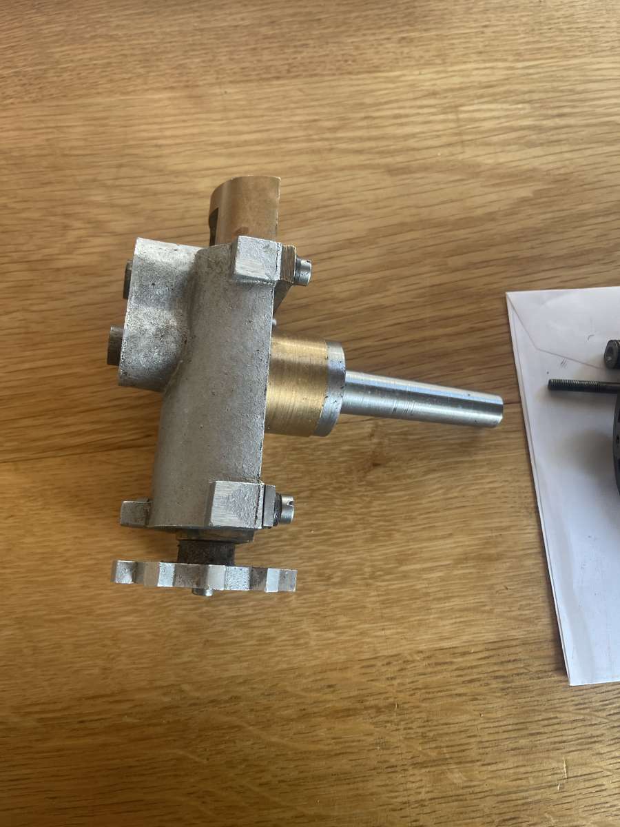

      Hello All
      I have recently been given 2 tools, one of them is a potts milling spindle which the owner wants to gove to me or I can sell it and give them the money.  The second is a Boring head that I have seen before but I cannot remember who the design was by, I have only ever seen this head as I have it but someone has pointed out that it is missing a striker to turn the gear, any help would be much appreciated.IMG_1156IMG_1158IMG_1154IMG_1155IMG_1157

          I think that’s a Dore boring head, designed by Arnold Throp.
          #720536
          peak4
            @peak4
            It is a Dore yes.

              and the other one is a Potts’  [or maybe Pott’s] milling attachment.
              Two classics !!

                Items are as described above. Neither seems well made; in particular the boring head is pretty poor. Technicallly the boring head is a boring and facing head. The striker is just a fixed peg at an appropriate location that moves the toothed wheel one tooth per revolution of the head to allow facing. For boring it is not needed.

                    Why are they not well made Andrew ?
                    #720614
                      I think there are a couple of different type of makers.
                      Taking the boring head to my eye the MT taper has some marks which could be down to machining or it having spin in a socket, finish on the GM diameter is not great and the alloy casting could have done with some fettling to remove the flash.
                      Others may see beyond the external appearance and find that it is perfectly functional. But could also be indicative of other poor workmanship that may affect it’s function

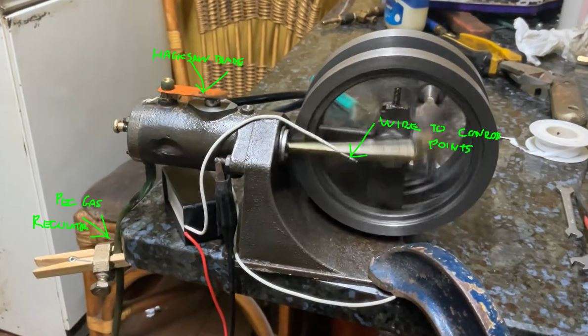

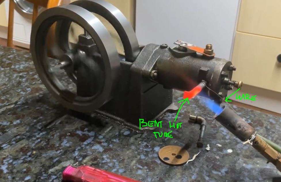

                      I’m of the first type liking my engines to look right to me yet someone like Graham Corry of Alyn Foundry that I have been developing a few new engines with will do the absolute miniumum to castings and only machine the surfaces that need it flash and surface finishstays as it left the foundry. But he makes running engines many of which have not been modeled before or have unusual cycles like the Brayton or Loyal. We have just been workng on a Hardy and Padmore “ideal” engine which has a form of Loyal cycle but he has got it running with cobbled together ignition, sparkplug, valves and then with hot tube. Should it be scraped, I don’t think so. Mine will be more refined and finished as that is how I like ’em.

                      That boring head may have been made as quickly as possible by someone wanting to use it where the main purpose was not the making of the tool but the part it was used to make so they did not want to put in the time tarting it up to exhibition standard.

                        I think Andrew is being a little harsh.  The functional part, the matching hemicylinders, look to be well enough made.  The Dore boring and facing head was originally designed to fit on the nose of a Myford milling machine. The morse taper in this case probably screws on to the head with a Myford nose.  The example that Roy has is so similar in look to mine, which I bought on ebay, down to the poorly finished ends to the retaining bars and cheese head and square ended screws that I am tempted to wonder whether Dore sold some completed versions for sale.  Mine certainly works very well, though I have only used it on my milling machine which has a Myford nose thread.  Very useful for cutting a flat seat at the bottom of a hole.

                            Of the two the milling-spindle looks the better made and hence useful, but as Jason says a rather poor finish is not a necessarily a guide to functional ability. Their maker might have wanted them simply and quickly useable to help him get his own BB1 ploughing-engine built and on the rally field!
                            That scored taper on the boring & facing head may be from the maker’s turning skill rather than by it slipping in a spindle; though I might have expected at least some general fettling, and a better finish on the indexing-wheel. The taper shank could be replaced using a purchased soft-end arbor.

                                The taper shank does unscrew and inside is the same thread as on the Myford. The boring head was just given to me but the milling spindle was an item that in conversation came up and I knew of someone on the Boxford forums that started a thread about milling spindles for a Myford Super 7, he mentioned a Potts spindle and as a friend mentioned he had 2, I told him about the person from the Boxford Forum so he said take them and see what happens, if nothing happens I was told to just keep them. I know people are saying it seems a bit odd but it is just the way I worded it that makes it look that way, anyone can always go to the Boxford Groups I.O site and take a look, they will see the same photo’s there.
                                Does anyone know if the drawings are still available?

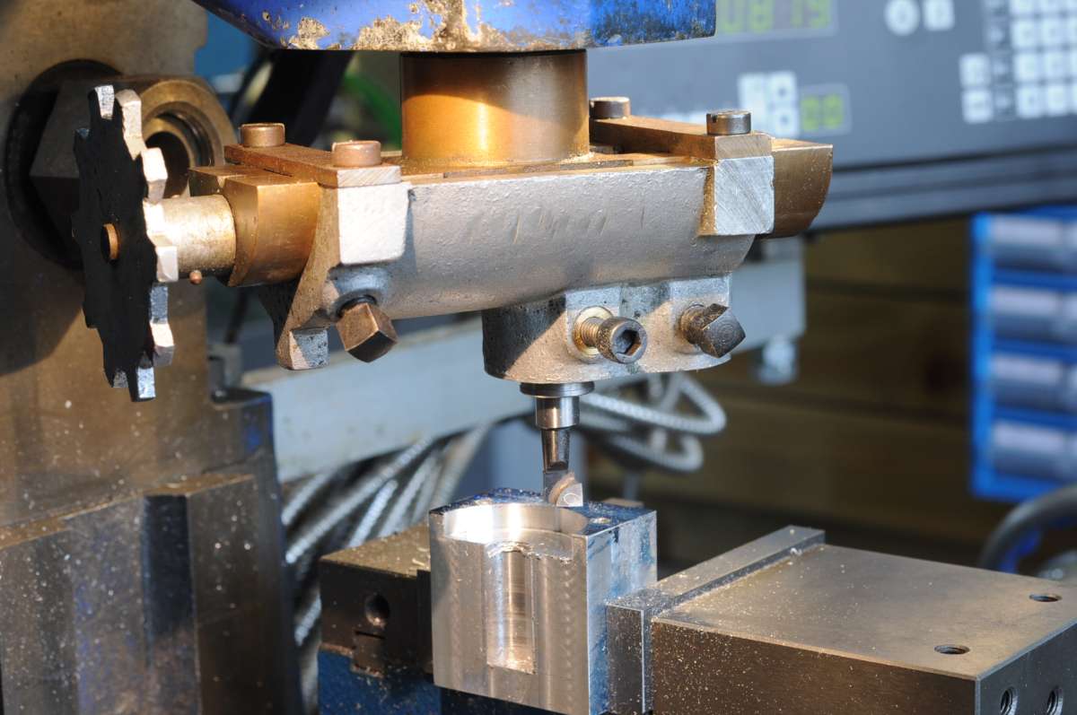

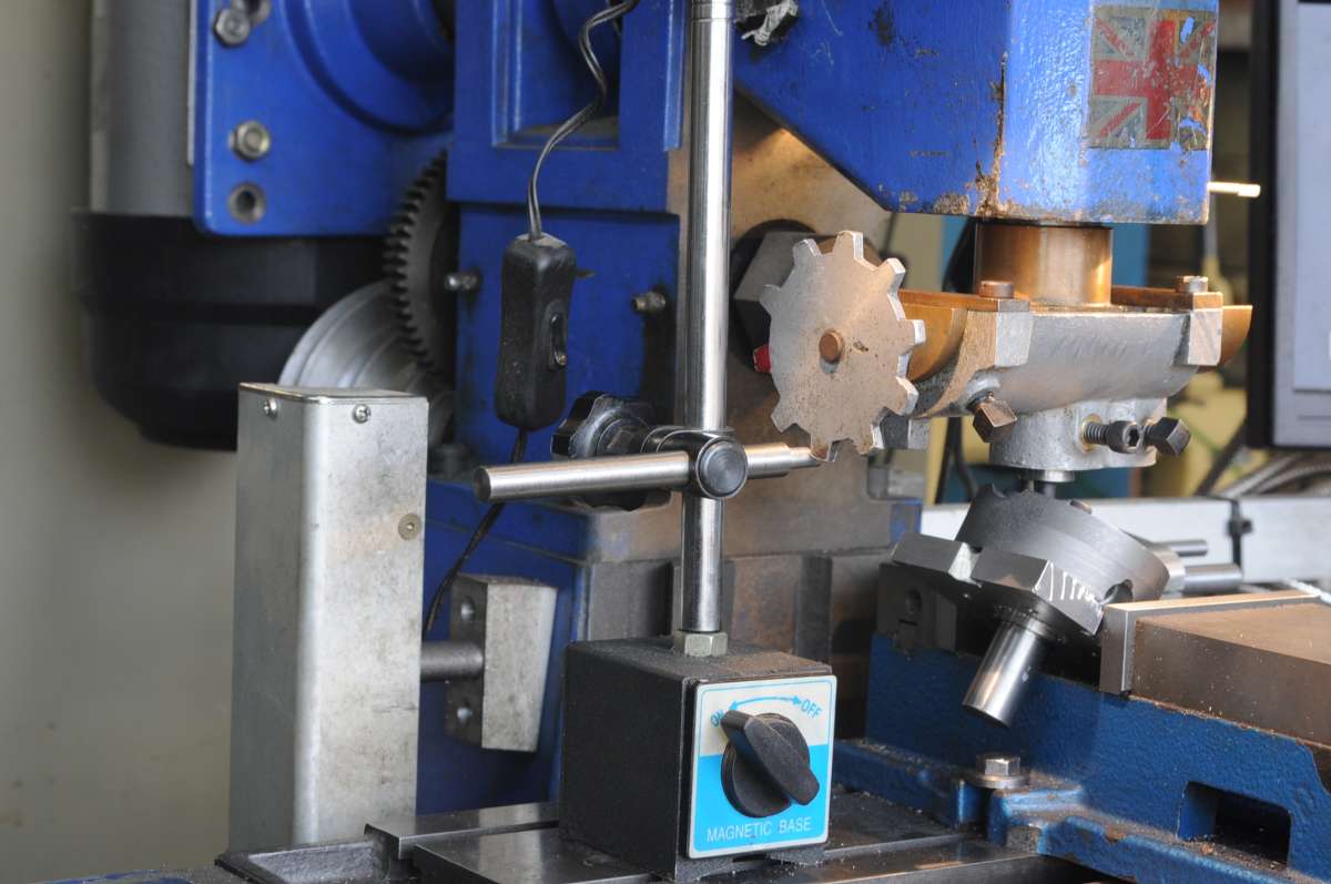

                                      WRT my comments above, the boring head was originally designed for use on the Myford lathe.  I’ll also have another go at posting some pics of mine:
                                      DSC_7042DSC_7008

                                        I want to now make the striker plate and test this out, does anyone have this that I could possibly measure up?
                                        Peak4 very kindly sent me a lot of information but a lot of dimensions are missing for the striker set up which I suspect is because it was a casting that needed a bit of work to working surfaces to clean it up. They do say on the build article that the dimensions have been omitted.
