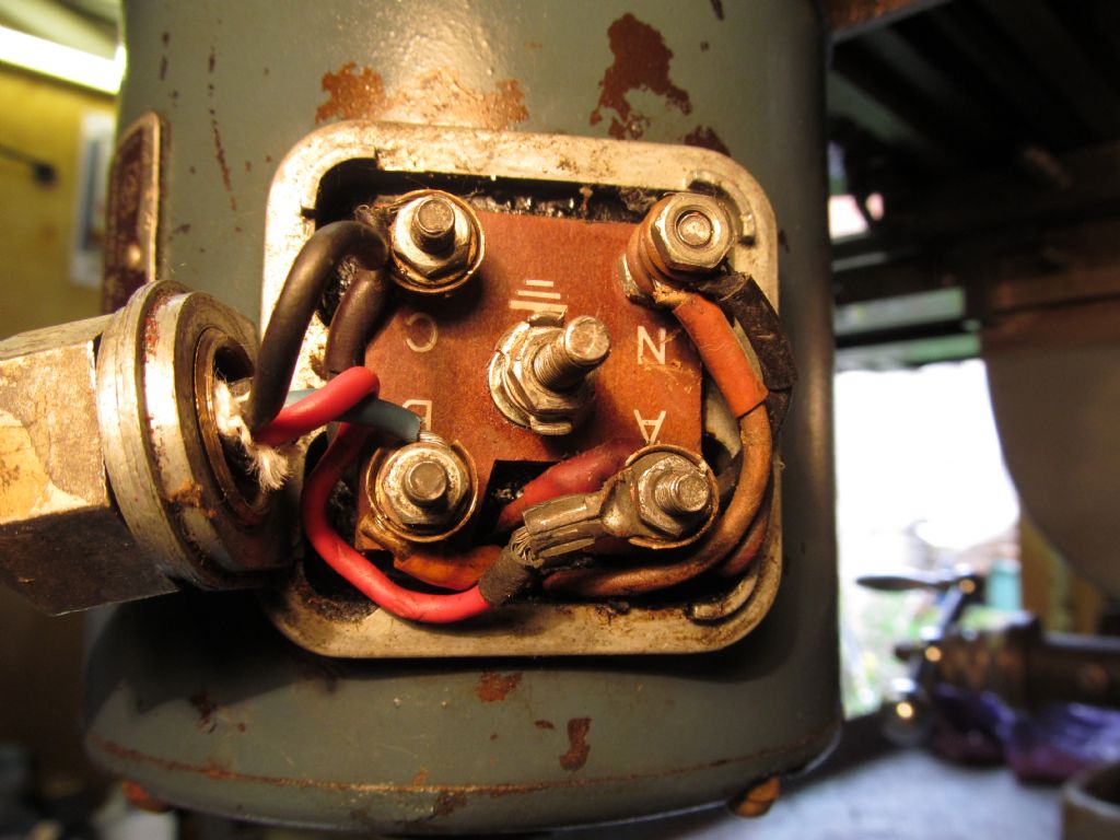

                            #188638
                            ash roberts
                              @ashroberts83808
                              Hi guys,
                              i have a lovely Centec 2B that i need to start using..
                              I managed to delta the main spindle motor using a Drives direct VFD.
                              I also took the table motor from the main power feed and it now has its own and VFD
                              Now i need to convert the table motor to Delta and could do with some advice please.
                              I think the original table motor is still on it..
                              BHP – 0.125
                              RPM – 1425 Dual voltage 3 phase.
                              colours are
                              A – RED + DARK RED
                              B – GREEN
                              C – BLACK + DARK BLUE
                              N – BLACK +BROWN + DARK BROWN
                              NO WIRE CONNECTED TO THE EARTH ?
                              I am correct in thinking i wire the three phases into A B C one each but link 1-2 , 2-3 & 3-1?
                              Any advice would be appreciated.

                                #188714
                                Les Jones 1
                                  @lesjones1
                                  Hi Ash,
                                  Remove the three wires from the N terminal and make sure they are not touching each other or anything else. Verify with your multimeter that there is no continuity between terminals A, B, and C. (If there is then disconnect the power wires to the motor and do the test again. If you still get continuity then I don't know how the motor is connected.) Identify the wire that you disconnected from terminal N that shows continuity to terminal A and mark it to be connected to terminal B. (But DO NOT connect it to terminal B yet.)
                                  Identify the wire that you disconnected from terminal N that shows continuity to terminal B and mark it to be connected to terminal C. (But DO NOT connect it to terminal C yet.)
                                  Identify the wire that you disconnected from terminal N that shows continuity to terminal C and mark it to be connected to terminal A. (This will be the only one left..) Now connect these three wires to the terminals that you marked them to be connected to. The motor is now wired in delta configuration. Terminal N is no longer used. ADD AN EARTH WIRE TO THE MOTOR.
                                  Les.

                                      #189168
                                      ash roberts
                                        @ashroberts83808
                                        Do you think i should use a seperate power supply for the table motor & lamp? and a dedicated spindle power supply.
                                        #189225
                                        Les Jones 1
                                          @lesjones1
                                          Hi Ash,
                                          I do not have the original wiring diagram for your mill so it is difficult to know how to suggest wiring the lamp. There is probably a transformer to feed the lamp which may have the primary tapped at 240 and 415 volts. If this is the case then just use the existing transformer fed with the normal mains connected to the 240 volt tap. (If you have the original schematic can you post it as a picture ?) It would be better to have a separate VFD for the spindle an the table as it would be useful to control the speeds independently. Also most inverters do not like any switching between the output and the motor. (There are some more expensive ones designed to be used with several motors connected to the output with switching of the motors. I suspect one of these would cost more than two of the cheaper types.)
                                          Les.
                                          #189241
                                          ash roberts
                                            @ashroberts83808
                                            Hi Less, no wiring diagrams here…
                                            I was going to send a seperate 240v feed to the VFD- table motor and lamp, Bypass the lamp transformer to supply 240v.
                                            The spindle is on a seperate 240v feed via the spindle VFD..
                                            Was just wondering if me trying to conserve plug sockets and only supply all from a junction box off one 240v wall socket was pushing it a bit, or should i just use 2 x 240v sockets.
                                            Edited By ash roberts on 09/05/2015 20:29:26
                                            #189294
                                            Les Jones 1
                                              @lesjones1
                                              Hi Ash,
                                              If the spindle motor is only 3/4 HP as Martin suggests then there should be no problem feeding both VFDs from the same 13 amp plug. I would suggest mounting both VFDs in the same box (Ensuring suitable ventilation ) You could then use a common EMI filter to feed both VFDs (This is so you can keep the wiring between the EMI filter and VFDs as short as possible. If you need a source of screened power cable to use between the VFDs and motors then Arc Euro Trade sell it by the metre. (It is on this page of their online catalogue.) It is also good practice to use screened cable between the VFDs and the remote controls. This only needs to be signal type screened cable as it only carries very small currents.
                                              Les.
                                              #189298
                                              ash roberts
                                                @ashroberts83808
                                                Ok thats great Les, thanks again..
                                                I shall get some screened power cable off Arc
                                                What screened cable would you use on the remotes.
                                                Edited By ash roberts on 10/05/2015 10:19:53

                                                  Les Jones 1
                                                    @lesjones1
                                                    Hi Bob,
                                                    Thanks for that link. When I installed my VFD Arc was the only place I could find to supply screened power cable in small quantities.
                                                    Hi Ash,
                                                    I just used some ex computer screened cable I had. Just work out how many conductors you require to the remote controls and choose one with that many conductors (Or a few more.) and is a reasonable size to be mechanically suitable. (I would say about 6mm outside diameter..) I think Maplin probably sell it but they tend to be expensive. On the spindle control you will probably just need a speed control, a forward/ reverse switch and start and stop buttons. On the table feed you will need a speed control, a direction switch and a fast traverse button. you will also need to connect limit switches to this control box. You will need to read the manuals on the VFDs to see how to configure them to behave as you want.
                                                    Les.
