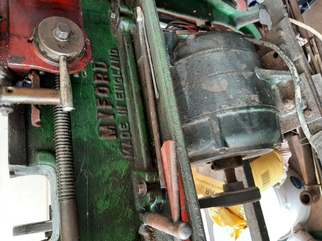

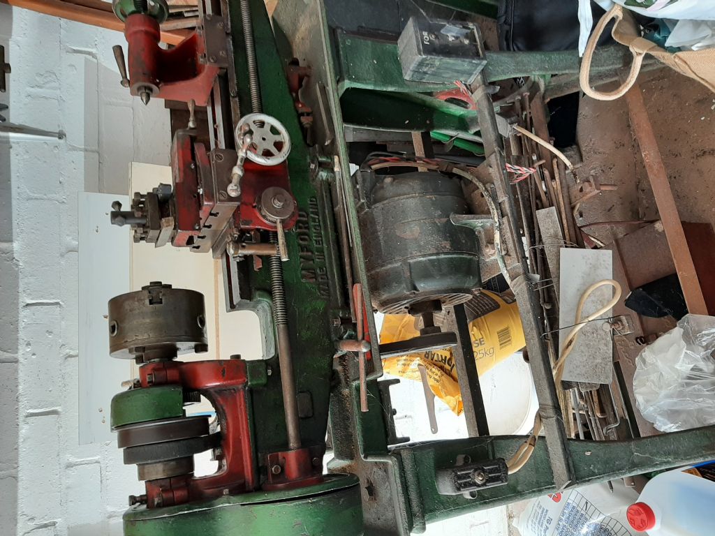

      20210423_161835.jpgHi,
      I'm writing on here to request help on trying to identify various tools that are in my dad's garage who recently passed away.
      He was an engineer and loved model engineering so I thought this might be a good place to start. Basically I'm hoping someone can identify/ value? this Myford lathe. It dates from around the 1940's as it was previously owned by my grandfather who used it in his toy factory where he made lead toys before and during the war.
      It does work and I've attached some photos that will hopefully help. It has a number stamped on it V1014. 20210423_161808.jpg

            ML1 on early stand (possibly) Have a look at Lathes.co.uk for more info.

                Myford have said it may be an ML2. I does look like a picture of one on lathes.co.uk. There are loads of attachments for it but don't know what they are called. It was bought new by my Grandad and has been in the family since then. It is in Nantwich,Cheshire if that would be of interest to anyone.

                  According to the Lathes UK website:
                  If it is a ML1 the centre height will be 3 1/8" with 15" centre distance, ML2 is 24" centres.
                  If a ML3 this will be 3 1/2". centre height.and 15" centre distance, ML4 is 24" centres..
                  Someone more expert than I should be able to date the machine from the Serial number, but it will be a fairly early one a guess, judged by the flat belt drive. Probably about 1938 /39? (Later machines had Vee belt drive ), and the type of Tailstock.
                  On the earlier machines the chucks screwed onto a 7/8 Whitworth thread (7/8 x 9 threads per inch )
                  Later this was changed to 7/8 x 12 tpi, and some of the very latest machines had a 1 1/8 inch x 12 tpi thread.
                  Having a full set of change gears and, hopefully, a four jaw chuck will be good selling points, as will the four way toolpost (The original tool post held only a single tool )

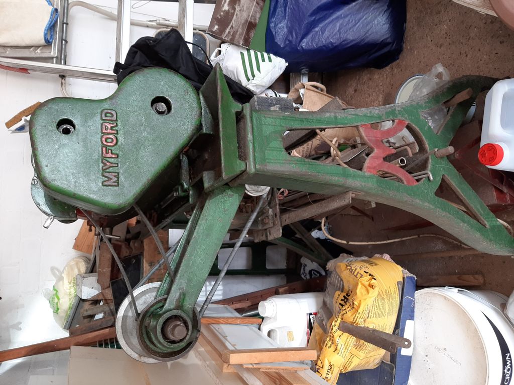

                  The fact that the machine is on the Myford stand, with the Counbtershaft should add to the value.
                  Hope that this is of some help

                    Can you add a photo or photos of the accessories? Do that and we can soon identify them between us, for you.
                    As a start:
                    The chuck that is on there, looks to be the 3-jaw variety. That T-shaped item in the tray below it, is it operating-key.
                    A four-jaw chuck is similar but, well, with 4 moving jaws.
                    A faceplate is a large disc with a threaded hole in the centre, and a pattern of several radial slots or holes. Like the chucks, it is for holding work-pieces.
                    The "change-gears" Howard cites (aka change-wheels) are a set of gears each with the number of its teeth stamped or embossed on it. They are assembled by their appropriate numbers onto the lathe for when cutting screw-threads.
                    The pointed thing sticking out of the "tailstock" (the tall, red unit at the right-hand end), is a "centre" and there should be at least another, with a sharp point at one end and a longer, tapered tail (that in the photo is hidden inside the tailstock).
                    So, if you can supply photos of whatever there is with this machine, we can identify at least the most important items, and possibly weed out any odds and ends that have moved in with them. Doing that will enable you to catalogue it properly and hopefully find a caring new home for it all.

                            One thing I do see in the pic is what looks like a fixed steady tucked in the tray under the tail end of the bed. Those are not common and might be worth a few bob. I see it also has a threading dial (long vertical tube with a gear on the bottom, right by the letter F). Might be desirabl to someone.
                            The cover on the left end should open to expose some gears. There should be loose ones with it so they can be swapped about.
