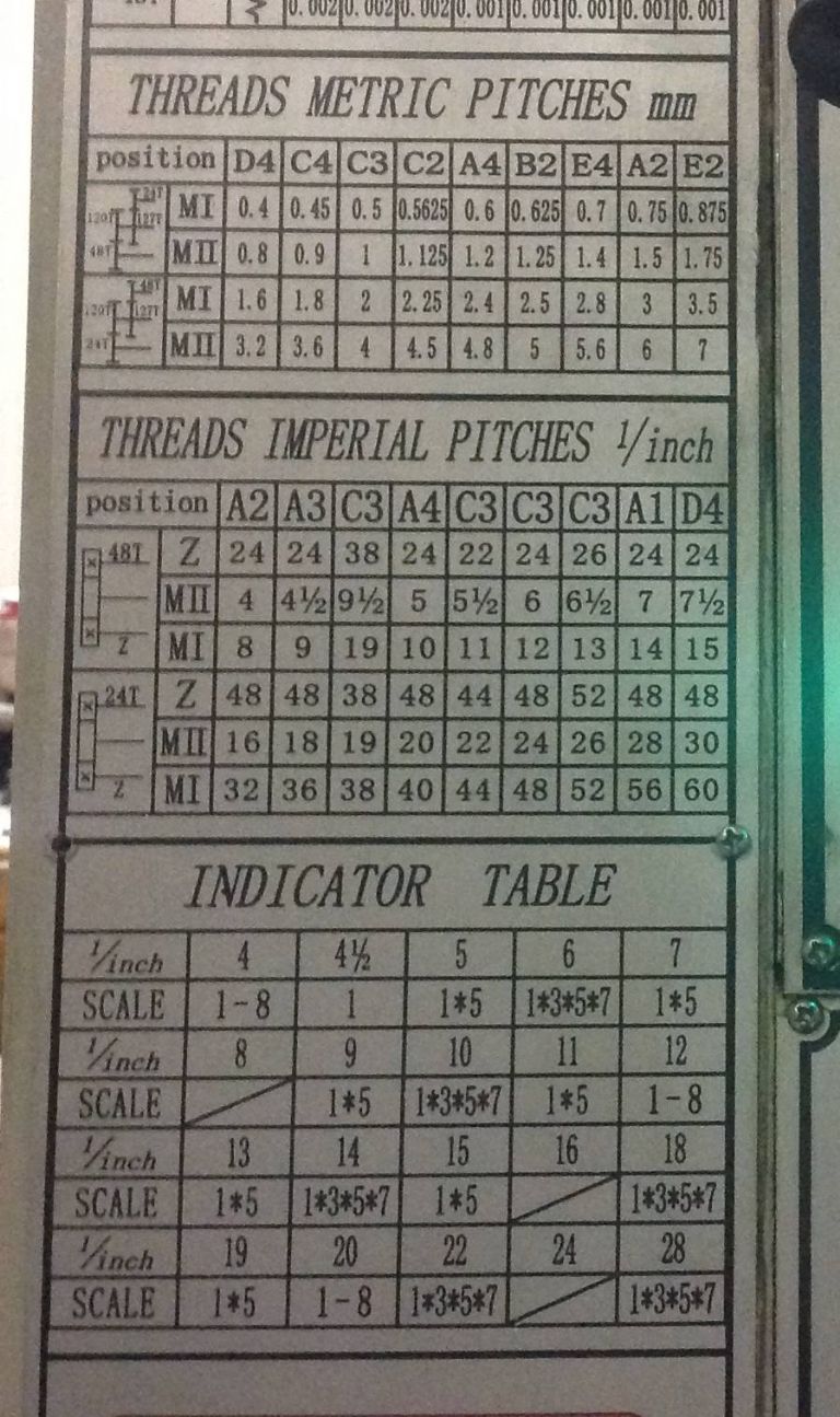

        Hi all,
        I'm trying to figure out how to do screw cutting on my lathe. I've watched a bunch of videos about it and thought I understood but the tables on my lathe are puzzling me.
        First off, how do I reconcile the metric thread pitches with the indicator table? I have been doing 25.4 / metric thread pitch to come up with a TPI but this rarely works out to an equivalent number on the table. Is just choosing the nearest TPI the best I can do?
        I tried it with a M12 1.75 pitch for example and got a TPI of 14.5. So I figured both 14 and 15 TPI told me I could use 1 and 5 on the thread dial, but the thread came out a mess.
        I'm also wondering about the imperial table. I'm guessing it's telling me the middle gears just need to be equal. Is that so? Not sure how to go about that as it has larger 120 and 127 tooth gears on there now and nothing else that came with it looks big enough.
        And with the indicator table, how do I figure for TPI above 28, such as 40 TPI? Is it just like 4, 8, 12, etc – being divisible by 4 or 8 means I can choose any number on the thread dial?
        I don't want to cut the screws to final size, but I want to cut them deep enough to make it easy to start a die straight and have it just finish the thread off rather than cutting the whole thing. This has not worked yet!

            Bit more info on what brand/model of lathe would be helpful, as would a pic of the thread indicator dial and the levers for the M11, A3 etc mentioned on the charts above.
            But, first thing you need to do to turn metric threads is forget about TPI and conversions and so forth.
            From the look of the chart you posted above, your lathe will do all that for you by a simple change of the change gears between the headstock spindle and leadscrew.
            You need to set up the gears as show on the metric chart above, that is: 24T on the main spindle, a 127 and a 120 on the same stud in the middle, and a 48T on the leadscrew. The 120/127 combination is the "translator" to make your imperial leadscrew act like a metric one, by the magic of mathematics that is to arcane to get into here.
            Once you have those gears set up as above, my best guess is you select the positions of MII and E2 with whatever selector handles/knobs match those. This will give you 1.75mm pitch, according to your metric chart.
            Then don't use the thread indicator dial on metric threads. Keep the half nuts engaged at all times and run the lathe backwards to move the tool back toward the tailstock between cuts. The chart above looks as if the chaser dial is set up for imperial only, and it looks like you have an 8tpi or 16 tpi leadscrew, which is why no indicator number is specified for those pitches — you can use any number on TPI that are a multiple of the leadscrew TPI.
            To turn imperial threads, your chart seems to show that you set up the gears with with either a 48 or 24T on the spindle and then change the gear on the leadscrew to value Z to obtain the desired TPI, as well as setting the relevant levers to A1, C3, M11and so forth as per the chart.  The idler gear in between can be any size that fits the space. Its size does not affect the overall ratio. That is determined by the first and last gears in a simple (non-compounded) train such as this one used for the imperial threads.
            Happy screwcutting. And I can highly recommend the Workshop Practice series book on Screwcutting in the Lathe as the easiest way to get your head around all this stuff.

              Thanks guys. I tried leaving the half-nuts engaged and running backwards a few days ago but I have just realised what I did not do in that case was bring the tool out – I just left it in the work and I'm guessing the slop in the half-nuts wasn't doing the job any good. I'll try it again this time bringing the tool back each time I reverse.
              I do have the gears set up as required, and had set it to cut 1.75mm pitch. I was only converting to TPI because I thought I should use the chaser dial to engage the half-nuts so was looking for the closest TPI to use those settings. FWIW the chaser dial has 1, 3, 5, 7 and lines between each number as well, so I assume that stands for 1 – 8.
              The lathe is basically this one **LINK** – it has the same controls and gearbox, just a flat front rather than curved. You can see a picture of the chaser dial from that page. It seems to be similar to the Warco GH1236.

                                            I had time to look at this again today and figured it out.
                                            While counting the teeth on the gears I noticed both of them were meshed with the 127 tooth middle gear. The bottom 48 tooth gear should have been meshed with the 120 tooth gear which sits on the same arbor as the 127 tooth one.
                                            The way they were set up was okay for the imperial 1/2" thread I cut a couple of years ago and when I saw the correct gears were still installed I stopped looking so didn't pick up one of them had to move out to mesh with the other 'middle' gear.
                                            So this time the thread was clean and to the correct pitch. I couldn't thread a nut on though, even when the thread looked pretty good. I had to run a die over it before the nut would go on. On the plus side I think this left a nice clean thread, which looked better than the turned one.
                                            If I am turning a male M12 thread, do I turn the initial diameter to 12mm, or a bit under?
