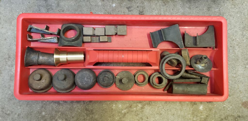

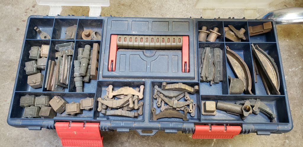

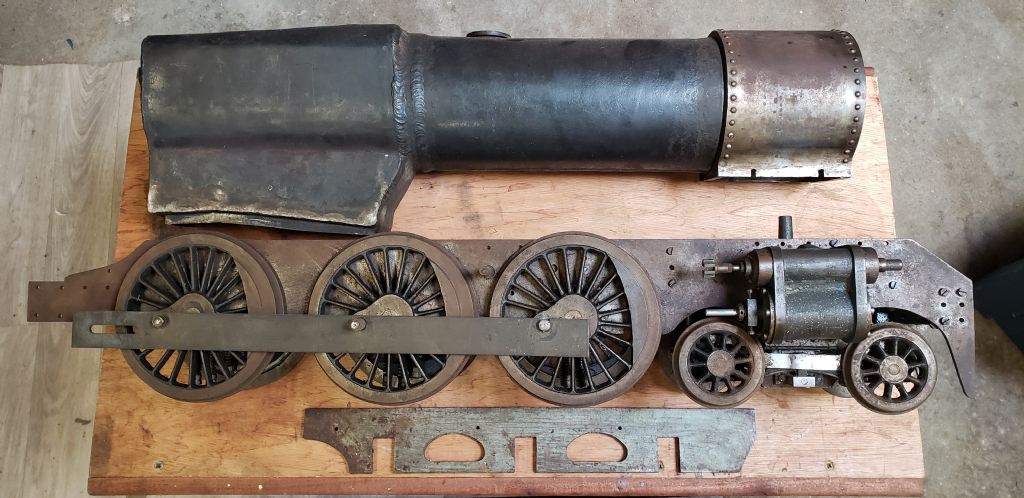

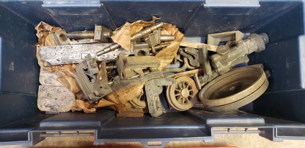

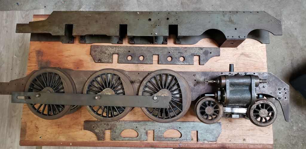

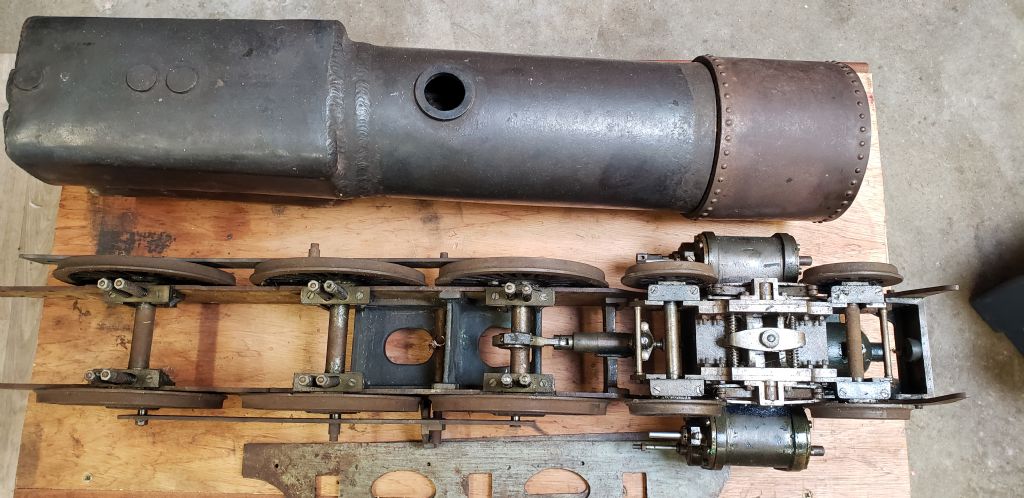

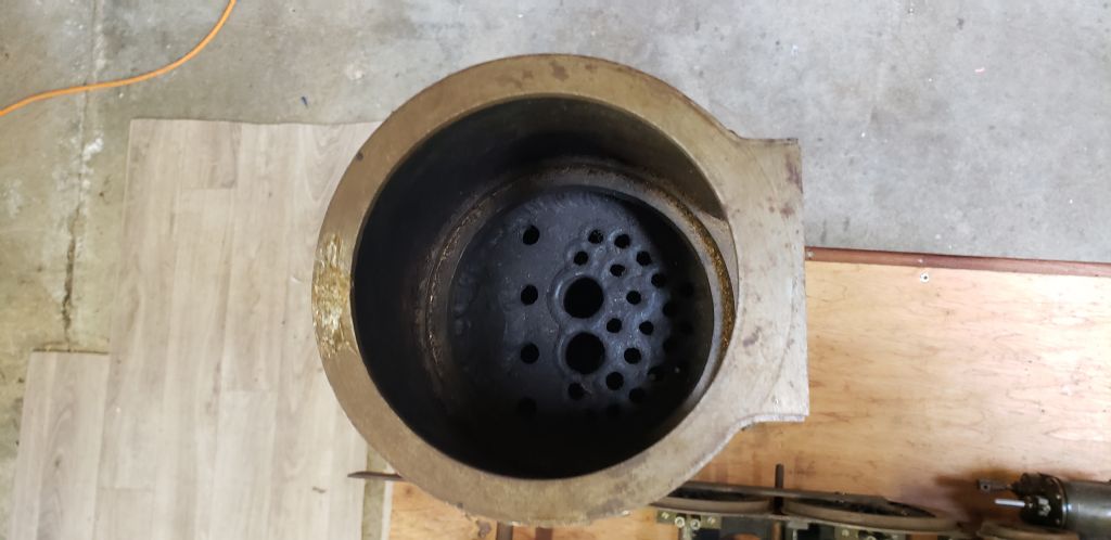

      Hi
      I got this model(s) when I purchased a lathe. I have tried for months without success to identify it.
      If anyone has any ideas that may help, please please let me know. I have no drawings plenty of parts!!20230726_095014~2.jpg20230726_094936~2.jpg20230726_095047.jpg

          Is it a Black 5, I think LBSC made one called Doris.

            It's a Bonds Royal Scot designed for Bonds by Henry Greenly in the late 20's or early 30's, Drawings are available from Kennions , I know as I had a set delivered yesterday! ( I just bought a collection of 70 year old unmachined castings, the quality of which puts some of our suppliers to shame). It was designed as a 2 cylinder as opposed to the 3 of the full size, have driven an example many times and it steamed and ran well. One of the design options was greenly's double ported piston valves, these are on the drawings as well as the conventional piston valve cylinders. The design features a large roscoe displacement lubricator between the cylinders, where the third cylinder would be on full size, yours appears to have this.A dated design but there are a few finished ones I've seen running over the years. Googling Bonds Royal scot should provide some interesting answers, good luck with it. One of these has been top of my list for many years so I was delighted to chance over the castings.
            A look at Station Road Steam's archive shows a couple of examples, including a part finished one
            I've just noticed you have duplicates of some of the castings I don't have, if you decide to sell them in the future please let me know……..

              Dave I'm sure there are the parts off 2 models, not sure of the history so don't know why. Will be in touch with Kennions, should make my puzzled head ease a little. I'll do some research now I have a lead. Are you anywhere near North Yorkshire, may be able to help ?

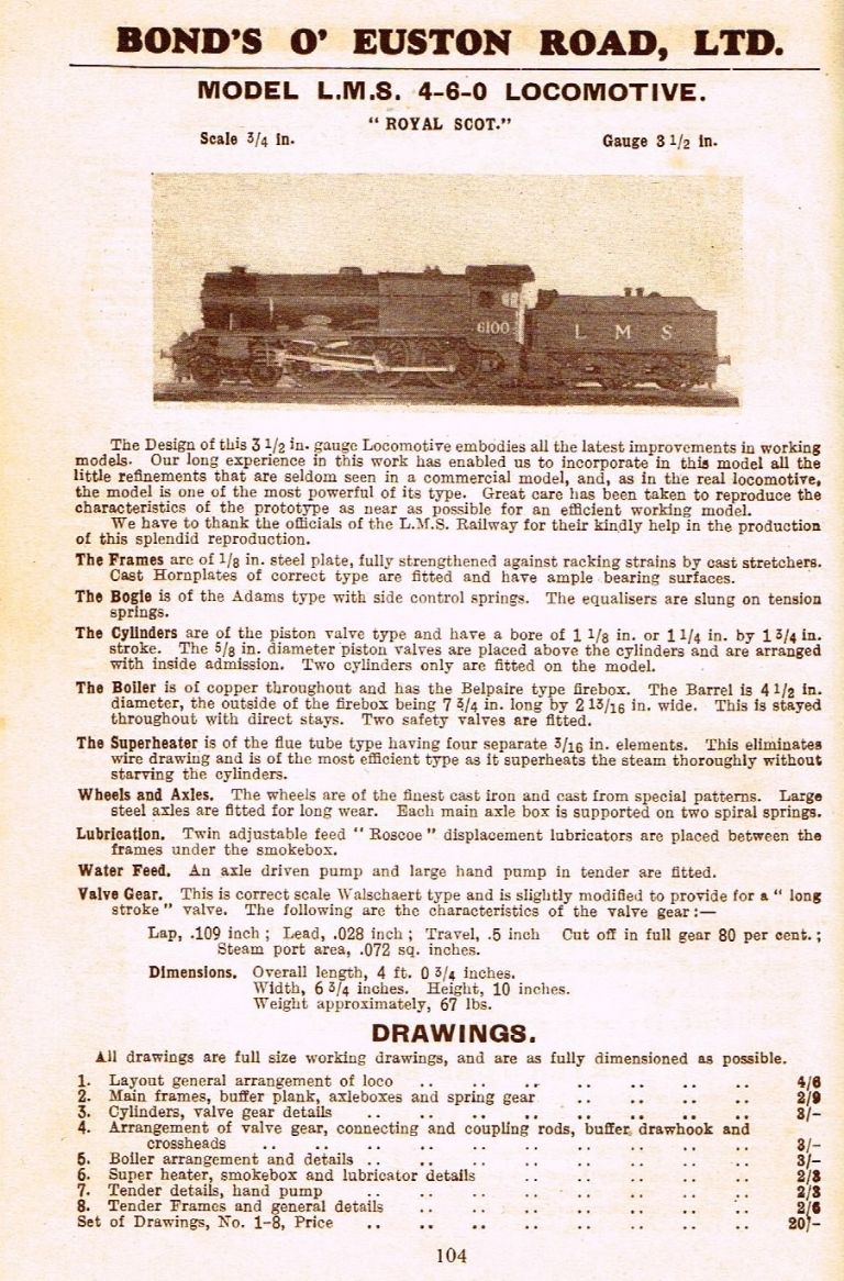

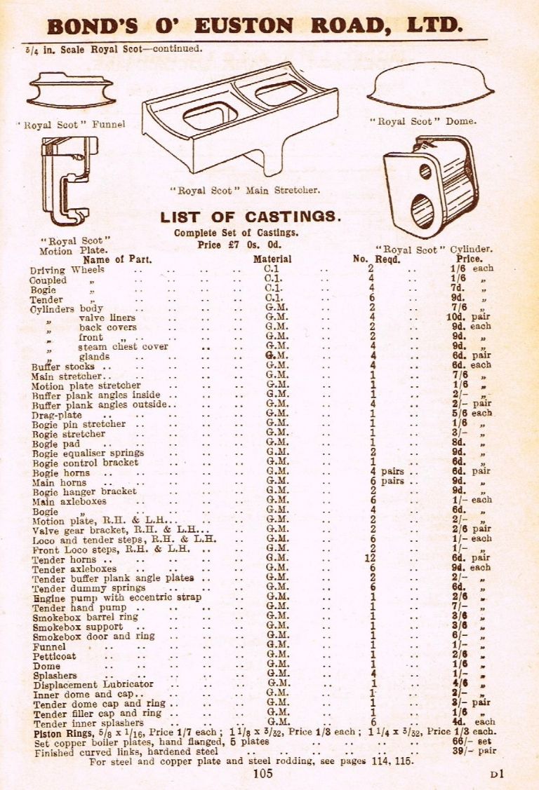

                Hi Martin, you may like to look at these two scans.
                Regards Nick.

                    Nicholas, thank you for posting the scans, very interesting, unusual to see the valve events specified in the advertisement, most designs you have to work it all out for yourself!

                          A welded steel boiler? Unusual in 3-1/2" gauge, but no real reason why not although a club boiler inspector might have waffle moments about it unless its provenance is known. Actually it looks quite new – its colour suggest black mill-scale rather than brown rust. While the rust on the other parts looks light enough to clean off without leaving pits.

                                    In the context of the boiler and the era (1939) of the design, if of steel construction then it may well have been gas welded or brazed. The fire tubes look neatly fitted, be it braze or weld. Now would be the time to decide when or if you would run it, and then in public or private. If in public then join a club and speak to the boiler inspector, for private use then you could conduct your own tests if you have the knowledge and equipment, though a club test is best ! Good Luck. Noel.

                                      The Boiler is steel, my lack of knowledge means I don't know if it is good or bad tbh. I believe there is a club up the road near Darlington which I shall be joining in the coming months.
