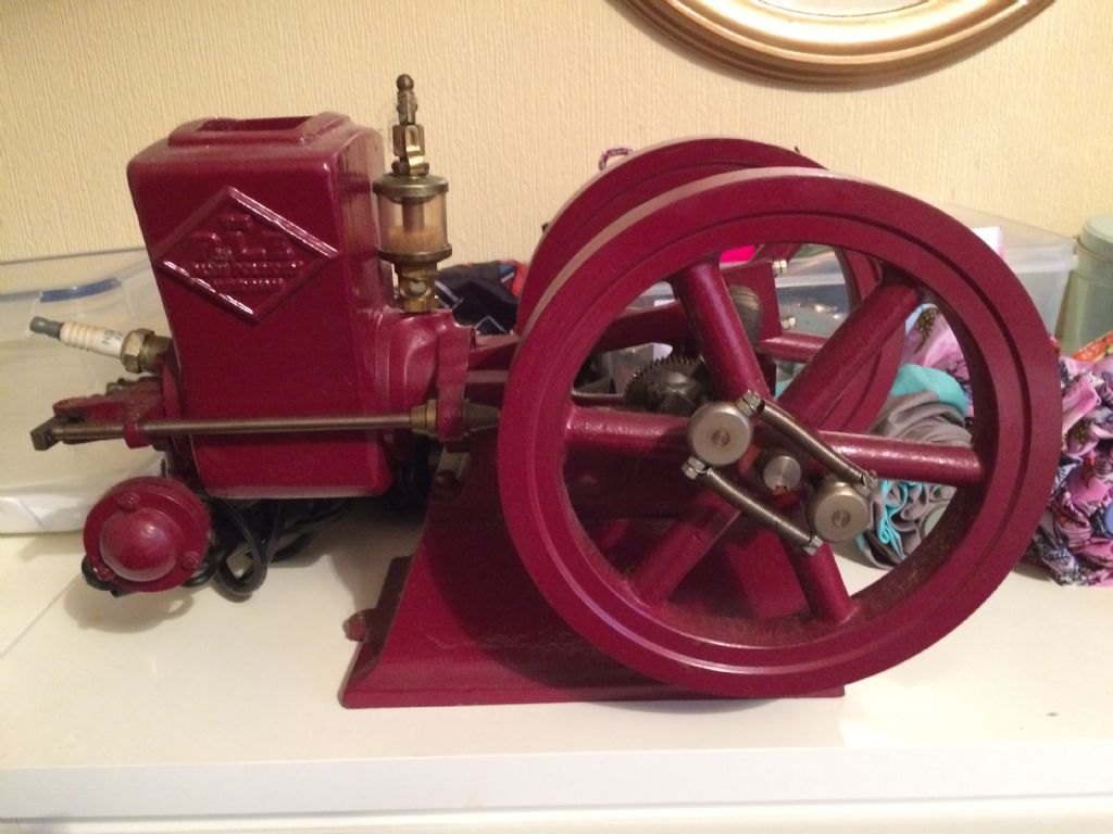

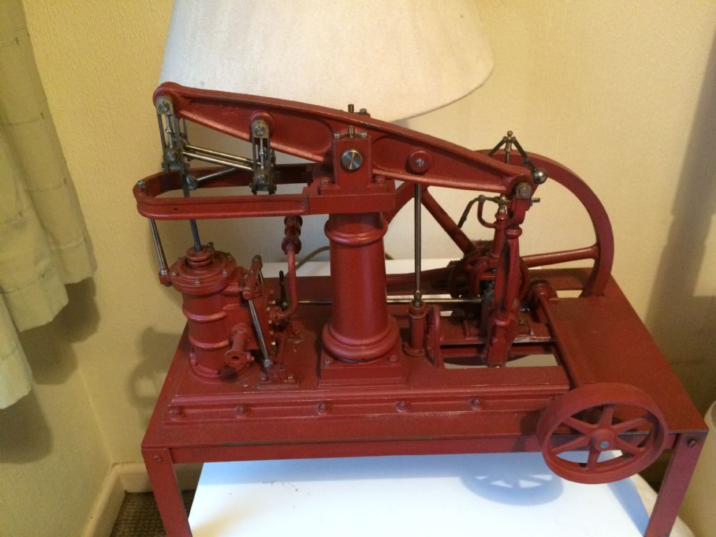

      Hi there, I wonder if perhaps someone may be able to help me out. Following the death of my mother, I have been responsible for clearing her house. My late father was a keen model engineer and produced these two machines in his workshop.
      If anyone can identify them for me I would appreciate it.
      cheers

          If the beam engine has a flywheel of about 14" which going by the skirting board in the background it probable does then the model is the Stuart Major Beam Engine, looks to have had an additional geared shaft and pully added on.

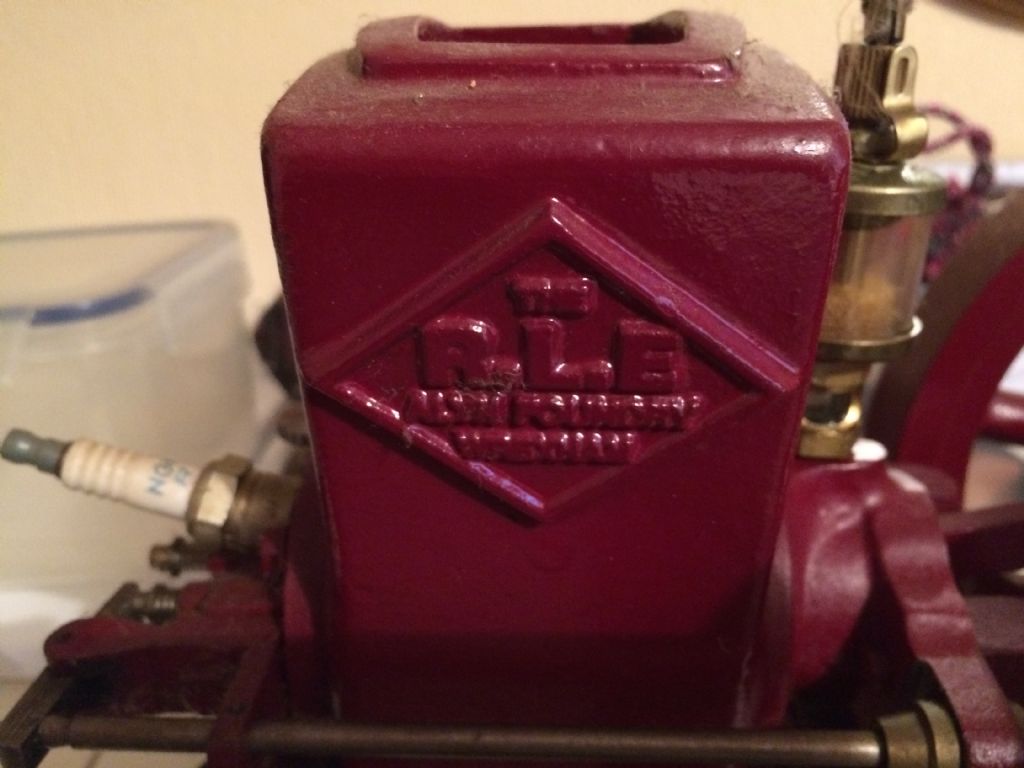

          The other is a "R.L.E." hit and miss internal combustion engine the casting kit of which was marketed by Alyn Foundry. They are now out of business but the propriator Graham Corry is still contactable.

              I remember seeing the hit and miss running before. I may try and get that one running. As for the beam engine, n o idea what to do with it!

                    Thanks for the suggestions, I'm not that sure how I could part with them myself. I've less interest in the beam engine I suppose, but even then I wouldn't know what a reasonable price was.
