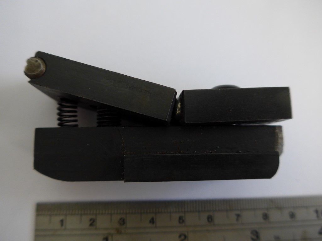

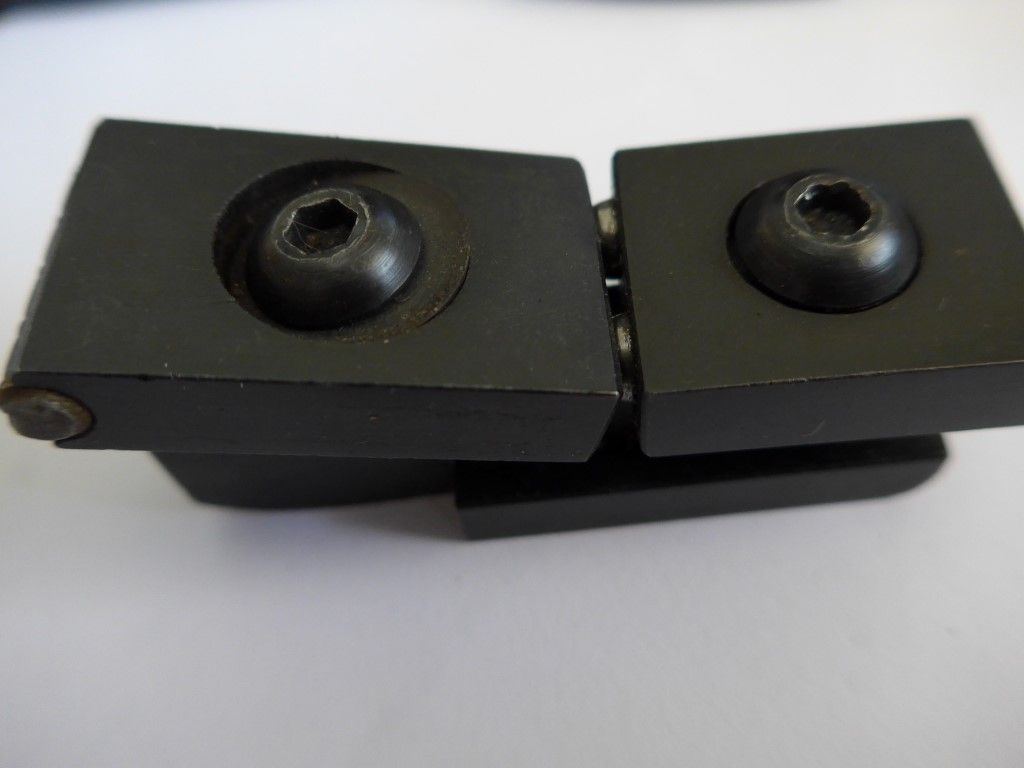

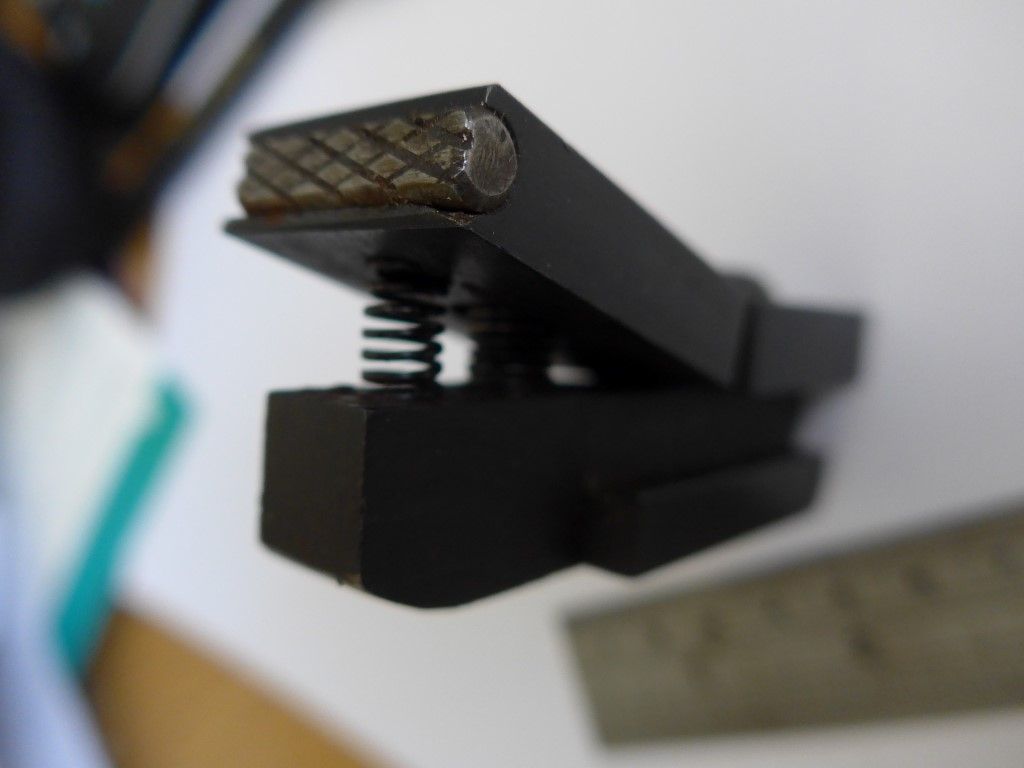

It is for holding thin items to the mill table by gripping the edge rather than the top. Can also be used on thicker stuff where you want to machine the top without clamps getting in the way
Right screw locks it into teh tee slot, left tightens it against teh work and pulls the work downwards as it tightens
