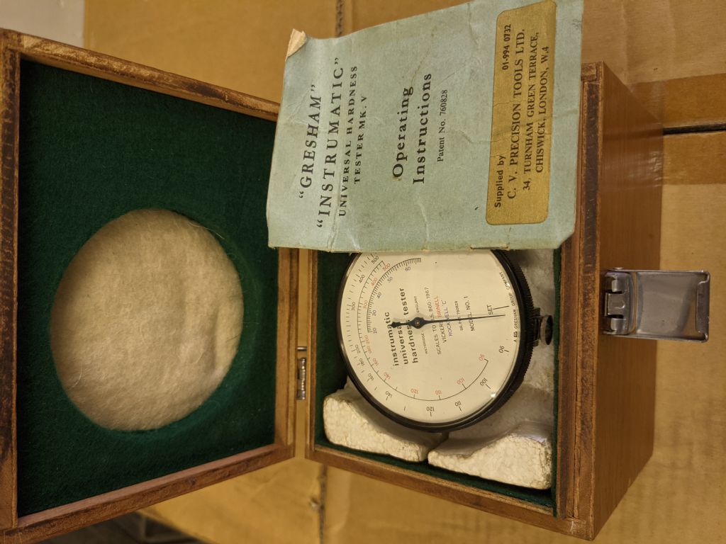

              2. "Gresham Instrumatic" universal hardness tester
              I've spoken to Bowers Group, who now own CV Instruments, however they've said this unit goes way back beyond their records

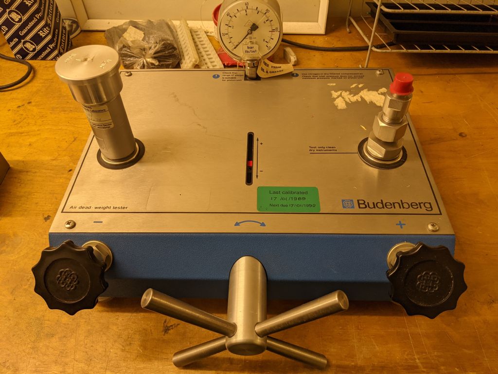

                    4. Budenberg air dead-weight tester.
                    I've emailed Budenberg but had no response thus far. I'm wondering if this is something that may have significantly more value if I have it tested/calibrated. Also not sure if there's any other kit/accessories that might go with it that I should keep an eye out for?

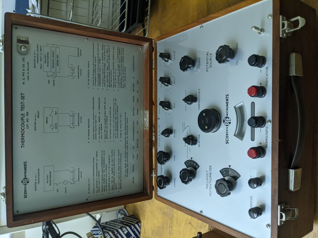

                      5. Scientific Instruments thermocouple test-set.
                      Mod edits: rotated pictures.
                      Edited By SillyOldDuffer on 10/09/2021 10:05:52

                        No. 4 is for probably for calibrating pressure transducers and pressure gauges, using calibrated weights (hence the "dead weight&quot and an accurately made piston/cylinder assembly.

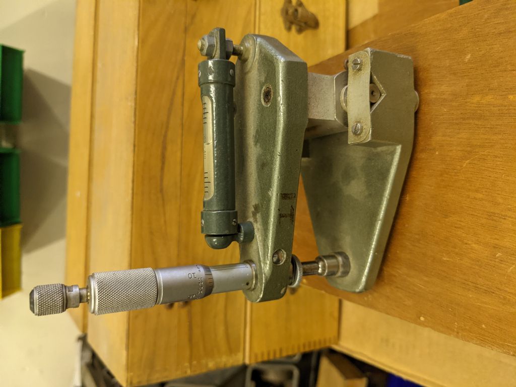

                          The device with a micrometer and sprit level is a clinometer. Set it on a nominally level surface, adjust the micrometer so the level bubble is central, turn through 180° and red-adjust the micrometer until the bubble is again central. Movement distance of the micrometer lets you calculate the tilt of the surface.

                          Thermocouple test set probably came from the same lab as the Avo.

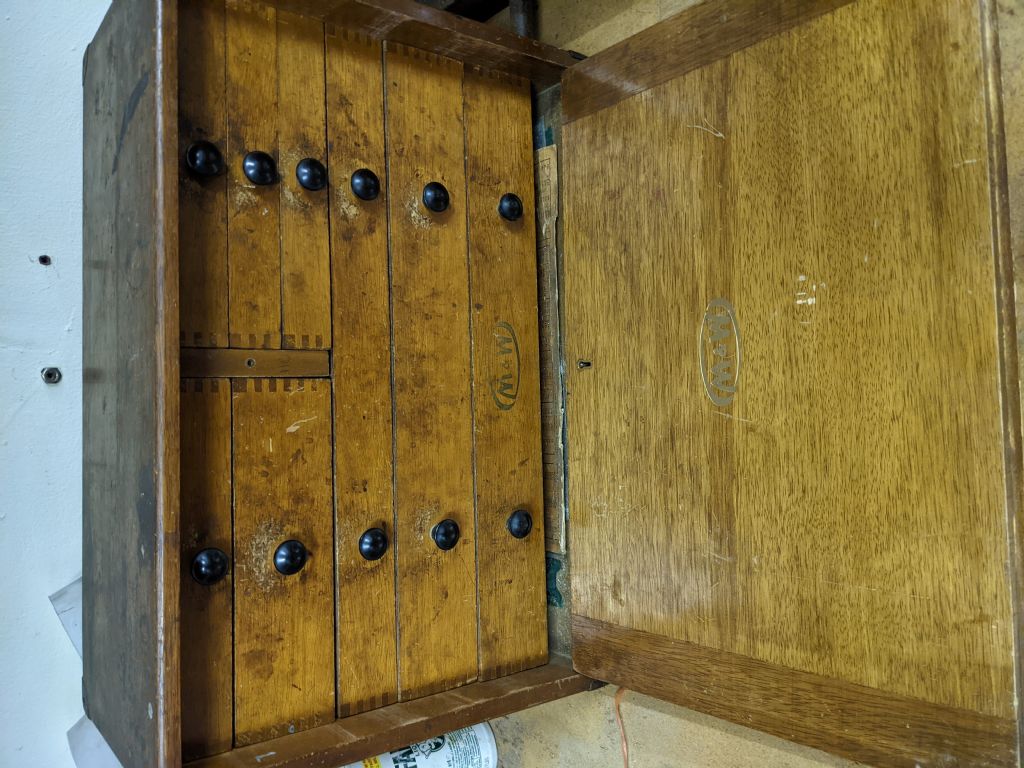

                                Another nice find. Unfortunately I've no key for the lock, but was able to pick it open thanks to my other hobby 😉
                                Sorry admin, I can't figure out how to turn them myself so I'll have to keep you busy 🤷

                                  The Budenberg tester is used to calibrate pressure gauges.
                                  The various pressures are obtained by loading a disc of known specific weight onto the plunger with the gauge to be calibrated fitted to the connection. The pump is then used to increase the pressure, until the weight just "floats"
                                  This allows the gauge reading to be compared with what it should be, and corrected if need be..
                                  This procedure is repeated for each increment of the gauge graduations; probably in 10 psi steps.
                                  It is very good piece of kit, if all the weights are there. There should be at least ten, to cover from 10 psi upto 100 psi.
                                  The electrical device, Pye Scientific Instruments is used to check Thermocouples, to measure their ouput, and again, to calibrate a electronic temperature measuring set up (Thermocouple connected to a sensitive moving coil meter, measuring milliVolts, but probably graduated in degrees C. )
                                  All this stuff, including the Toolmakers cabinet should be quite valuable. Most of it would have come from a Standards Room, or Cakibration Room, and would have been very carefully looked after..

                                                  The Bundenburg dead weight tester should have a matching set of weights. normally thes are paired to the tester. Unfortunatly they often go missing…
                                                  With the weights it has some value.

                                                    The weights for the deadweight tester will be flat discs, if my memory serves me right about 6 – 8 inches diameter, long time since I calibrated any gauges. Dave W

                                                      1985 was the last time I used a dead weight pressure tester.
