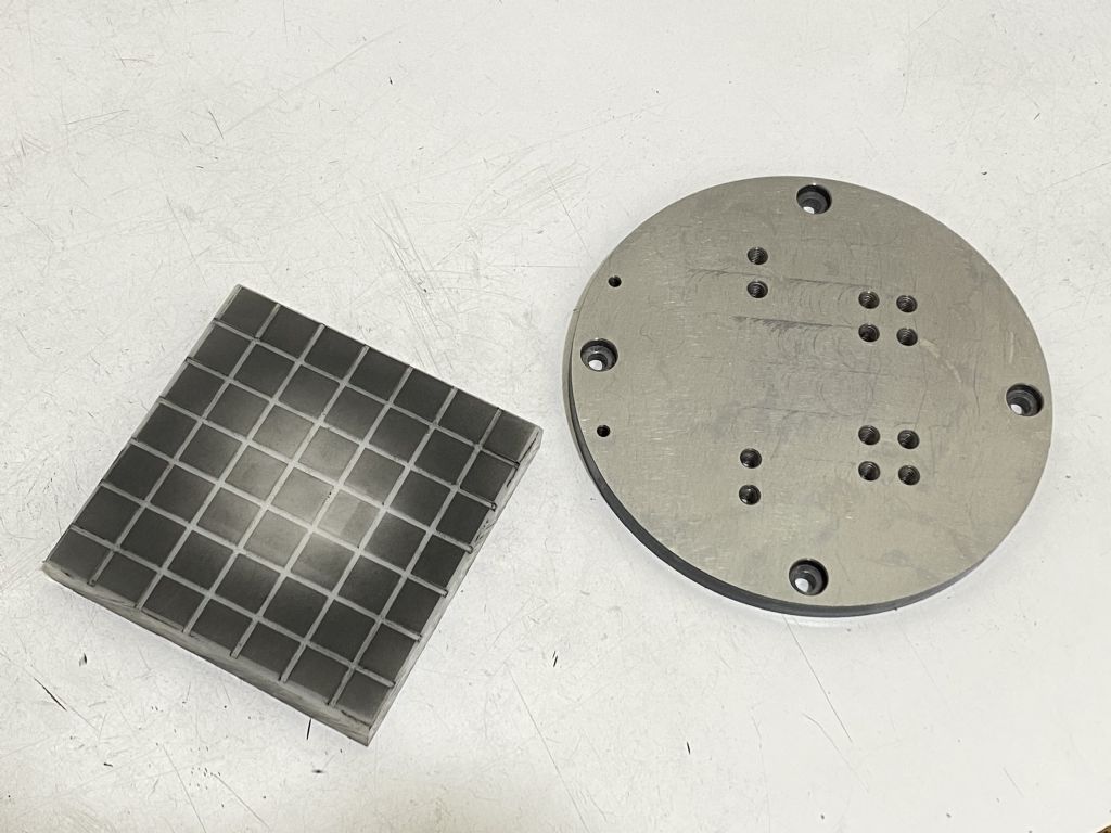

      Today I tried diamond lapping for the first time on the hole plate I have made for my rotary table. The lap is a piece of HDPE plastic and the hole plate is hot-rolled steel. All went well and the lapped surface appears to be quite flat. No dishing or rounding off near the edge.
      However, it appears that the lapped surface is now embedded with diamond particles ( 40 micron according to the vendor ). If I rub a piece of steel against the surface, very fine scratch lines will be formed and I could feel that some abrasion is happening. Some of the diamond particles seems to have transferred to the milling table as well.  How should I go about to clean it up completely ?  Thanks in advance.
      Edited By Y C Lui on 30/04/2022 16:59:55

          You could scrape the face of the part and that would remove all of the diamond compound. Done well it would probably be flatter than your lapping exercise too.

            Scraping would probably be better than this form of lapping, but it does presuppose the possesion of a surface plate.
            For cleaning the diamond particles off, push a sharp razor blade* over the surface at an angle of about 30° positive rake. It'll pop the particles off fairly well. That's the way I clean laps when changing grits.

              If you use diamond abrasive to lap anything soft including steel it will embed itself as you have found. The only way I know of to remove it thoroughly is to clean it in an ultrasonic cleaner as no form of solvent will remove it completely. It will transfer from soft surfaces to others.
              As suggested scraping is a better method to obtain the flat surface you seek but you'll need three items to lap to each other.
              Above comments on removing diamond grit is based on a fair amount of lapping piston and liners – cast iron in En1A steel.

                    I think you might only make things worse by using sandpaper—-the scraping doesn't have to be very precise, you are trying to chisel out embedded hard particles

                          At risk of repeating myself Y C you will not remove diamond abrasive from a soft surface unless by 'machining' it off completely or a thorough clean in an Ultrasonic Cleaner.
                          To have lapped the plate initially then reworking the surface to remove the particles defeats the very purpose of the lapping in the first place
                          Diamond abrasive by it's very nature is usually used for the lapping of hardened (heat treated) steel or carbide. Once embedded into softer material including unhardened steel it will transfer to other soft materials it comes into contact with – as you have found.

                            Mark Rand, I have tried out your method of using cutter blade as well as other methods including rubbing the surface with aluminium hoping that the embedded diamond particles will be transferred to the softer metal. Now after a mix of different operations, it seems that the surface is not abrasive anymore so I dont have to make another hole plate.
                            Tug, thanks for the article, will read it. As diamond is so troublesome ( for me ), will it be better to use SiC powder instead? there is a kind of lapping powder branded “Timesaver.” The manufacturer claimed that the particles will breakdown during use and no embedding will occur. Just wondering if its SiC .

                              Silicon Carbide abrasive is a much better product compared to diamond for lapping non hardened material. It does not break down as such but is easily removed with solvents so you do need a range of grit sizes

                                        Any lapping compound will embed itself – that's how it works! It's the ability to remove it that is the issue.
                                        SIC is easily removed using a solvent cleaning process – I use cellulose thinner in three stages – three jars – the first cleaning stage in first jar etc.
                                        Having only used it on the eighteen diesel engines made so far plus several rebores of commercial engines and of course the liners for the Bentley I think I can safely say it is effective.
                                        By it's very nature a diesel piston and liner is lapped to extremely fine limits of fit – any trace of the compound will soon ruin that fit once run.

                                              The solvent does not dissolve the particles but it removes them by a cleaning process. Unlike diamond SiC is mixed with an oil and the cleaning removes this and the SiC – as said if it doesn't on a piston and liner then the fit is rapidly lost. None of the engines I have made/renovated have exhibited any sign of this so based on personal experience I can only say that it works. Three separate cleans in small containers/jars of thinner will remove all traces of compound and oil.
                                              Jar one – the initial clean to remove the worst – the component wiped clean after removing
                                              Jar two – a repeat will soon show there is still a residue as this comes off. The clean is repeated.
                                              Jar three – there should be no or extremely little residue from this clean – if there is then a fourth can be done but experience has found this is unlikely
                                              Anyone who has made a diesel (compression ignition) model engine will no doubt agree – the fit required of the piston to liner has to be of extremely tight tolerances which would quickly be lost if any residue of compound were left.
                                              The requirement to remove diamond particles by using an ultra sonic cleaner on the other hand comes from another but very well respected source – George Aldrich – an extremely knowledgeable model engine 'guru' whose wisdom I hold in high regard.
