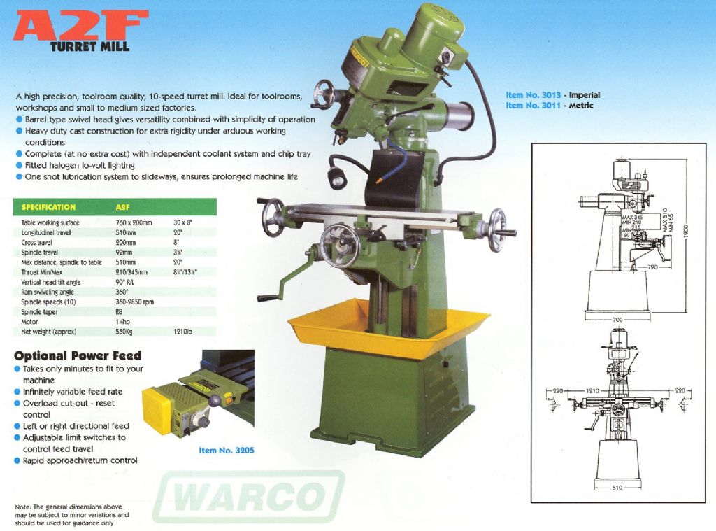

                      Hi Mike, you may wish to find some yellow paint for your tray, below is a picture from one of Warco’s older brochure’s
                      Regards Nick.
