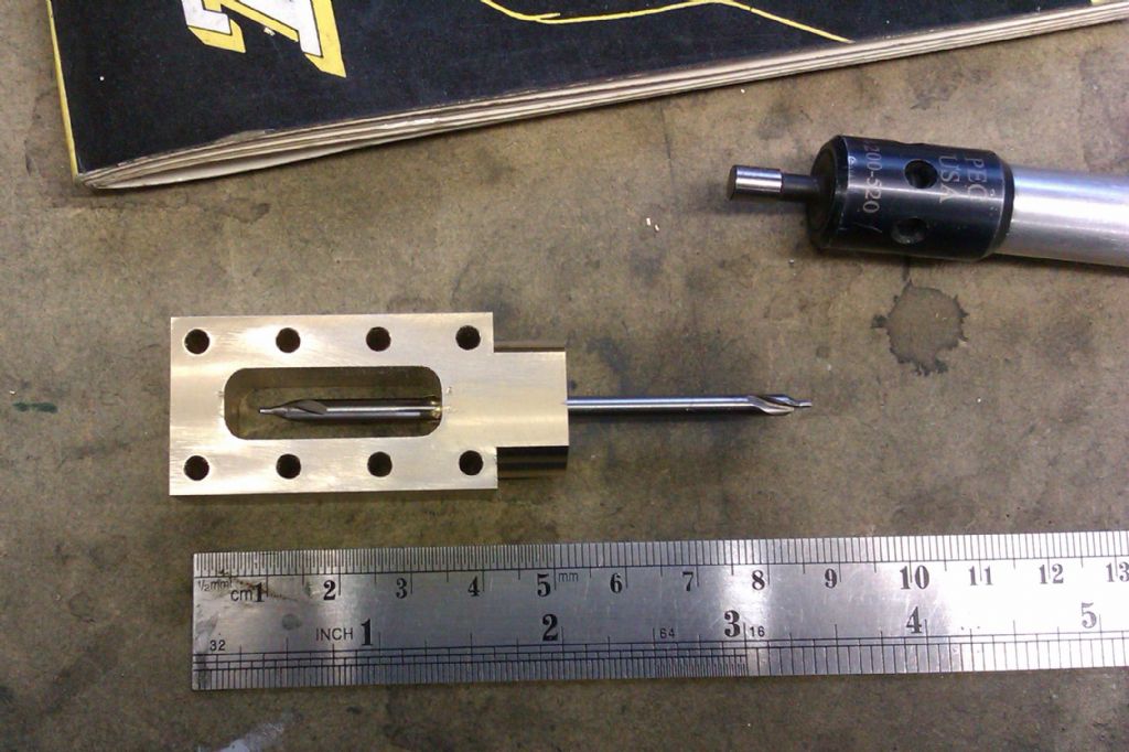

                                                  #77398
                                                    Should still be able to do it on the lathe or even stitch drill and saw/file out the cavity. Once thats done set it up in the 4 jaw and do the drilling in the lathe, drill and ream the 3/32nd hole first then open up the stuffing gland cavity.
                                                    You can now tackle the hole at the other end, as I said a long centre drill is best but you could even grind a point on a bit of 3/32 rod and use that as a long punch to get a start dimple on the far side of the cavity. Then drill the hole, the advantage of having the cavity done is that you don’t have to back the drill off much to clear the flutes as the swarf can drop out into the cavity.
                                                    This is what you really want
                                                    J
                                                    Edited By JasonB on 06/11/2011 20:27:54
                                                    #77403
                                                    Wolfie
                                                      @wolfie
                                                      A picture is worth a thousand words! Brilliant. Whats that metal, and where do I get some?
