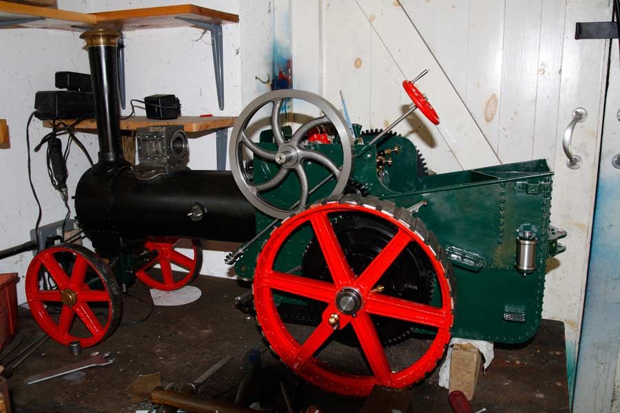

                          This is mine – I have got rather further with all the valve gear and cylinder complete, but it gives an idea of size against the table and door.

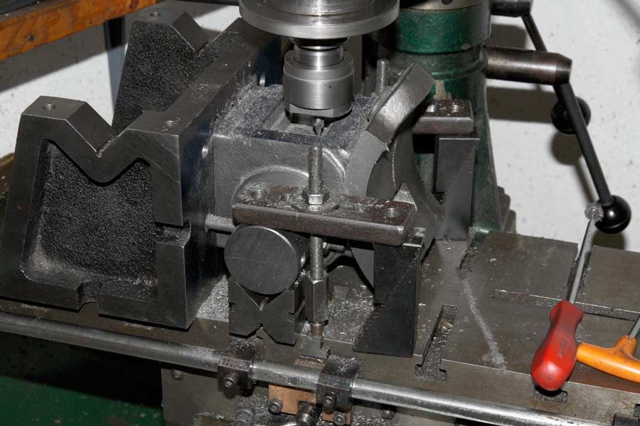

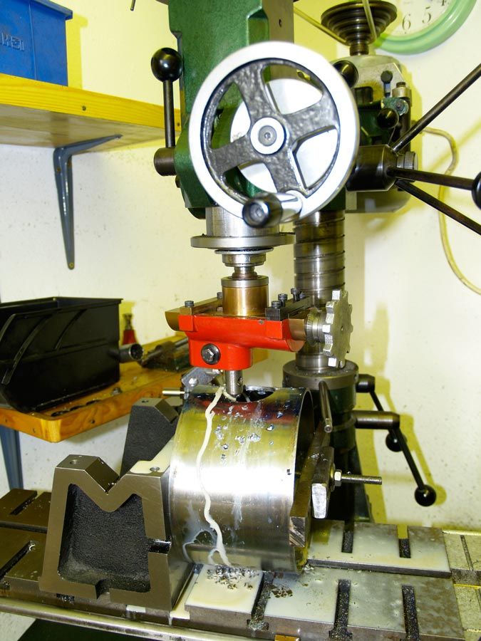

                          This is the same block being rotary milled for insulation – the table is from Ivan Law (MES) – home built, as is the DW mill of course..

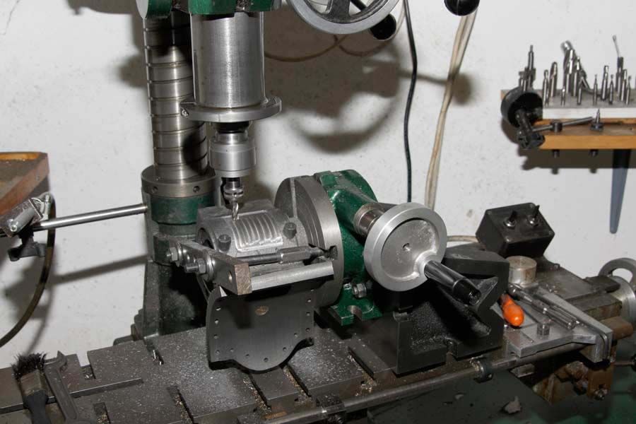

                          This is the second motion gear being cut on a GHT head – that is centre height for a 3 1/2″ lathe. Even on a mill. I had to hang it off the back of the table, use the head for indexing and a clamp to put the thrust into the table.

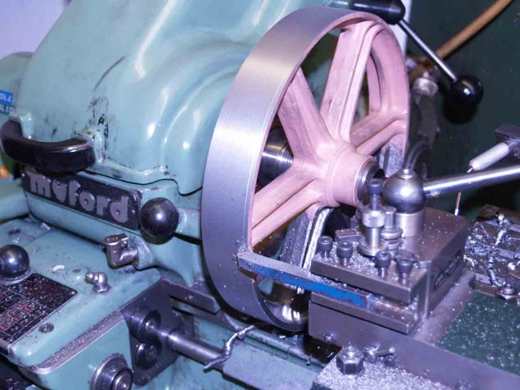

                          Turning the front wheels in the Myford, before I got the Chinaman. They just fit for diameter – but the overhang is such that you cannot turn it round to face the other side for the hub caps – though you could do it in a mill. Hadn’t got an indexable TCT tipped tool with enough length either. (Stil don’t)
