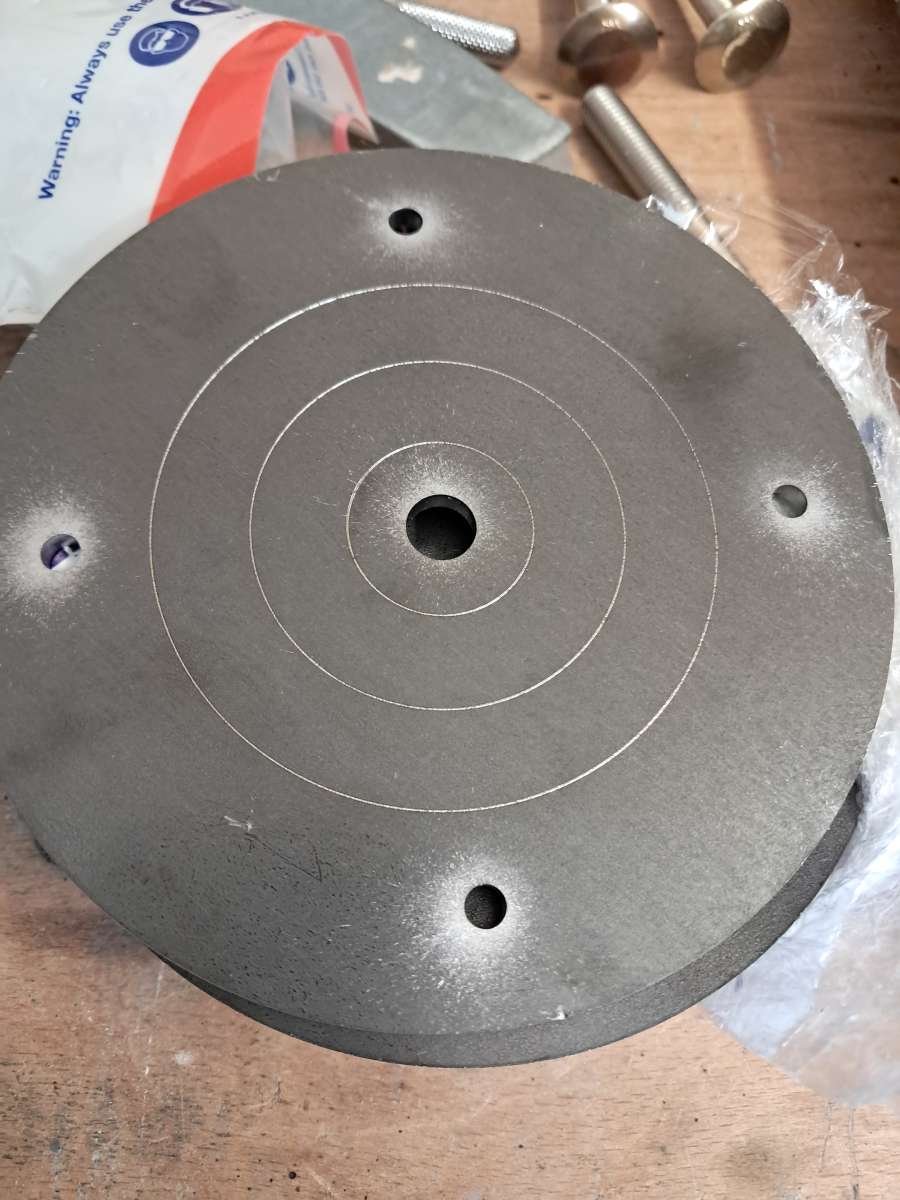

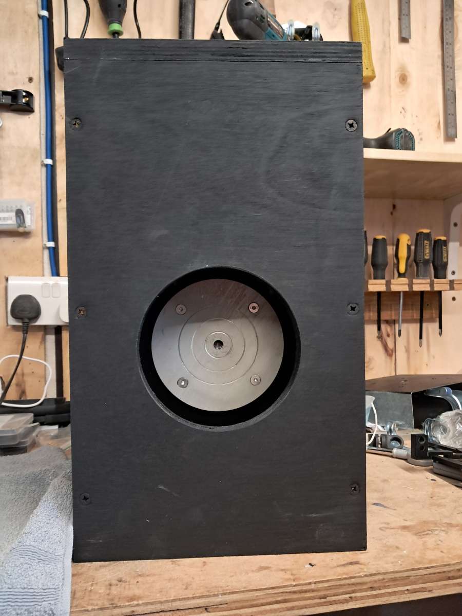

                    20250327_11040220250403_183613

                      The discs I’m wanting to groove are 127mm in diameter and 4mm thick. I just want to cut 3 grooves, all 1mm wide and 0.5mm deep at 1″, 2″ and 3″ centres to create the scoring zone. I originally used stainless steel and used HSS tools (provided by JohnF) but the shooters want Hardox, so I’ve now sourced carbide cutters but they use a 12mm shank holder, so I need to amend the tool post holder too.
